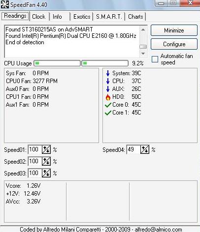

You can check your system temp through your bios or from windows itself, for windows try speedfan.
Download link

Thank you for the link. I am posting that snapshot here, you can take the reference. First image is taken after 40 min from system start. Second image taken after 40 min from the first image.
Try to run the computer on full load i.e. 100% cpu. Then see the difference in the temp. Any application like a video converter soft or any other can be used to achieve this. if the temp rises above 60 deg for any component then exit the app immediately. Run it for 10 to 15 min at least. Post the images of the temp difference.
I don’t think I can do this. I don’t know what I am gonna get to know from this. Even when I am using normally, my HDD temp shoots up to 50 C. I guess, I never run my system with full load. The max would be around 60% load.
