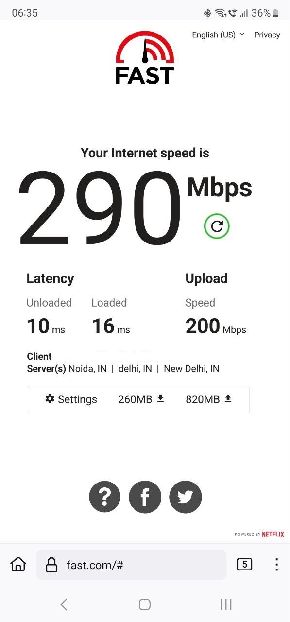

Speed is not capped i go above 300Mbps when connected to Wired Webwork

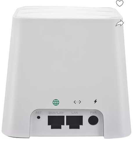

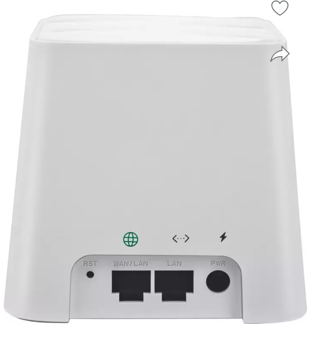

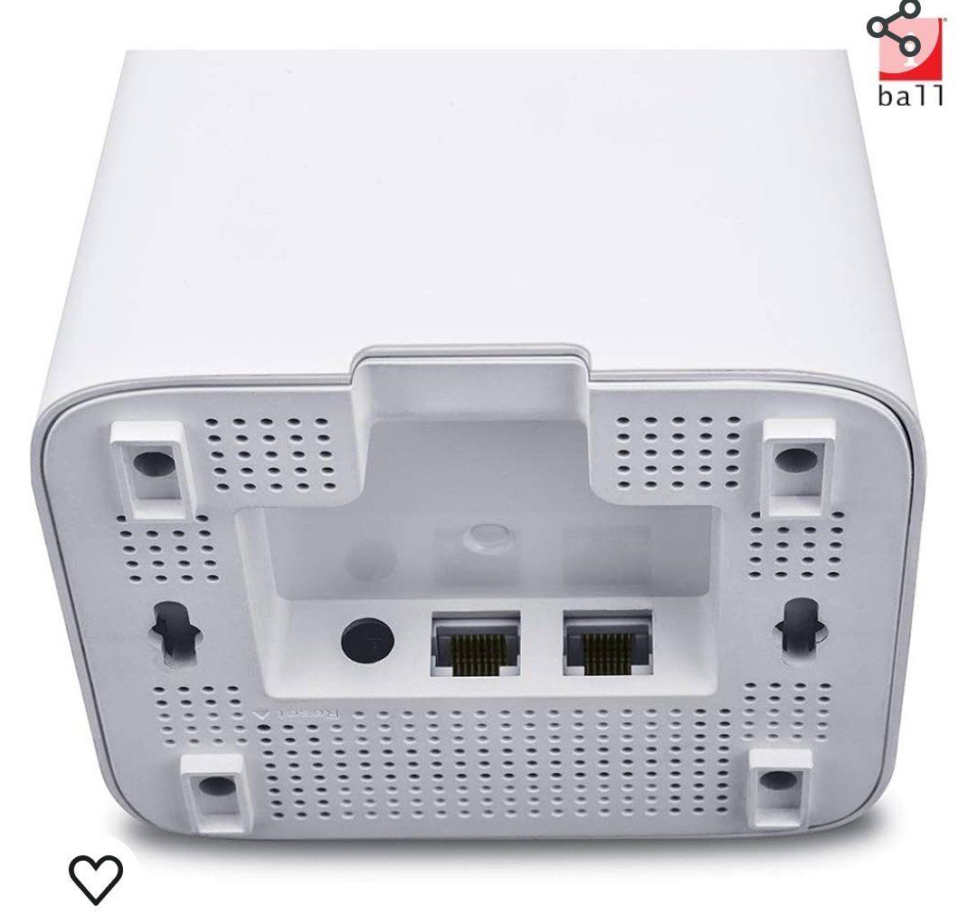

One of the this model is limited to 100Mbps LAN port. I’m not sure whether your model is that one. If i remember correctly both 100Mbps and 1Gbps model has 1200M model number. But there is another sub model number where 100mbps model ends with EM and 1Gbps model is ending with GM.
100mbps is this one,
(Refurbished) iBall WebWork 1200M Smart AC Whole Home Wi-Fi Mesh Router iB-WRD12EM (White)
https://amzn.in/d/10c8sav
Correct

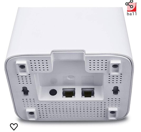

Gigabit LAN is bigger in size, with hidden LAN ports where’s 100Mbps has behind the router
I have both, but Gigabit LAN port is connected to ONT
that explains the 100mbps cap .. im using the bottom one right now .. for just testing the tech this was a great deal for me and im very impressed with it .. maybe ill upgrade to deco series soon

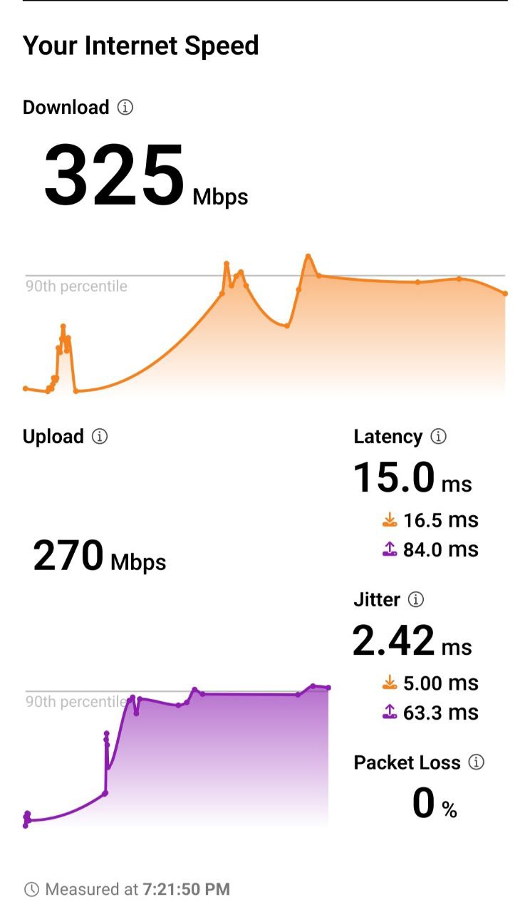

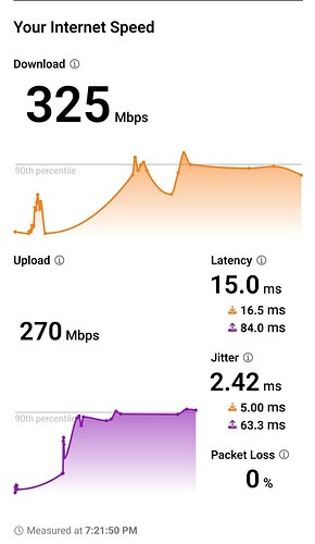

i managed to grab 2 iball gigabit lan webwork routers .. now speed has jumped to 150mbps everywhere in home and full 250mbps airtel speed near gateway router .. very impressed by coverage and speed
now i have 2 sets of 1 gigabit lan webwork and 2 ethernet lan webworks .. overall an incredible deal compared to tenda mw3 price now
