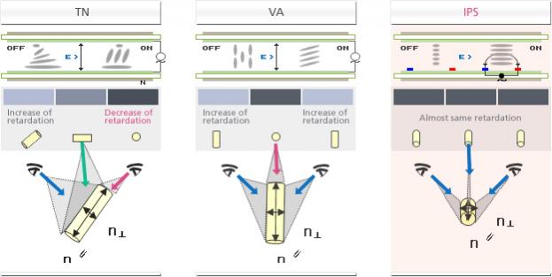

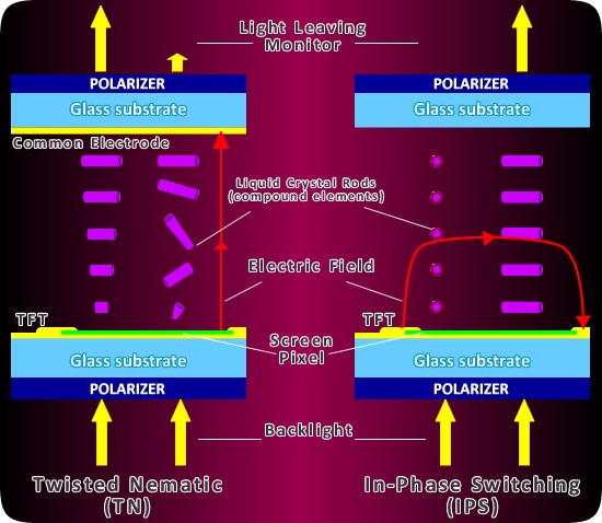

The LCD works as a filter layer filtering which rays of light reach us. The TN panels do this by modulating the angles between the molecules of the crystal layers. this is amply elucidated by the below image.
[attachment=9568:16327.attach]
The IPS however uses a different approach. Instead of the gradual untwisting noticed above, the molecules of the liquid layer in the IPS panels completely rotate 90 degrees to allow light to pass through. So this results in all the molecules of the liquid crystal layer being in a single direction, all in a plane parallel to the screen. In this sense it is like a light switch either totally on or totally off. This results in the image being viewed from any angle without a problem unlike a TN panel wherein at certain angles only partial rays can be seen. This is illustrated by the image below.
[attachment=9569:16328.attach]

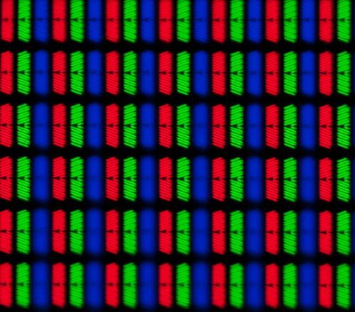

  1. H-IPS: The Horizontal IPS was developed by rearranging pixels in a S-IPS to have more density of pixels for a better viewing experience and a reduced backlight bleed. Its varieties include
[attachment=9570:16329.attach]
S-IPS pixel structure
[attachment=9571:16330.attach]
H-IPS pixel structure

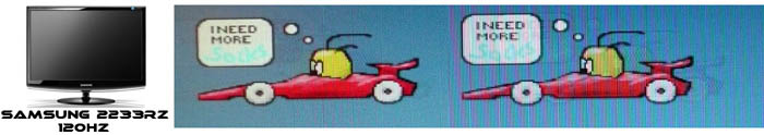

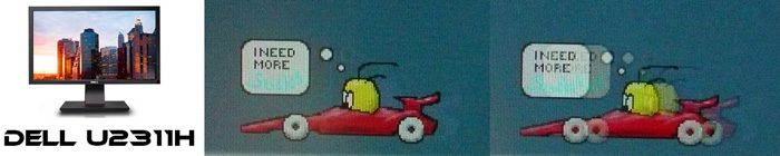

  1. Response times are slower than TN panels. This may cause image lag or motion blur sometimes.. Nowadays this has been improved by Response Time compensation mechanisms inbuilt in the IPS developed by LG
