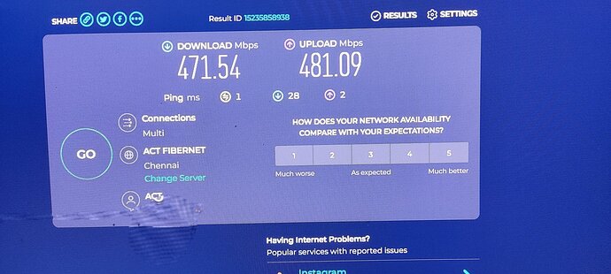

Upload speed is good thro ethernet. 400Mbps connection.
