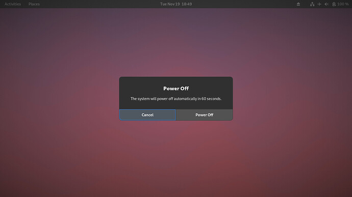

I wanted a pop-up prior to the system shutting down. This is normally done when you use Gnome GUI to power off.
What happens in the backend is that “gnome-session-quit --power-off” is called and the GUI throws up a prompt asking you whether you want to shutdown and if no user response is received for 60 seconds, the device shuts down automatically.

However, when being used as a HTPC, the system shutting down right when you’re in the climax of a movie is not very nice. Hence, this script puts out a GUI confirmation dialog that the user can then interact with and cancel shutdown.
The best part is that this works, even when the display is not switched on. I believe the HDMI cable might need to be connected, but other than that, I do not think anything else is required.
