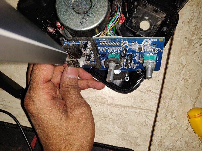

Hey @@puneet.darji
I dissembled the right satellite speaker myself just to check and components. I believe I can solder the new subwoofer knob if I can get one. Can you please help me with this ? What should I tell the electronics repair guy to get this exact part?
Should I carry the whole speaker set?
I’m not sure what is the name of the knob. I suppose there is some alpha numeric number on knob starting with R (not sure though). Either you can ask for the part with this number or show it to the repair guy and ask for exact part. Carry the speaker set only if you want to test it.

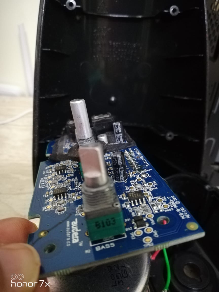

So the part number is b103 on my knob. I took pictures of the circuit board and showed it to a dozens, I repeat, dozens of shop keepers in my local radio market (in Jaipur). And no one had the part. They were not even taking interest in looking at the picture of the circuit I was showing to them.
Also I can’t find any online store which sells audio components. Please let me know if anyone is aware of such store.
Try with generic one. Not sure if it will work/fit exactly as original. Also can you post the picture of the knob here, I will try to check here in Mumbai.
Yesterday I approached a local audio repair guy. He tested the bass potentiometer by directing it. He concluded that there’s no issue with bass knob at all since if it was faulty then bypassing it should have made subwoofer work on full bass. But that didn’t happen. Can you tell me if you’ve also tried bypassing when yours was dead?
He then said that he’ll have to send it to someone to get repaired and most probably the issue with the IC in the subwoofer. He also quoted max 2000 as repair charges.

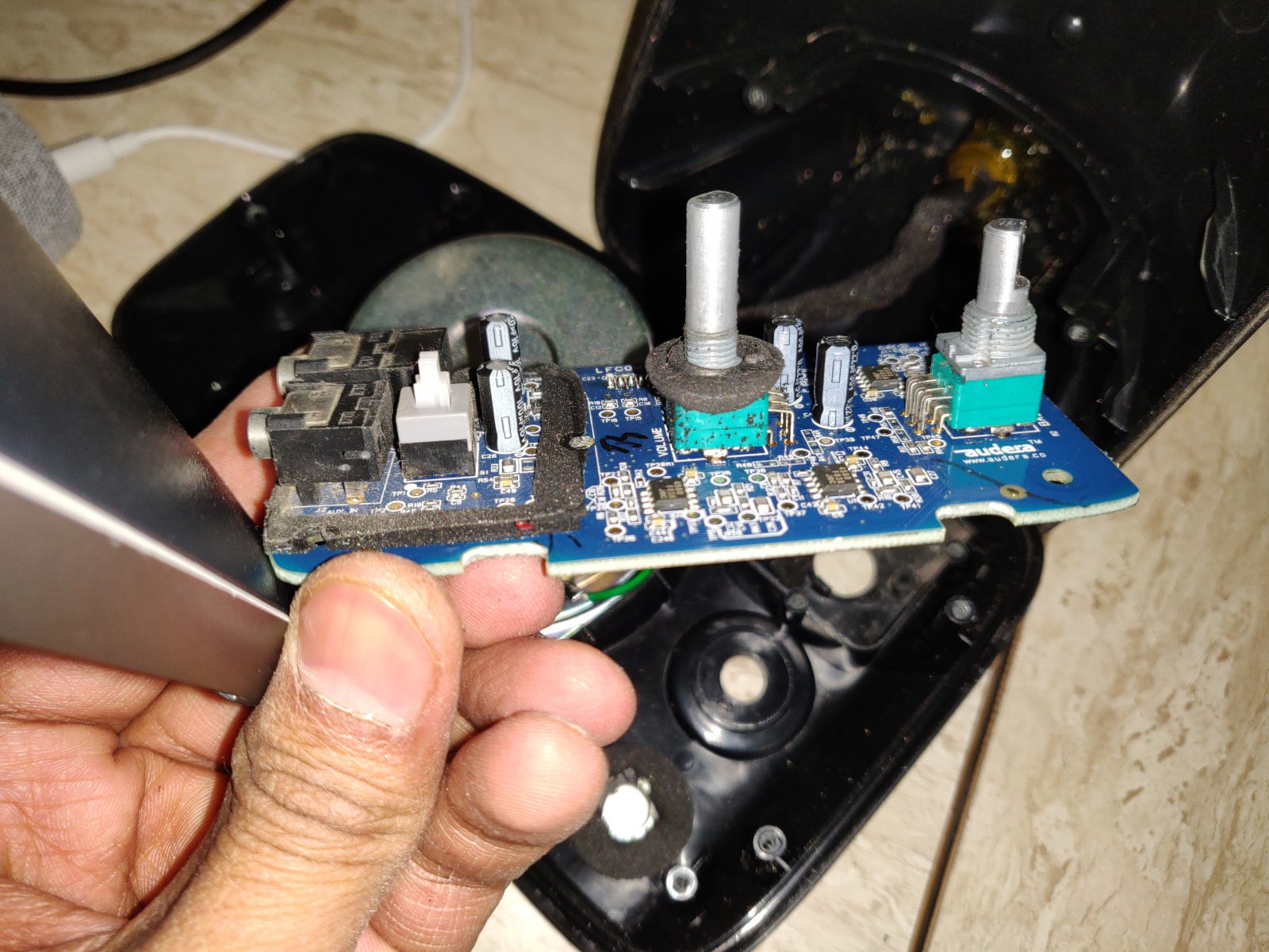

Below are the pictures since you’ve asked. It’s a 6 pin potentiometer.
When the potentiometer fully turn up or down, did the speaker work earlier. Also, I assume there is no off switch when fully turned down which some know has ? If the answer is yes, then what he said was right
Potentiometer ‐ basically increase or decrease the resistance, so frequency can be lowered or increased as required for the base
Yes it worked earlier when fully turning up and down. There’s no off switch when fully turned down.
In my case he attached some other knob temporary to check and with it, subwoofer starting working though not upto the mark. Hence the repair guy concluded that it was knob which is the issue. So swapped out with new and it started working.
Update: so I gave it to a local guy for repair. He then sent it to another repair guy. They fixed it in a day. Total repair cost was 1900/-.
I asked for details like what was the issue, they didn’t tell me stating that it was something they don’t share. Just told me that they repaired something in IC.
