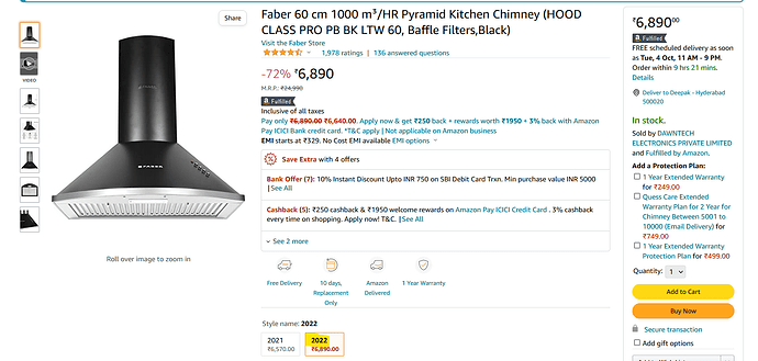

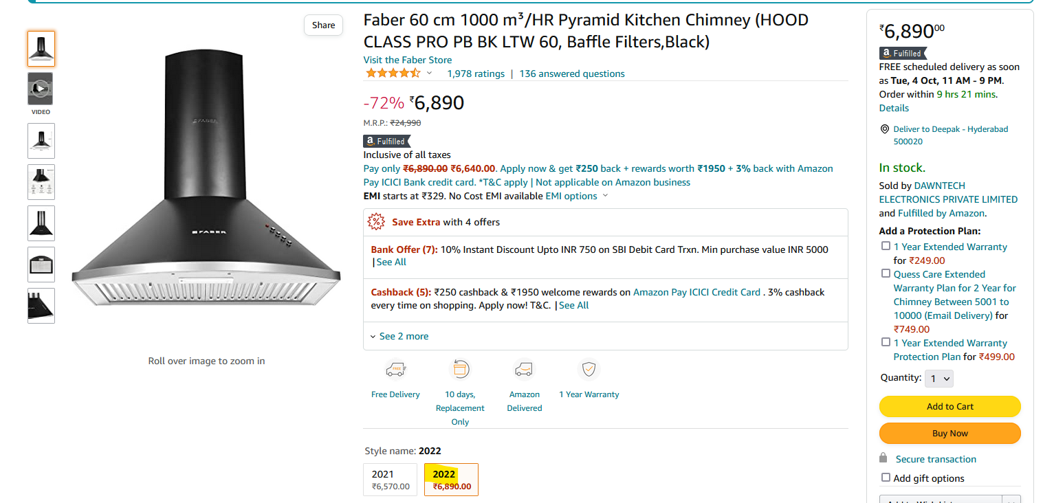

I purchased Faber 60cm(good enough for 4 stoves) chimney last year after doing a bit of research, at the time it seemed best value for money and probably still is, Chimney is working fine and its worth it regardless of downsides, but the company uses many scummy tactics to extract more money and fake reviews than what is mentioned on amazon.
I wrote this last year
I bought this before the sale began for Rs.6990
https://www.amazon.in/gp/product/B09YMGGTDB/
I looked for -
high suction power - 1000 and more will be fine
baffle filters - these can be self cleaned and last longer. carbon filters are costly and has to be replaced. i didn’t prefer filter-less, don’t remember now why, but it has its downsides I guess
I prefer proper switches for speed settings. now-a-days, you are getting touch, motion-sensing hand wave ones, what not :banghead:
There are 2 size options 60cm(2ft) and 90cm(3ft), it depends on the place you install the chimney.
Installation has to be done by service center, I think warranty issues might crop up if not done by them, I donno. I got it done by service center only.
Chimney packaging doesn’t come with exhaust pipe, you can buy it from the market. They charged 1400 from me, I got one from local market for 700. (I needed 2)
Pipes have sizes, it depends on the exhaust hole you have in your kitchen
I guess Faber, Elica, Glen are standard ones, happy hunting !!!
