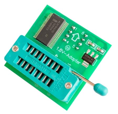

Looking for CH341A 1.8V Adapter
(Already have CH341A, just looking for low voltage adapter)
Thanks

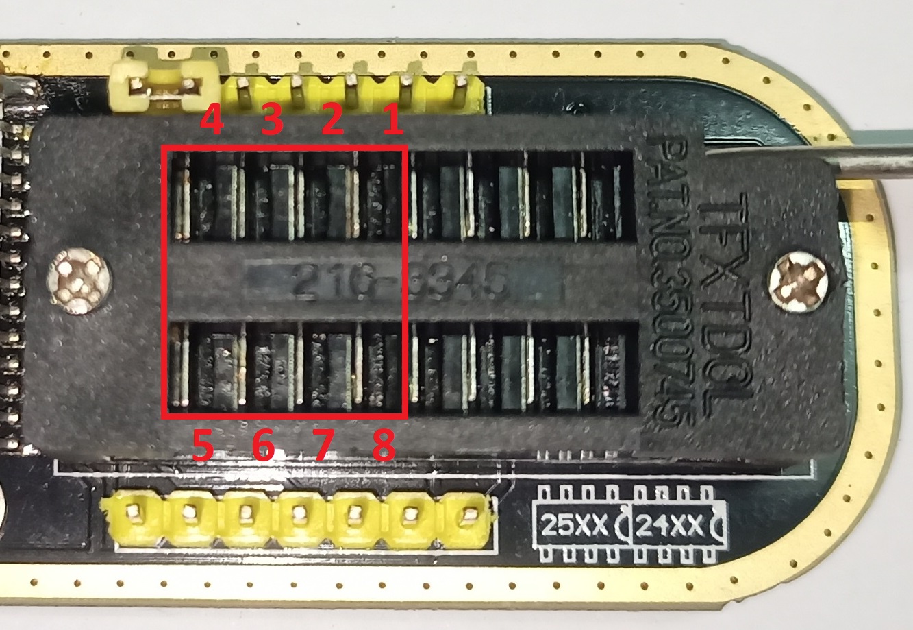

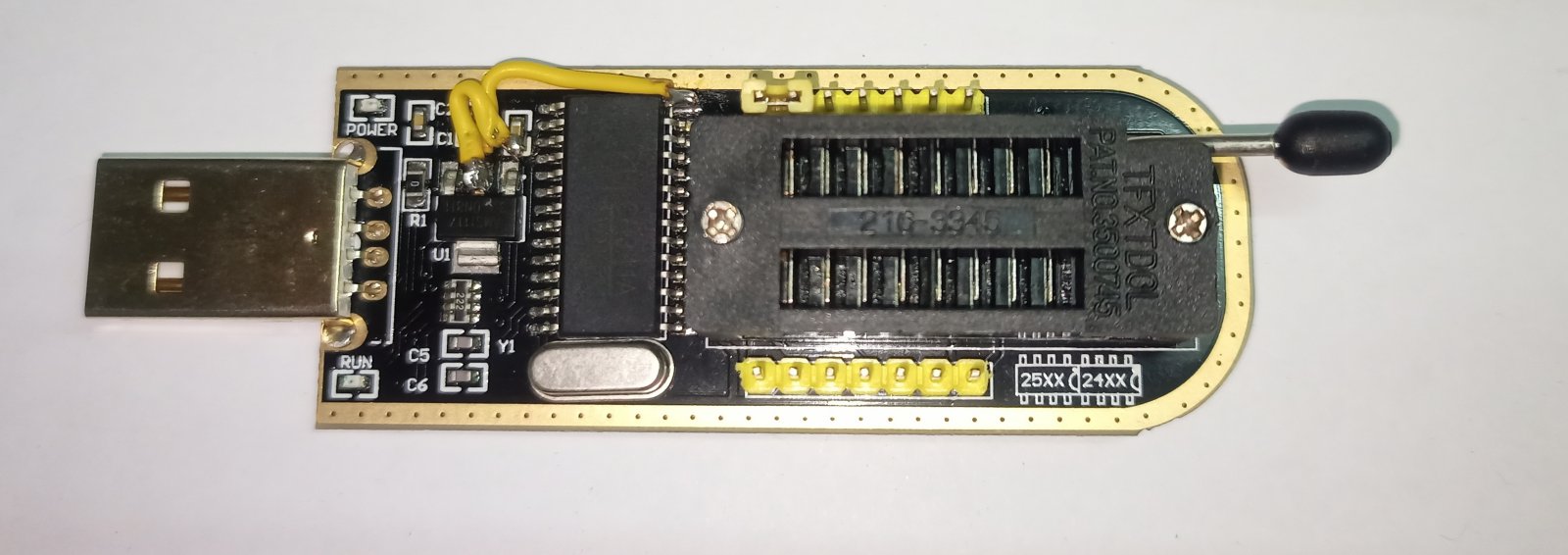

The trick was first convert the cheap CH341A to complete 3.3V (so its safe to use) like this thread 3.3V CH341a Signal Output Modification [Chuck Nemeth]

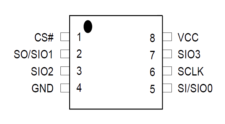

Then install the MX25U12873F on ch341a in 25XX slot, and it should be connected in a way that the PIN 8 (VCC pin) should be disconnected from CH341A, I just used some tape on PIN 8 to avoid connection.
I also checked via multi meter to make sure there was no connection between PIN 8 and CH341A.

Just installing the 1.8V chip on ch341a in 25XX slot and **avoiding **the connection between the PIN 8 of chip and respective connection point on ch341a does the job.
For programming the chip I used CH341A v1.31(1.4) (CH341AFree) version and my cheap ch341a was modified for 3.3V on all points.
Awesome, I have a few boards I need to try this with. Thanks a lot for the update. Adamant IT on youtube rehosted AsProgrammer, I’ll be trying that out some day:
I did the exact same mod to my CH341A but followed this post 3.3V CH341a Signal Output Modification [Chuck Nemeth]

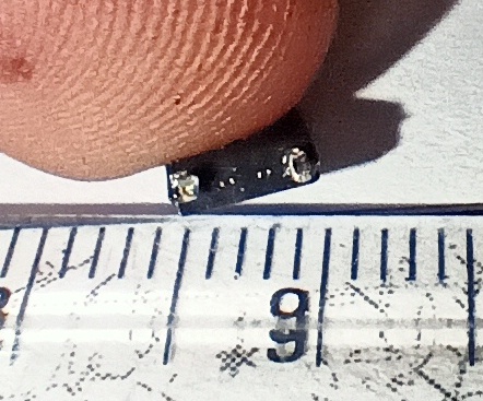

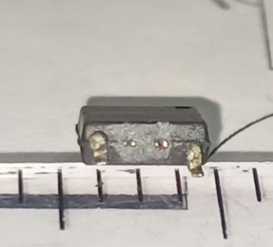

So I decided to scrape off some black material to reach the broken pins in order to make some soldering connection to connect very thin wires.

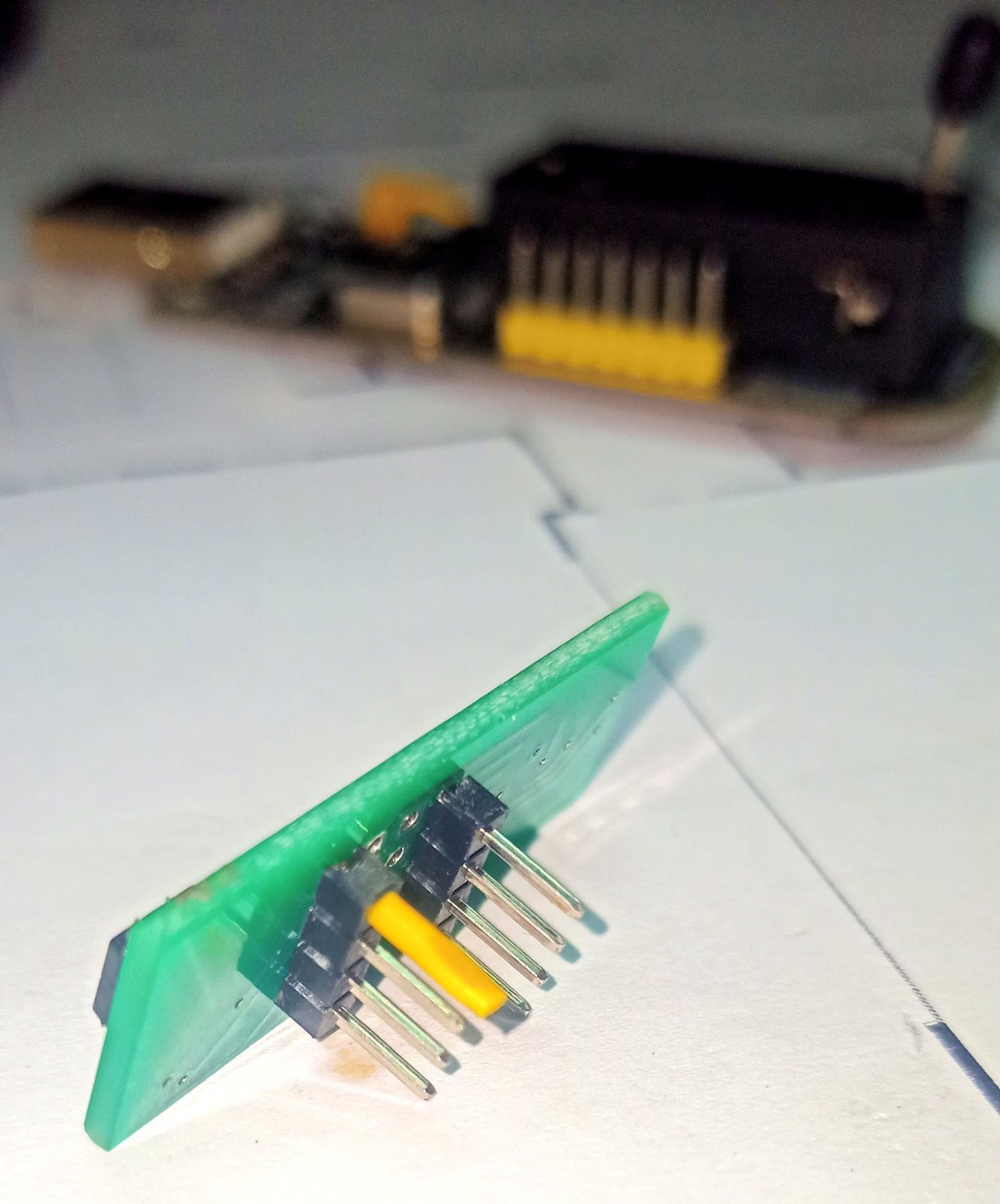

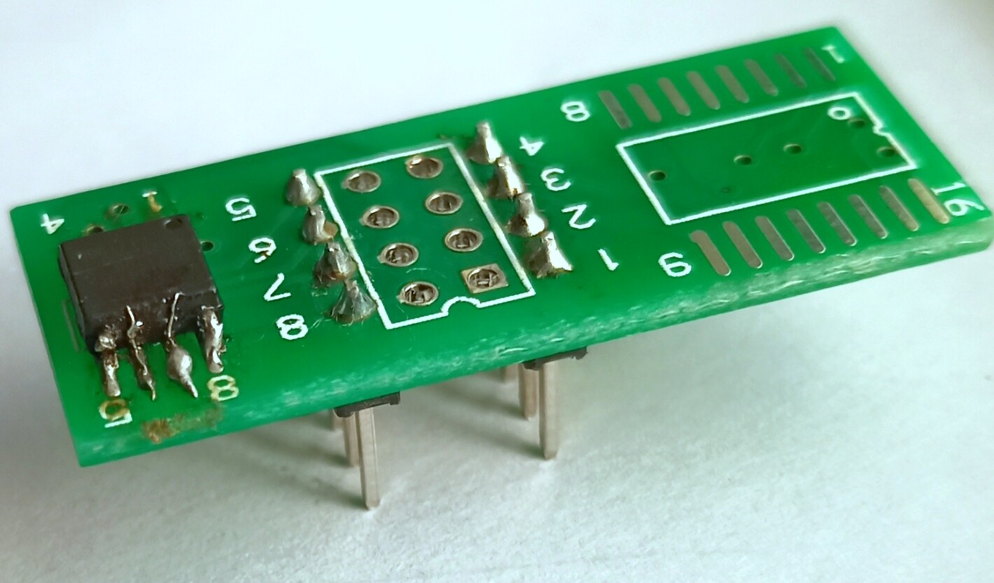

Then soldered the BIOS chip on the SOP8 PCB.
To avoid the the connection of PIN 8 of chip first I tried to tape the leg 8 but it didn’t worked so I covered it with the wire sleeve.
Then mounted this PCB in CH341A in 25XX space.
Finally used CH341A v1.31(1.4) (CH341AFree) to program it.
