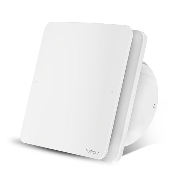

Hi TE friends, can you please recommend me an exhaust fan from Amazon for installing in bathrooms?
I’ve been considering this [covered exhaust from Polycab](’
Polycab Freshly Prime 150mm Energy Efficient Exhaust fan for Kitchen, Bathroom | Noiseless ventilation, Sleek Design Easy to Clean | High Speed, Powerful Motor, 100% Copper, 3 Yrs Warranty【White】 : Amazon.in: Home & Kitchen
), it looks great, but concerned if it will suck air as well as something without cover. Does anyone have experience with this kind of exhaust? Or please recommend another one. Many thanks.

In my opinion it will make more noise due to that “cover”.
The cover obstructs the flow definitely and most probably will cause extra resistance to be overcome by the fan, creating more noise.
What is the problem with visible blades?
