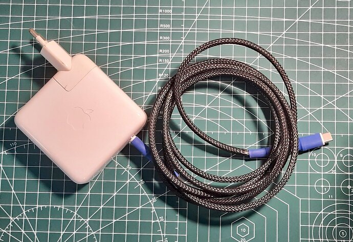

So I decided to reinforce the official cable by adding strength near the plug where it bends, and covering it with a braided sleeve.
What you need:
Steps:
  1. Compress the expandable sleeving to increase its diameter, and slip it over your cable.
  2. Use electrical tape to reinforce the cable where it usually bends.
  3. Slip on heat shrink tubing at both ends, and use some heat from a hot air gun or a lighter to shrink it and have it grip the connector and the sleeving.
That’s it, you have just made your own reinforced sleeved cable. Because sleeving is available in a variety of diameters, you can do this with almost any cable to extend its life.

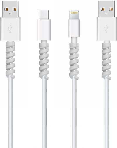

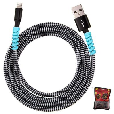

What do you make of these?
https://www.amazon.in/STRIFF-Flexible-Silicone-Protector-Computers/dp/B09Z6WH2N1
or this
https://www.amazon.in/dp/B08CKCBD13/?th=1
I think those silicone connectors are a fail if they are less stiff than the cable connection themselves. Only cosmetic and offer no protection whatsoever.
If they are made too stiff, that would just shift the point of bending and failure to where the protector ends. Protectors just need to add a slight stiffness to encourage a gentle bend instead of a sharp bend.
So these do work IMO.
