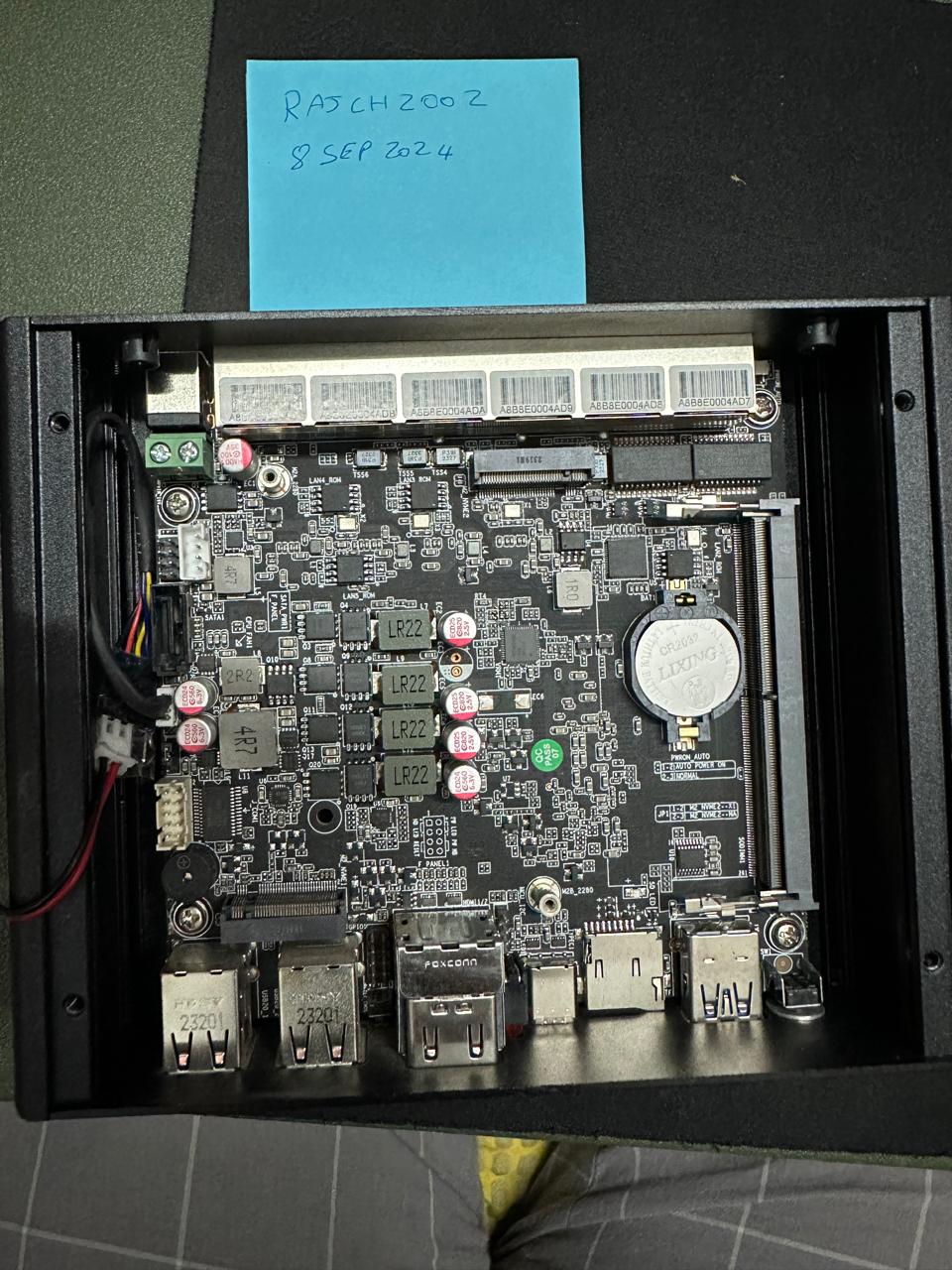

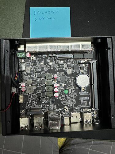

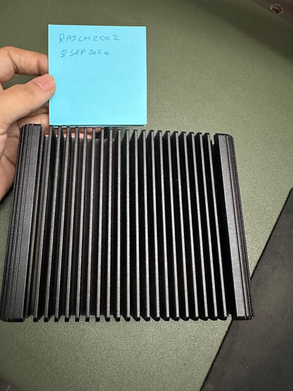

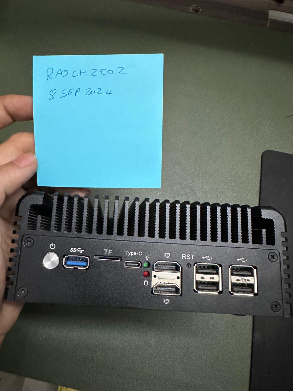

mini pc/proxmox host from CWWK. It has Intel N305 which is almost double the performance from N100, has 6x i226-v NICs. I was using this with proxmox with opnsense, openmediavault, plex (does AV1 transcoding), wireguard. with space to add even more vm’s. This comes with 8gb ram and no SSD. It has 2 NVME connections, 1 sata, will include the sata power/data cable. Bios updated to latest one. [manufacturers website](’
https://cwwk.net/products/6-lan-firewall-appliance-2-5g-router-12th-gen-intel-i3-n305-n100-ddr5-2-nvme-2-sata3-0-fanless-mini-pc-esxi-proxmox-host?variant=44695402709224

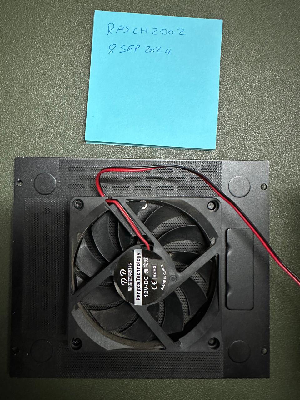

). Connected a 7010 mm fan to keep the ssd’s cool.

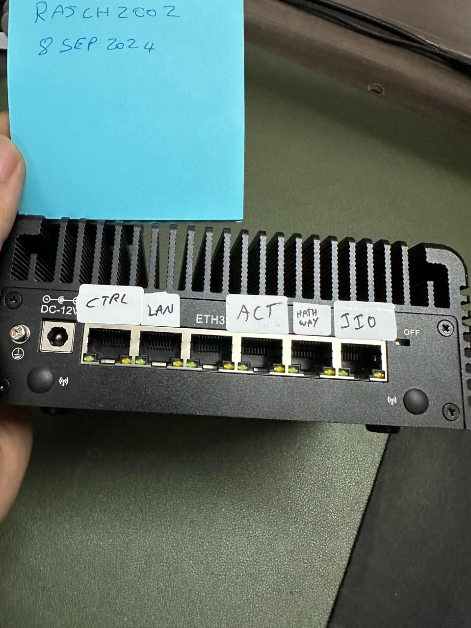

A question related to the device but not to its sale. I see you have 3 LAN ports labeled to what I am assuming corresponding ISPs. Were you using all 3 or just 2 together and if so then how?
I’m currently using all 3 (Jio-500mbps, ACT-300mbps, Hathway-100mbps) All three in load balance so I get around 1.1gbps to 1.2gbps download speed. And this also provides the fail over when one of the line goes offline. You don’t need the above if you want to load balance, you can achieve the same with normal load balancing routers or even normal routers with openwrt!
