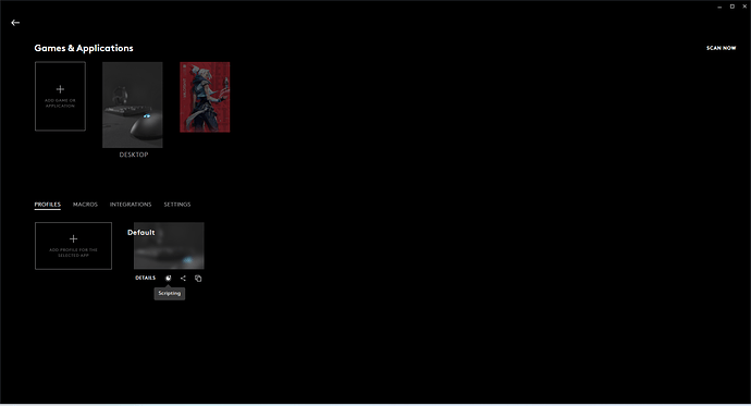

1. Open Logitech G Hub app. Goto Manage profile in the dropdown as in the image.
2. In profiles, select the Scripting icon.

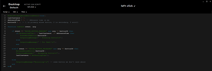

3. Rename the script to anything as required (I named it left click). Paste the code as in the image. Save and Run under Script dropdown. 90% job done.
Script:

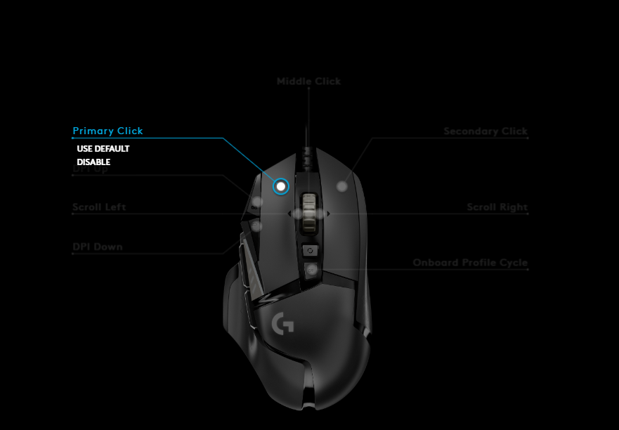

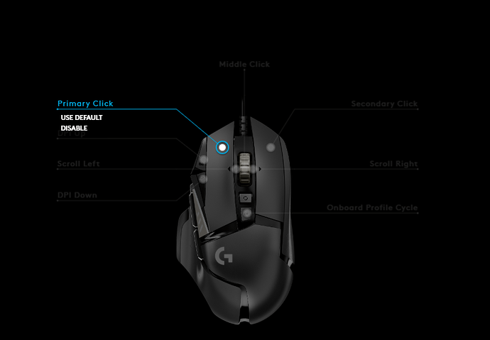

After all this is done, disable your left click like mine was disabled in the first image.
(IF THIS IS NOT DONE THEN EVERY LEFT CLICK WILL REGISTER AS TWO CLICKS. ONE FROM CODE AND ONE DEFAULT)

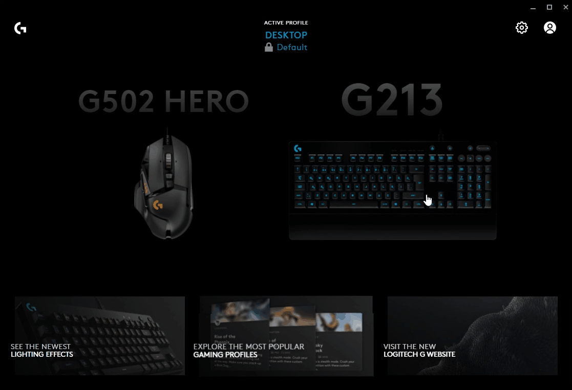

Never change the active LUA script (image 3). Since the left click is disabled, once the active script is changed, your left click stops working.
Either the script is to be made active again (image 3) or Default is to be selected for the left click to work again.

Press windows Key. search for ‘Mouse settings’. Change the primary mouse button to Right by using down arrow.
Now either select the script back or enable the left key. Reselect the primary mouse button to Left from mouse settings.

Not facing any issue. Even the drag and drop works. The debounceTime was 50 in the initial code. I changed it to 5 ms. since I felt 50 ms is too much time.
