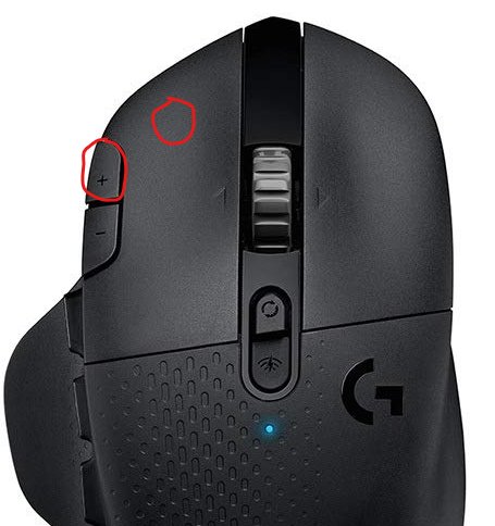

My Logitech G604 has developed double clicking in the left click, intermittently on right click and on the plus button (See reference picture below)
