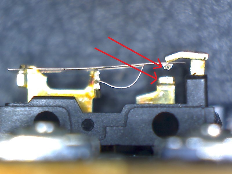

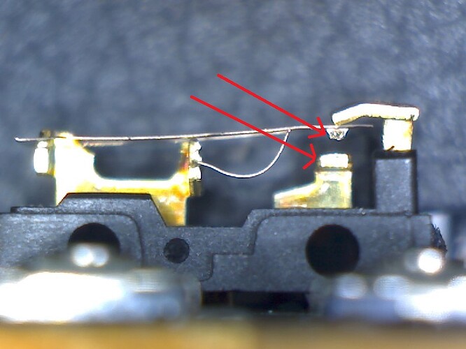

I would also like to share my thoughts and experience repairing the double/intermittent click issues. I have repaired about 10-12 mouse and a couple of mechanical keyboard switches without ever replacing them. What actually happens inside the switches is, the contacts inside wears out due to clicks and a layer of carbon is formed which prevents a good contacts between the two points of the switches. All you need is pry open the switch with help of tweezers and clean the metal contacts with toothbrush and some isopropyl alcohol. Below is a picture of a mouse switch opened and indicated are the points which only needs to be cleaned.

I agree. I have also repaired my mice a couple of times this way. It’s easier to clean contacts than replacing.
