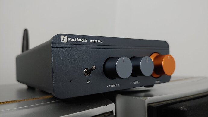

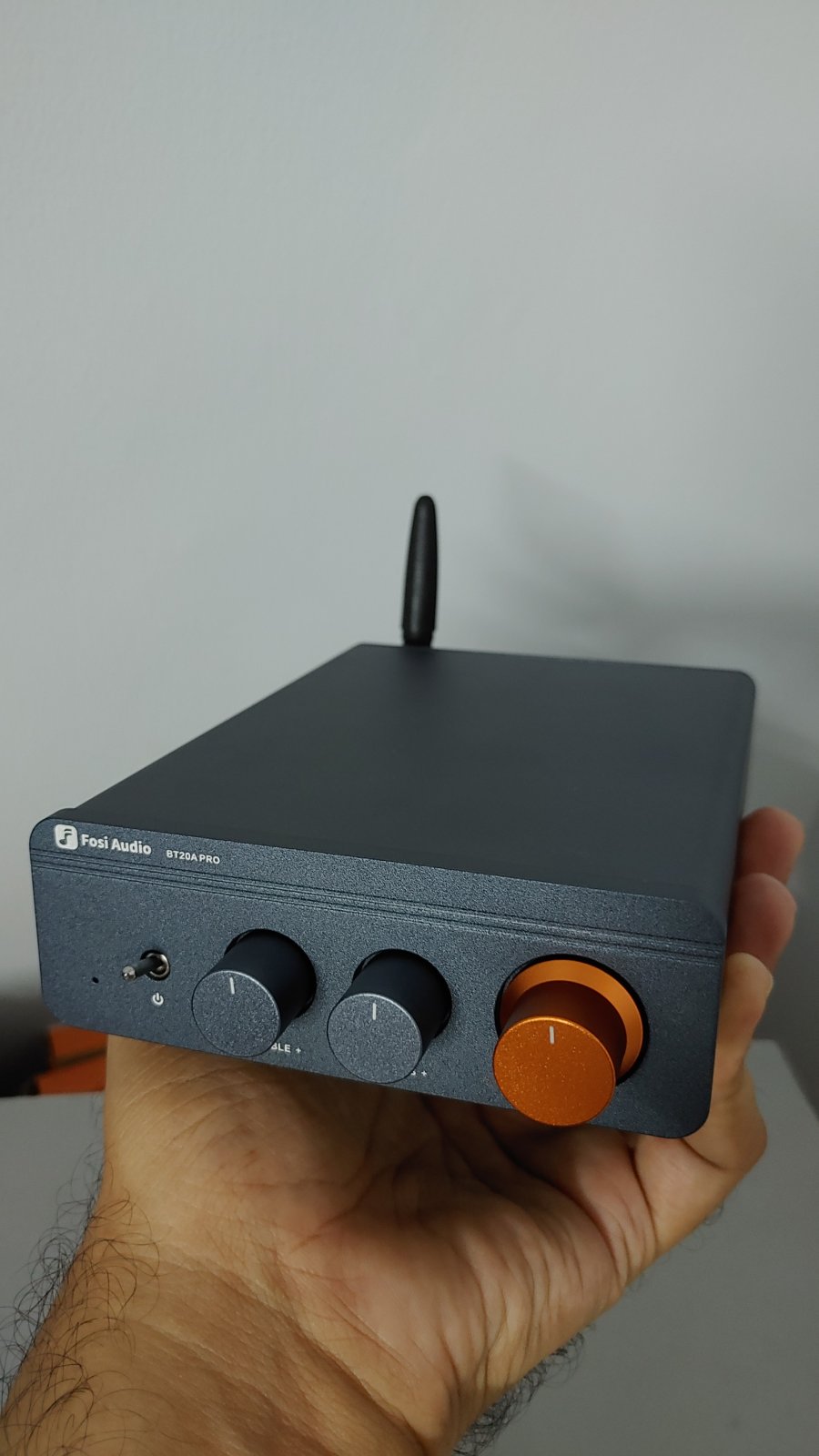

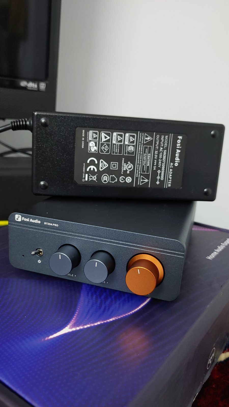

Build :

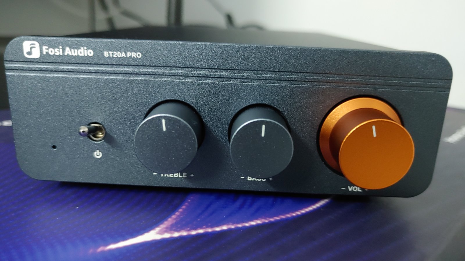

Pretty solid, everything is upto the mark, the aluminium used is of high grade anodised type.
The knobs are sturdy but somehow the one I got has a kinna wobbly volume knob, dunno if it’s just me or this is the way it is but all in all the knobs are solid and feel very good especially the copper color of the bigger volume knob gives a great and premium look to this otherwise gray beast (there is a blue color as well but it seems it’s not available here in India at this time)

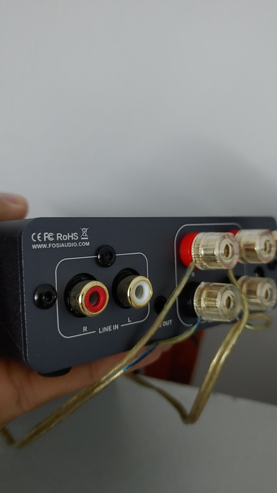

The back connectors and sockets are placed pretty close to each other, with some small maneuvering everything can be pushed, tied and fixed though.
Please mind that it takes I guess smaller pinned banana connectors.. I didn’t know and purchased the full sized (longish type, 8 in total) ones which upon connecting would remain nearly 50% outside of the socket, hence had to connect bare wires with speaker out ports.. TBH I found this method of connecting wires kind of easy, no non sense type and they are connected pretty tight with the ports.

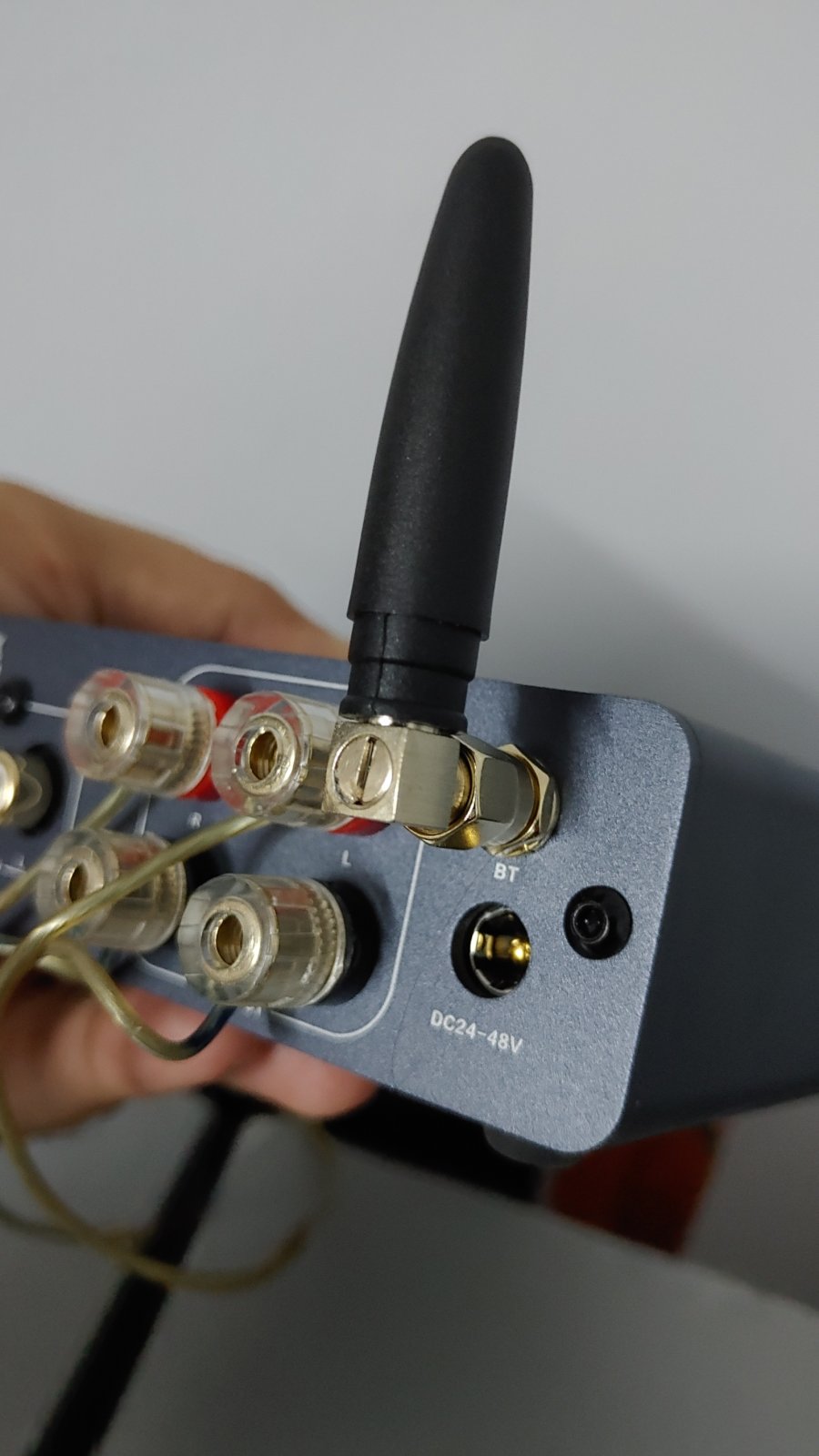

The bluetooth antenna is no nonsense standard & decent one which you have to screw yourself.

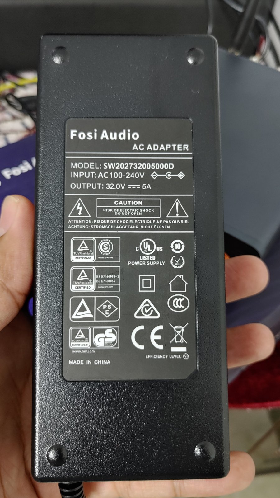

POWER SUPPLY : I was expecting a 48V power supply but seems fosi doesn’t ship that anymore, the supplied 32V is sufficient for my needs..
The wire lengths with the power supply adapter are adequate, the block and wires, all look decent and feel study enough . Checked its voltage with multimeter & it does produce what is claimed 32.4V to 32.5V.

The knobs give good feel while using and operating them… The volume knob can be pushed in & within 5 seconds it erases bluetooth memory so you can pair another source…

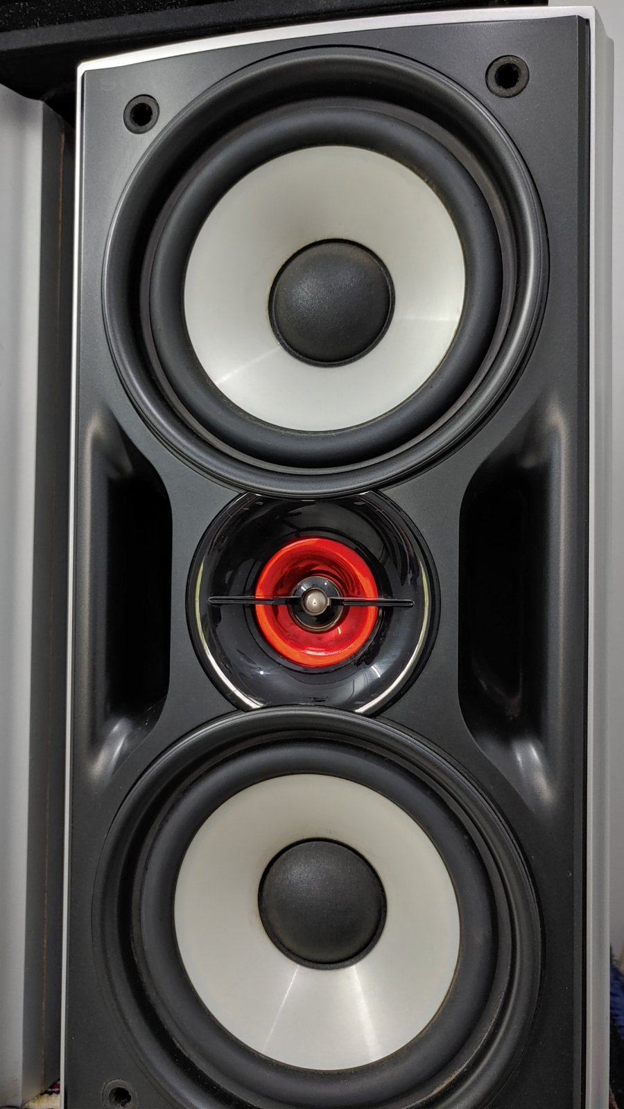

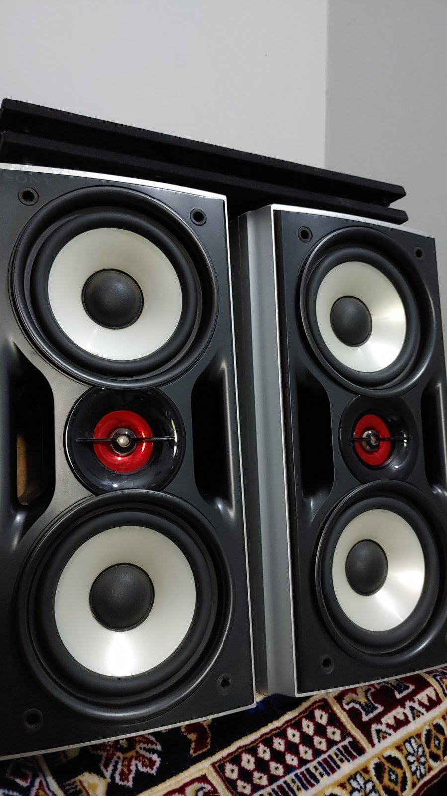

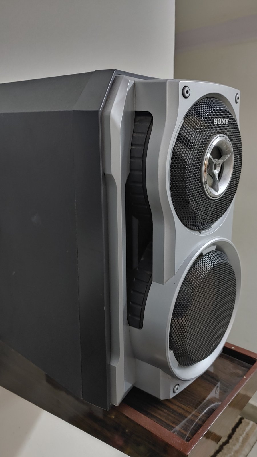

Please note I use my SONY BOOKSHELF SPEAKERS ( I call them bookshelf as they perform really well and partly coz I don’t have the machine) with this.. The ones which came with Sony MHC-Az2d music system. (edit attaching pics of them)

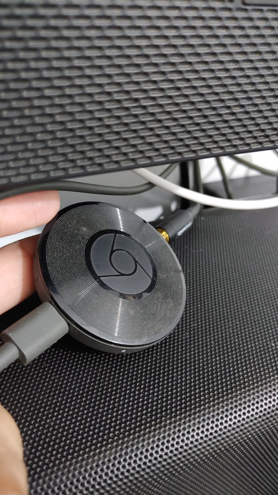

Via RCA I stream via my Google chromecast audio and the sound is even better.
Over all its pretty loud, the tone knobs do a good job and the best part is there is a neutral point for both bass and Treble exactly in the center so you get a good reference point..

But one thing is for sure, via Google chromecast audio (which technically means that there is a proper DAC before the RCA input ( as the GCA has a dedicated DAC in it) this thing just sounds so great..

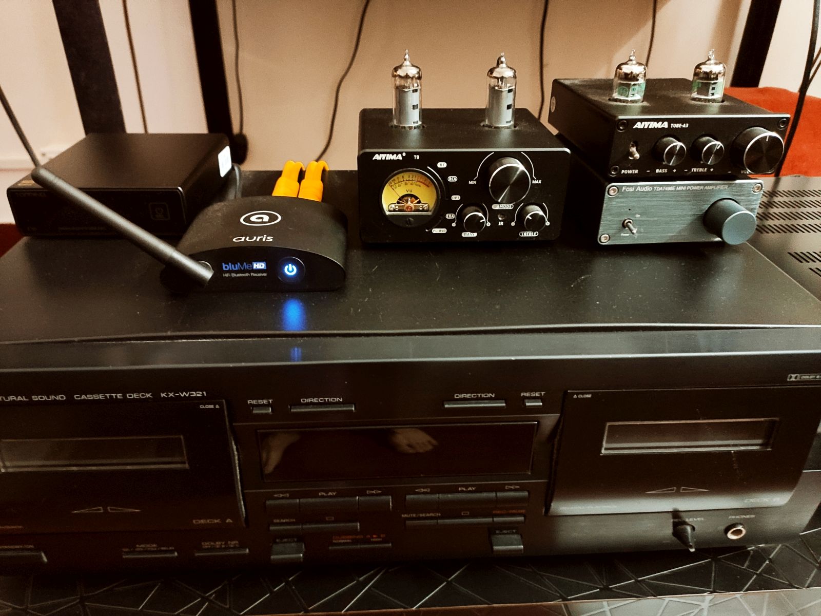

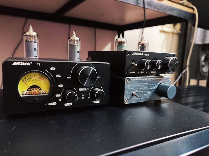

Congratulations! Nice, simple and on-point review. Fosi Amps are generally well made and I have also been using a Fosi Audio Amplifier in one of my setups:
The Fosi Audio Amplifier is a TDA7498E based unit. And as you correctly mentioned in your review, these little buggers pack some serious punch and can get LOUD!
Btw, those Sony speakers definitely remind me of the 90’s component music systems which would be there in every household! I still have mine… the CDP unfortunately doesn’t work anymore but the Radio Tuner, Tape Deck and Auxiliary still work well. Is your Sony AZ2D still working?
Nice looking setup wow 2 amps and one preamp and another monster below them all… Awesome..
Well the az2d died long back and was given to the kabadi a few years back… But I loved that system for the touch panel and clear audio though it didn’t have much low frequency response
… I have another system lying that’s RV50 but the tape deck as well as the cd player section isn’t working… So it’s a dodo as well..
But have four pairs of speakers now one pair from az2d and other from RV50.
I ll be honest they sound superb and I don’t think I ll buy any passive pair now.. Unless I want a more powerful pair..

How is the Chromecast audio connected to the Fosi amp ?
Via 3.5mm to rca cable
Then the Fosi amp is not seeing the digital signal at all. So any bit-rate or sample-rate related problems could not be due to the Fosi amp
You are right, I didn’t pay attention really that 24bit/96KHz are specifications of a digital signal, analogue ones don’t have that…
