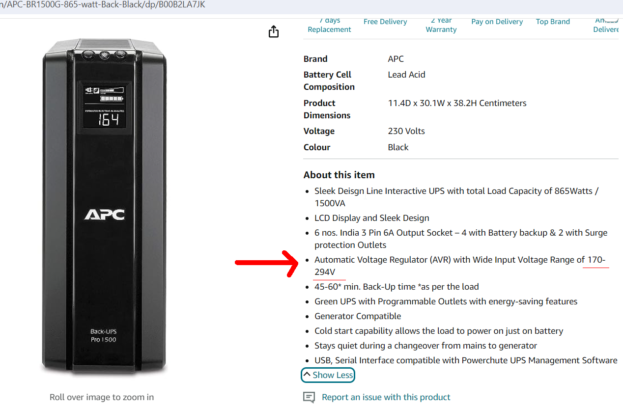

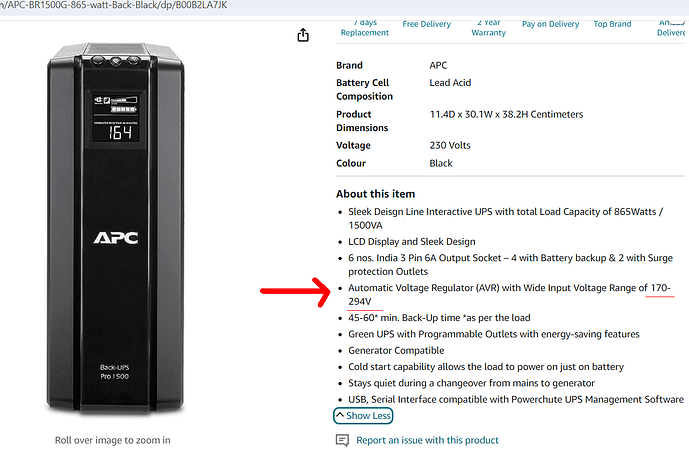

Please note: UPS wont handle voltage fluctuations very well. This is the misconception many people have.
Even a Rs. 17000 UPS from APC which has a AVR (automatic Voltage regulator) feature built-in (not present in normal UPS) is just rated for 170-295v which is not good.
In India we easily see voltages between 140volt-330volt (We have electrical business, and have data of many households)

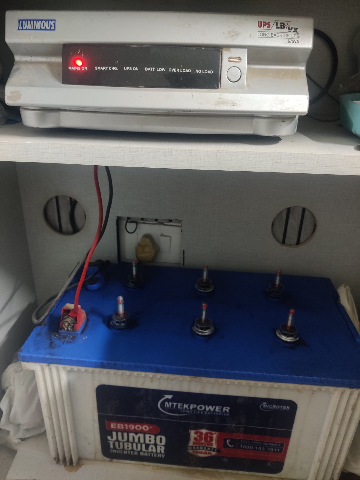

I use a normal house inverter that’s connected to every port in my house (which also powers my 5700X3D + GTX 1060 PC) except high power ones. When the electricity cuts out my PC stays alive though I do have to switch of unnecessary lights etc otherwise inverter occasionally trips after a few seconds which I think is due to just how old and low capacity it is.
Inverter: luminous 675VA (has to be over 9-10 years old)
https://www.amazon.in/Luminious-675-Sine-Wave-Inverter/dp/B00IM7CWXQ
Battery: Mtekpower 160Ah (bought a few years back)
https://www.amazon.in/dp/B0C93K7N1J
Now my case is special because my PC doesn’t consume much power (CPU takes 45W, GPU takes 120W, Motherboard another 50W roughly speaking, Monitor takes 62W max so at most you are looking at 300W consumption). Whereas your PC sports a beefy 3070ti and thank god you aren’t using an intel processor (throwing shade at intel processors for being energy inefficient lol) so this setup is definitely not enough. I’d say go with as big inverter and battery you can buy and pray for best. Unvolting your GPU will help a lot and trust me when I say this even setting a power limit to something like 90% will shave off a lot of watts without affecting your FPS much or causing any harm to GPU.

I’d go with reputed brand over cheaper brands as you never know what going to happen when shit its the fan. I have attached a photo of what my inverter setup looks like (nothing special) just in case. GL

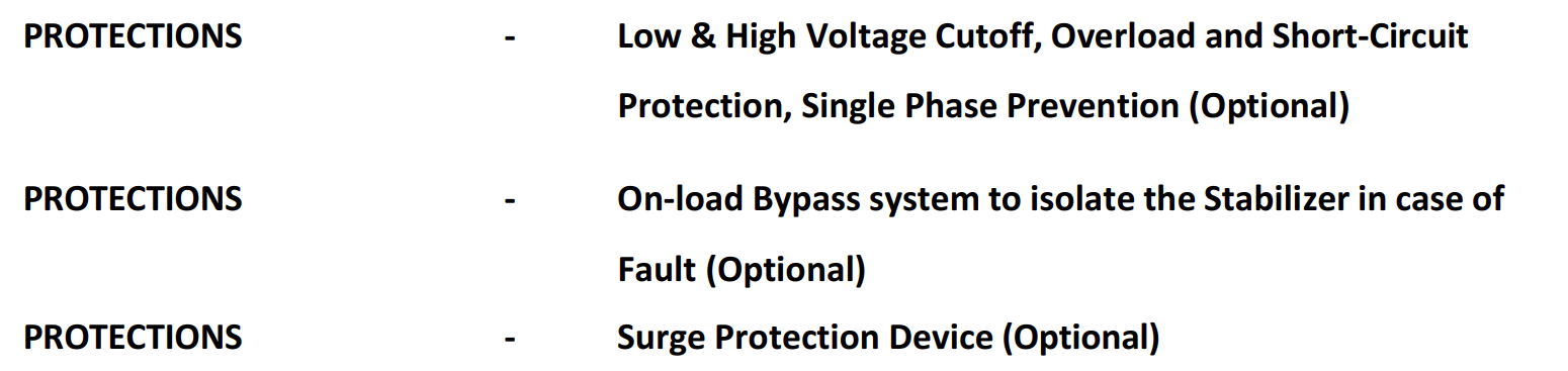

We have been recommending Servo since ages and always received so much appreciation from clients.
We always recommend to get servo with all these options included:
any servo you would recommend? specially in 15-20kva range?
