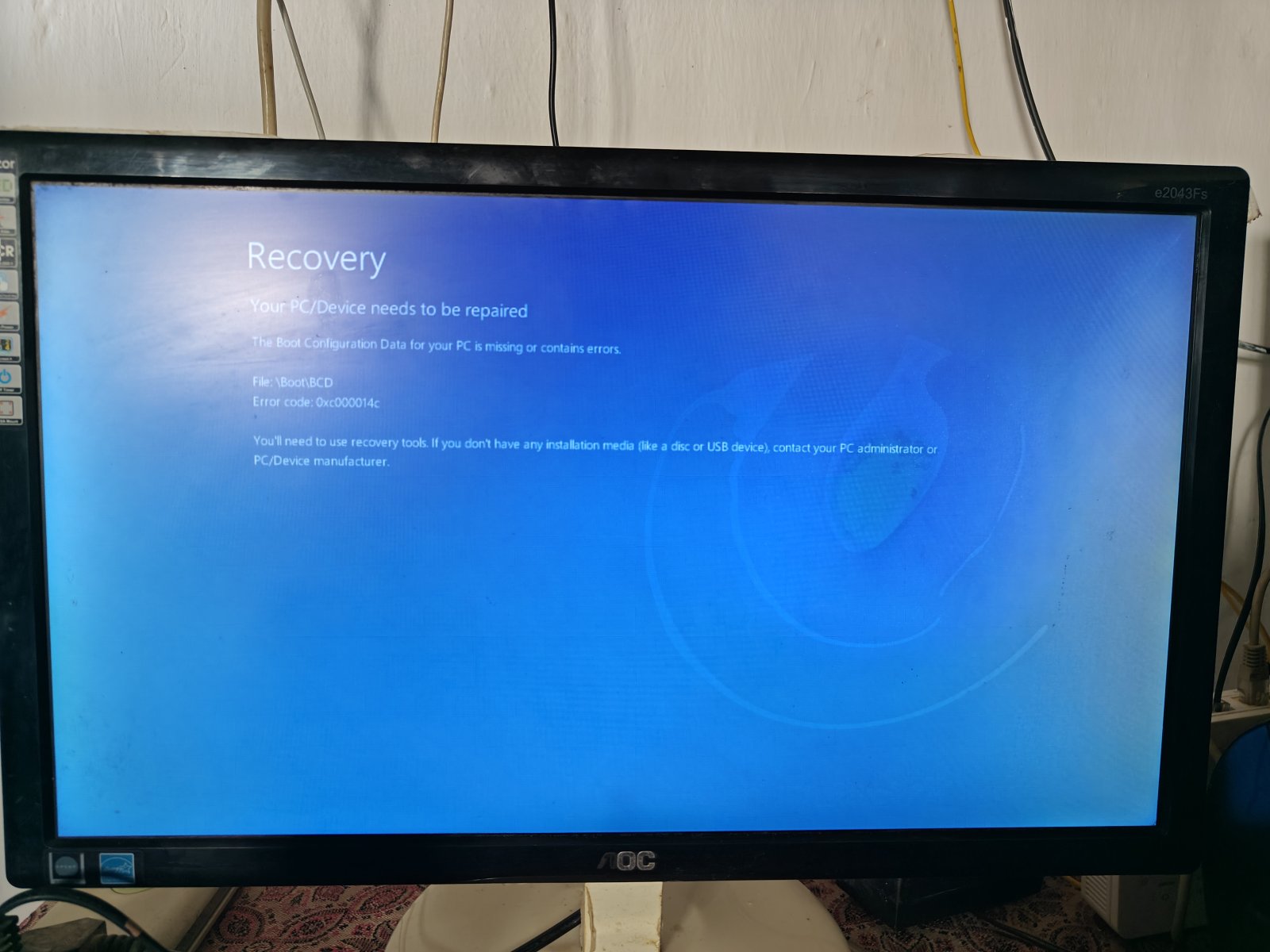

  1. I get this error upon booting the device.
The boot configuration data for your pc is missing or contains errors.
File: \Boot\BCD
Error code : 0x000014c

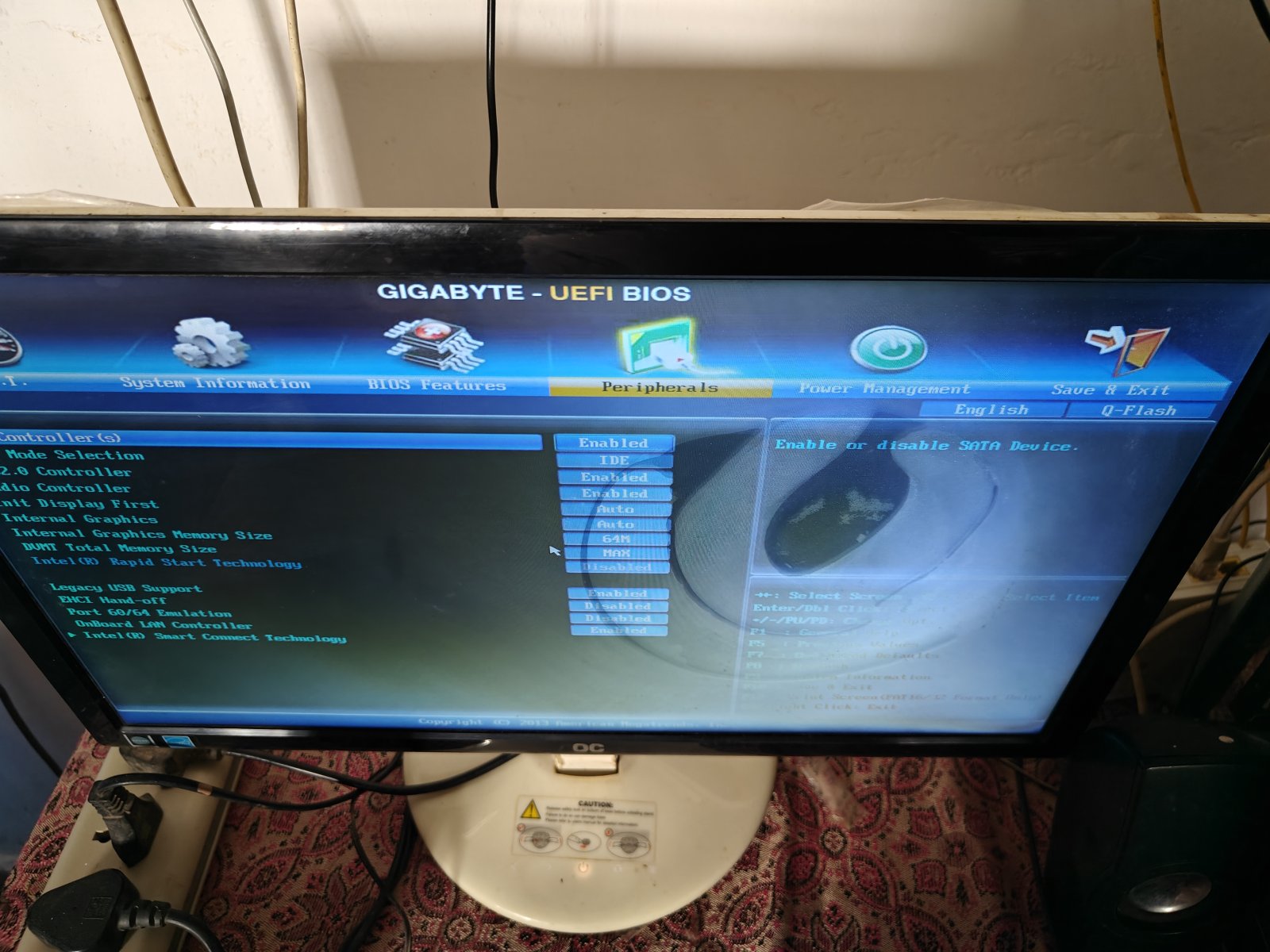

  1. The monitor was an LED by AOC.
    It has white spots on the screen. How can I get rid of them.

Error I encountered
Spots on monitor

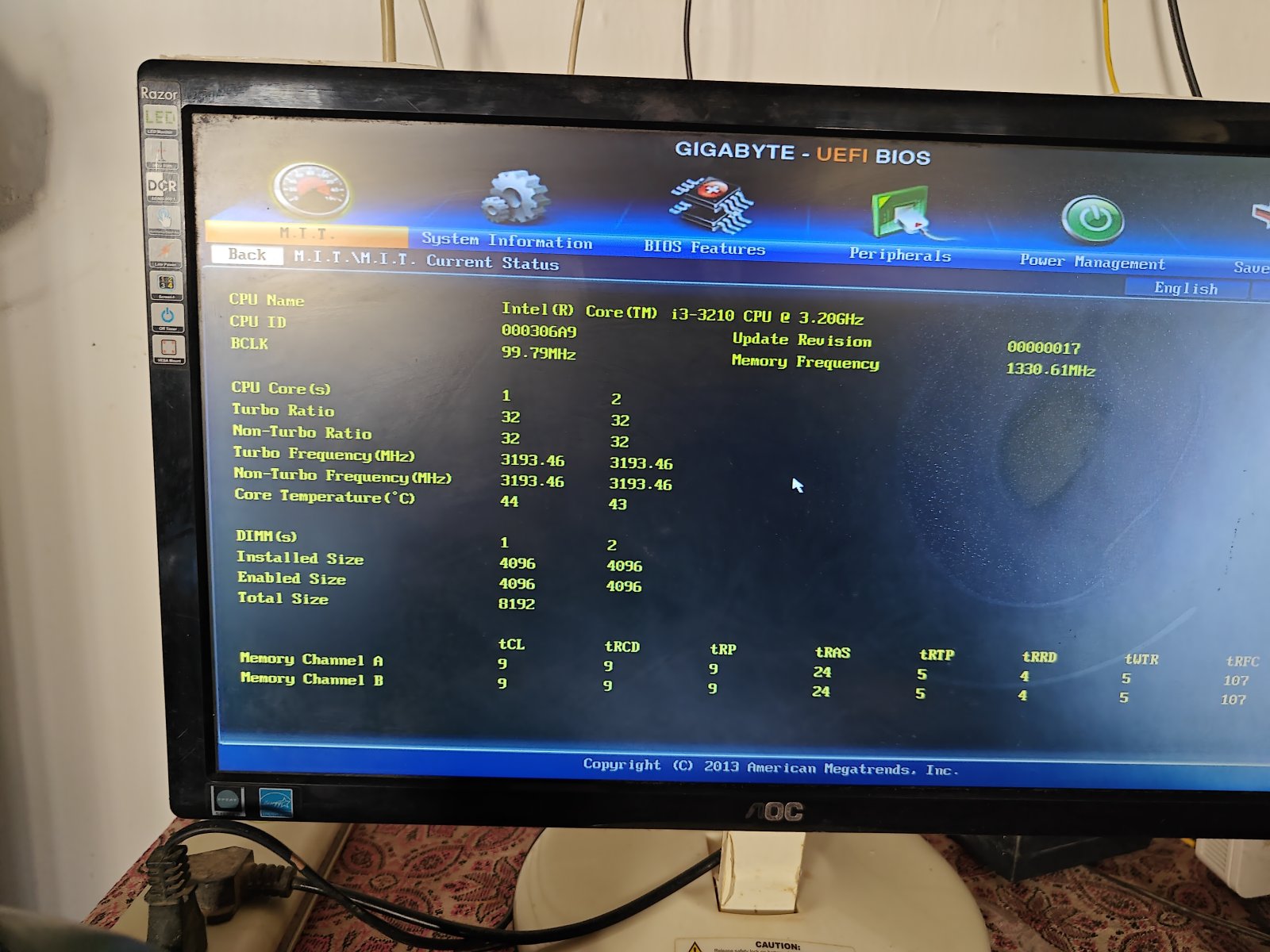

Specifications of the pc
Yes, win10 can be installed on it but again if you are simply installing and forgetting for another decade then no point taking all the renovation efforts.. Just my thoughts.
If someone is going to use the machine then it makes sense.
The error is regarding bootloader issue.
i have an aoc monitor with similar discoloured spots. apparently screen is damaged and is just e-waste now. have to throw it away somehow. like your monitor, even my monitor was lying unused for years. switched it on 1-2 years back to check it and saw the spots in center of screen.

If it’s not a big issue “bootrec /fixboot” can fix it. Watch this [video](’
https://www.youtube.com/watch?v=YFzjXS9oLjQ’
). If this does not work, you can search the internet for the error code or the error message that you encounter. However, if the partition or files are corrupted beyond repair, no amount of tinkering will work. In that case, you can try booting into a live Linux distro such as Ubuntu and access your files from there. You can then copy them to an external disk without installing any OS.
If you want to install Windows 10 without losing any data, you might be able to do so if you can fix the error. However, I would recommend you to consider using a Linux distro instead (if that’s possible), as it can run much more smoothly on old hardware. If you are nerdy enough you can even try self hosing stuff.
Regarding the monitor, it is failing and there is no way to prevent or repair it. The problem will worsen over time until the monitor stops working completely. I’ve had two old monitors do this to me
