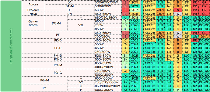

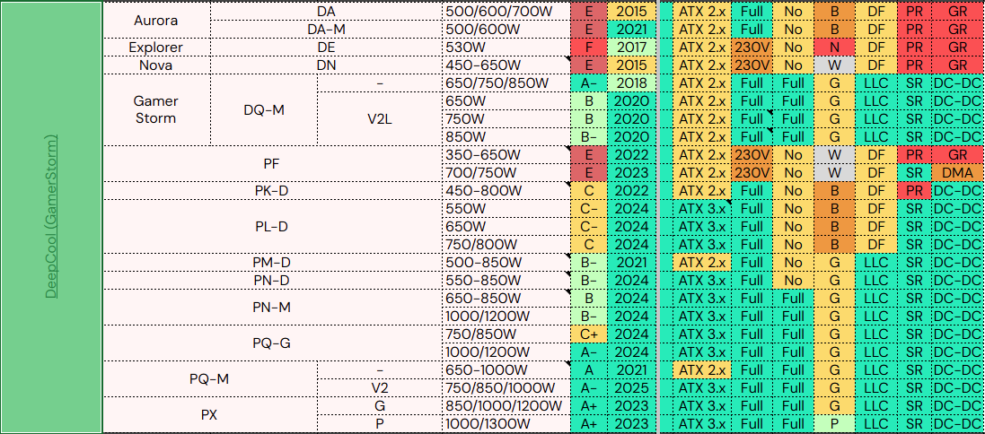

Just try to use the SPL Tier list and aim to get a PSU atleast B or higher according to your budget.

go with deepcool modular series. it’s on sale on amazon right now. FML but I just bought 2 PSUs 3 months back for lower wattage / quality / non modular compared to the pricing that deepcool is offering on amazon. and deepcool modular is A tier
Can you suggest which ones? As I see here, only a few are A tier ones.
The PQXXXM is expensive by 2k
The PNXXXD is around 8K on amazon rn this is non modular BTW
Isn’t the corsair rm-x 850 a better buy at 8.5k?
Yes, even their RMA is good if you have the budget, go for it. Check the ATX variant; all the ones on EliteHubs seem to be 2.0 (clearance sale)rm850x-shift-80-gold, and beware of this unit buy it if your case supports it. And also, if you have the budget of 8.5K, check superflower leadex 3 super-flower-leadex-iii-750w-platinum. This will be enough even for 5080.
Bought DeepCool PN650D from Vedant Computers @5700 2 days ago. Pretty good B Tier PSU. You can go for MSI MAG A750GL around 7k, this one also very good.
