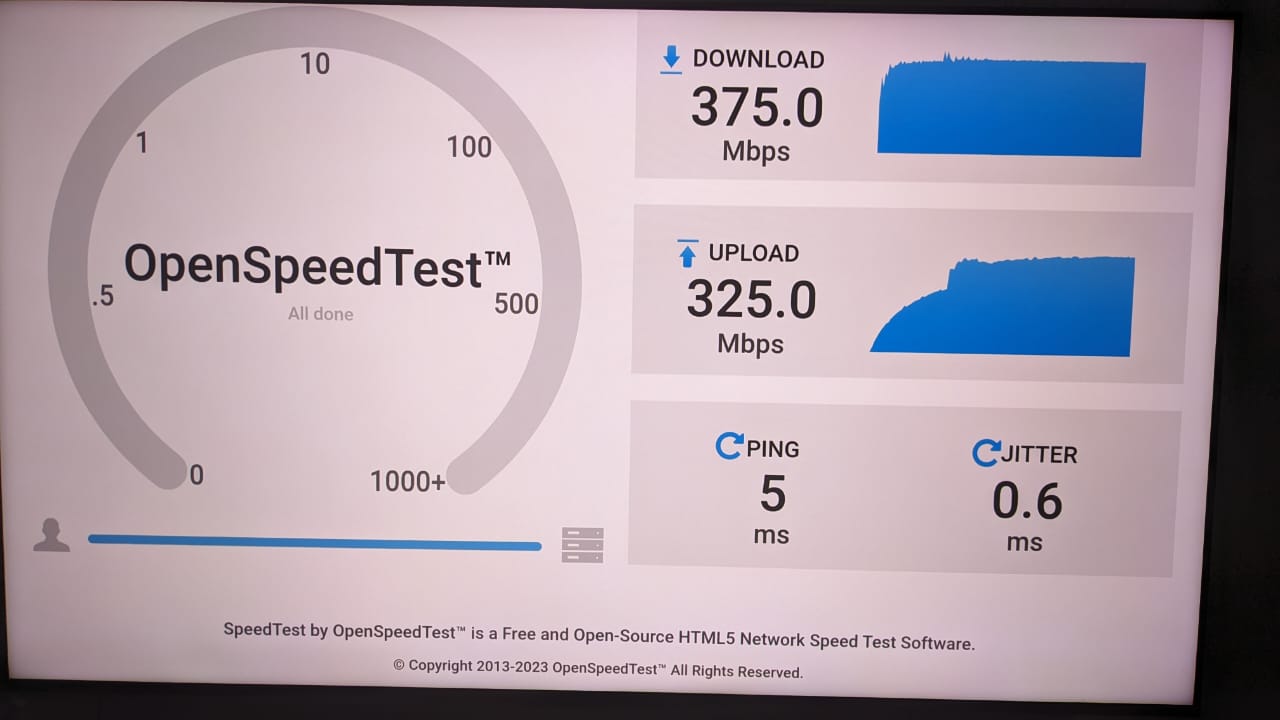

Regarding the USB To Ethernet adapter, I bought this TP-LINK one a few days ago:
https://www.amazon.in/TP-Link-TL-UE300-Gigabit-Ethernet-Network/dp/B00V4BGDKU
It works well with my FireTV 4k’s USB2 port. USB2 tops out at 480 mb/s, so I’m guessing this is around the max you can get with the protocol overheads. Slightly faster than my WiFi6 router with way better latency.

do you have any extender you can hook this up to? I need to see how much the performance will degrade over the extender, the minimum cable length I need is 6ft and preferably 10ft so I’m not sure how it will work out with that
I unfortunately don’t have an extender to test that. But USB2 is rated for up to 16 feet, so maybe it won’t make a difference?
