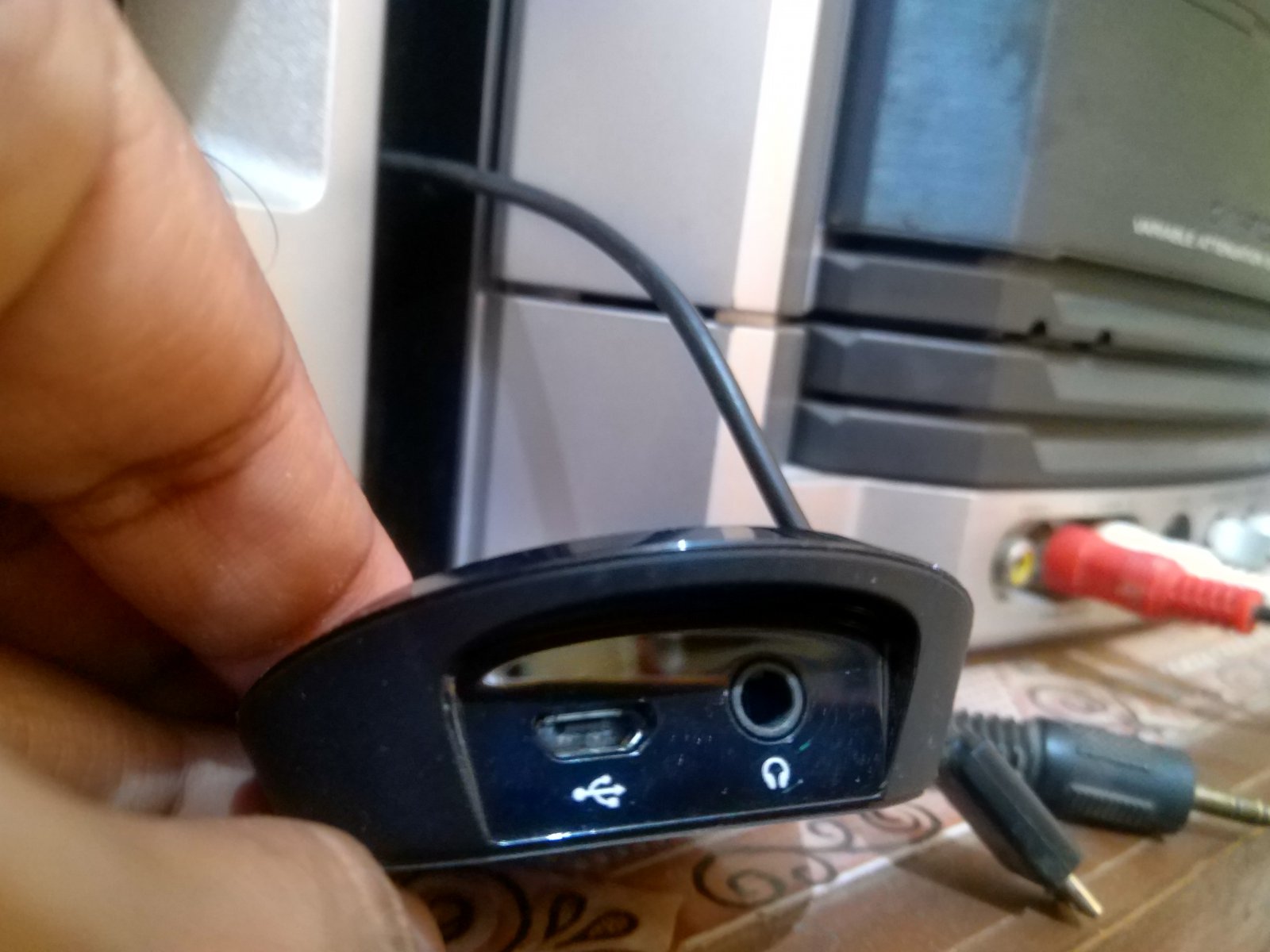

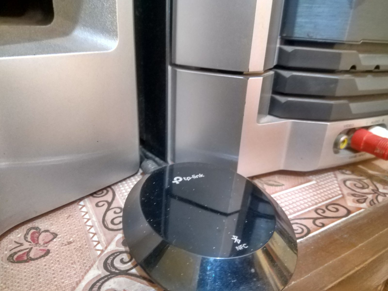

I too have a 15 yr old sony GN100D with no bluetooth so connected a tp-link bluetooth receiver to the system via 3.5mm to rca cable. pics attached, you can check them out.
