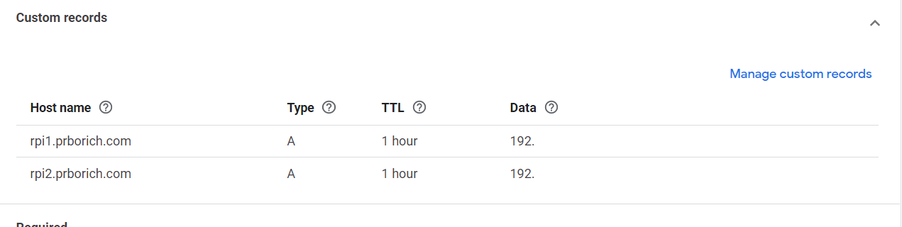

In your domain DNS settings, set up a A record for the subdomain pointing to the IP you want

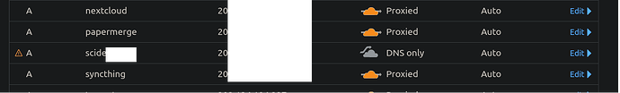

I have this setup currently but am not in the local environment currently. It works pretty well. I have a static IP (paying extra for that). I used the following tutorials for my setup:
Another: https://shollyethan.medium.com/configuring-a-reverse-proxy-with-nginx-proxy-manager-cloudflare-and-a-custom-domain-100b5175fba2
I can share further details in a few days when I get home. I have attached my cloudflare DNS settings screenshot.
