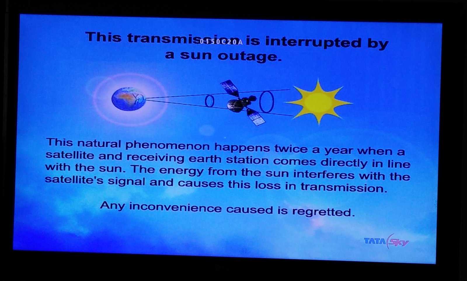

  1. Intermittent info screen popped up saying - Earth, satellite and the Sun are in a line causing solar disturbance of some kind. Couldn’t read fully…

I too got this message but it was only for a couple of minutes during the India match on Tuesday.

The Sun outage is a natural phenomenon and lasts for few minutes. In my case it was less than 10min. Its said to happen twice a year.
