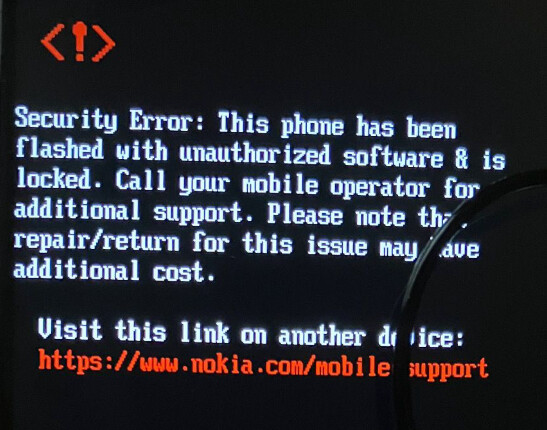

Also, once it also showed a screen where it said “Security error: this device has been flashed with unauthorized & is locked”.
But, I haven’t flashed any software or any ROM on the device since I bought it 2 years ago.

This was the message you got.
His phone is stuck on this message, yours got past that I believe.

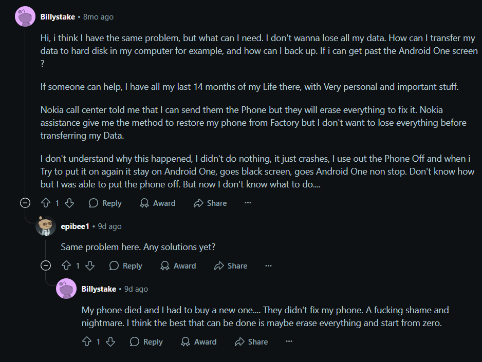

Someone saying this on that thread.
One another guy who had this problem.

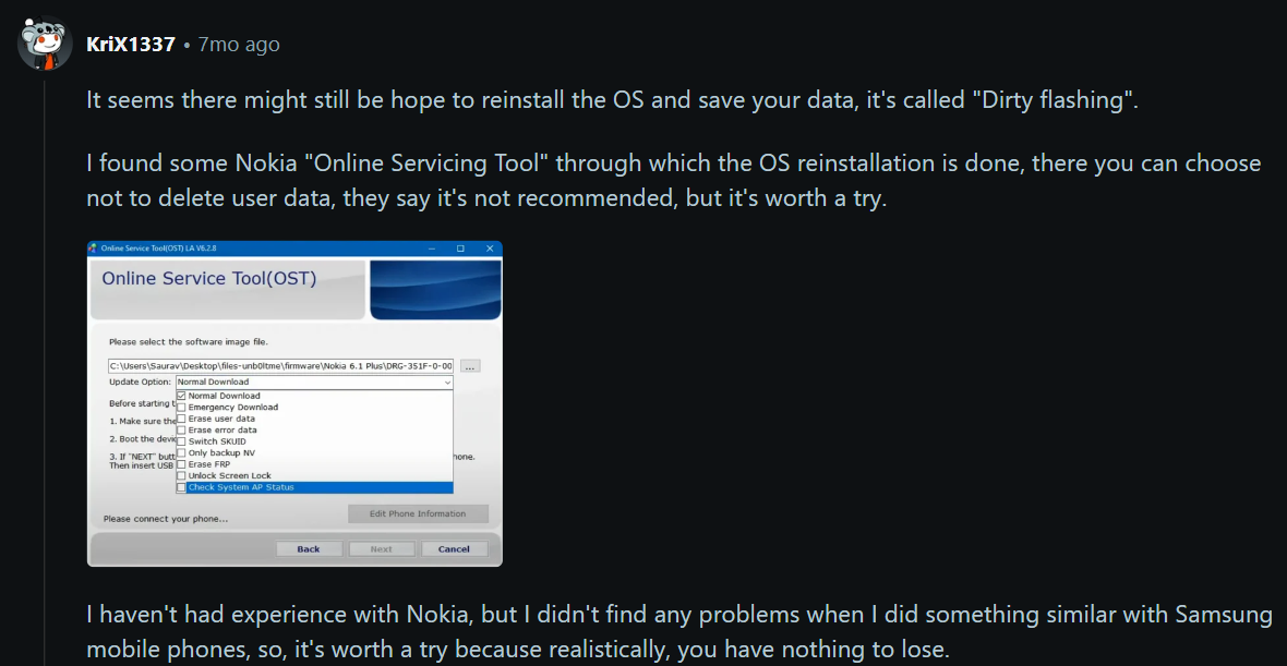

If nothing else worked, this might be your last option.
