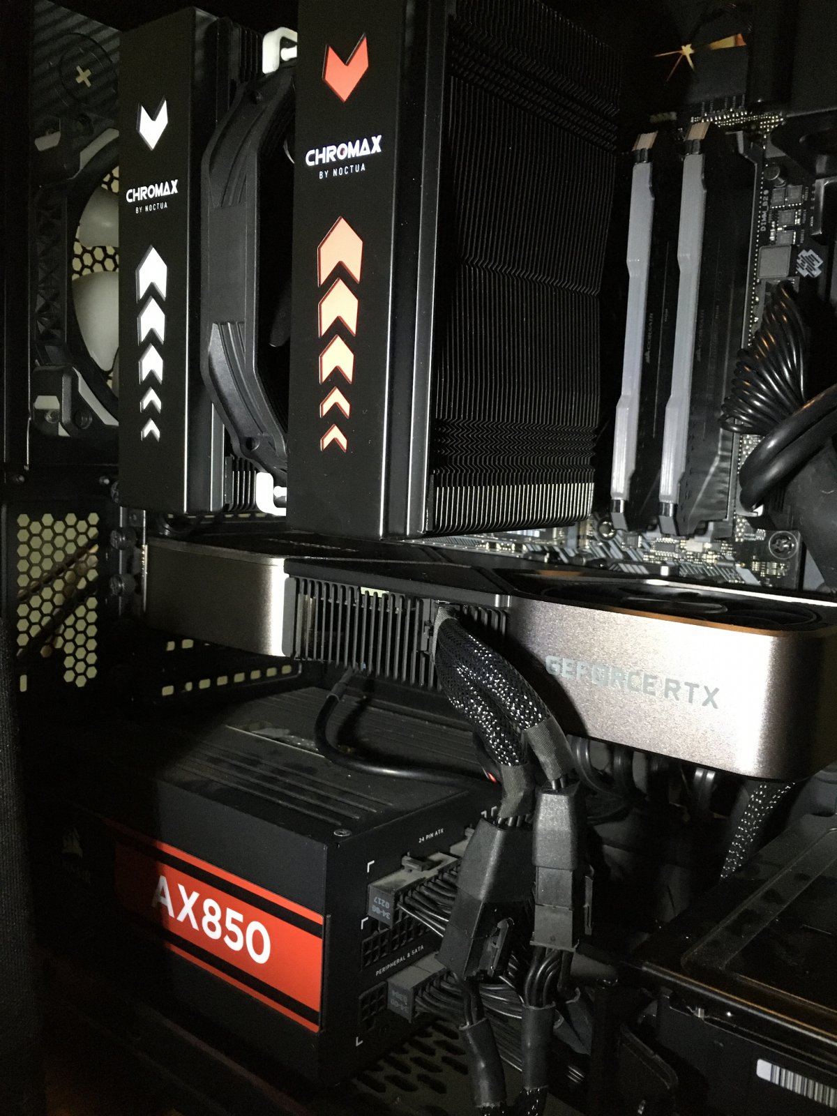

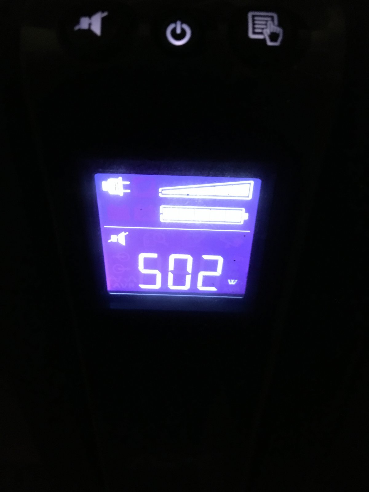

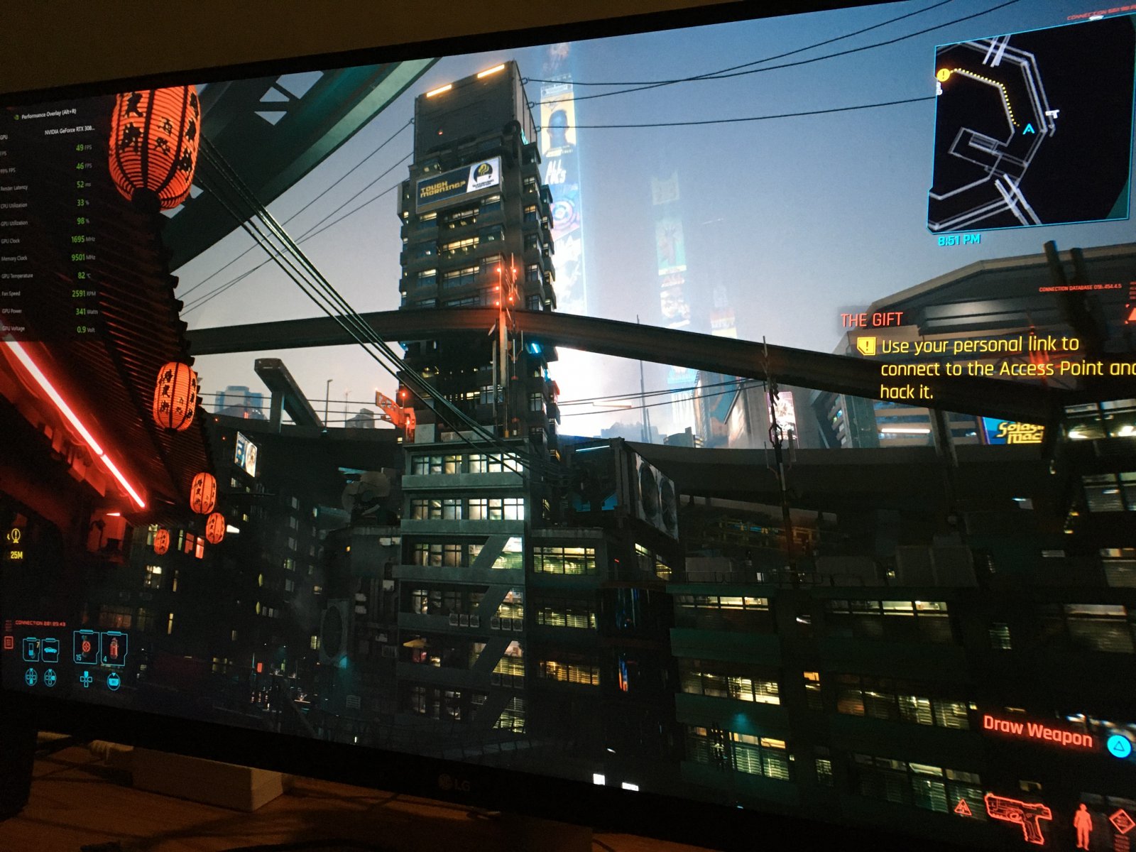

Don‘t know about the third party cards but my FE is running hot. I hope this is normal. Sucking almost 350w(gpu)+100w(cpu)+50w(4k monitor).
Thats what I mentioned somewhere that FEs does run hotter than other brands hence always suggest people to ditch FE and stick to Zotacs!
FE cards do look amazing imo. The RTX 3080 in particular, looks absolutely boss. Been a fan of 'em since Maxwell. They’re also generally two-slot and ideal for SFF builds.
Have you tried undervolting your card? Also, what’s your setup like?

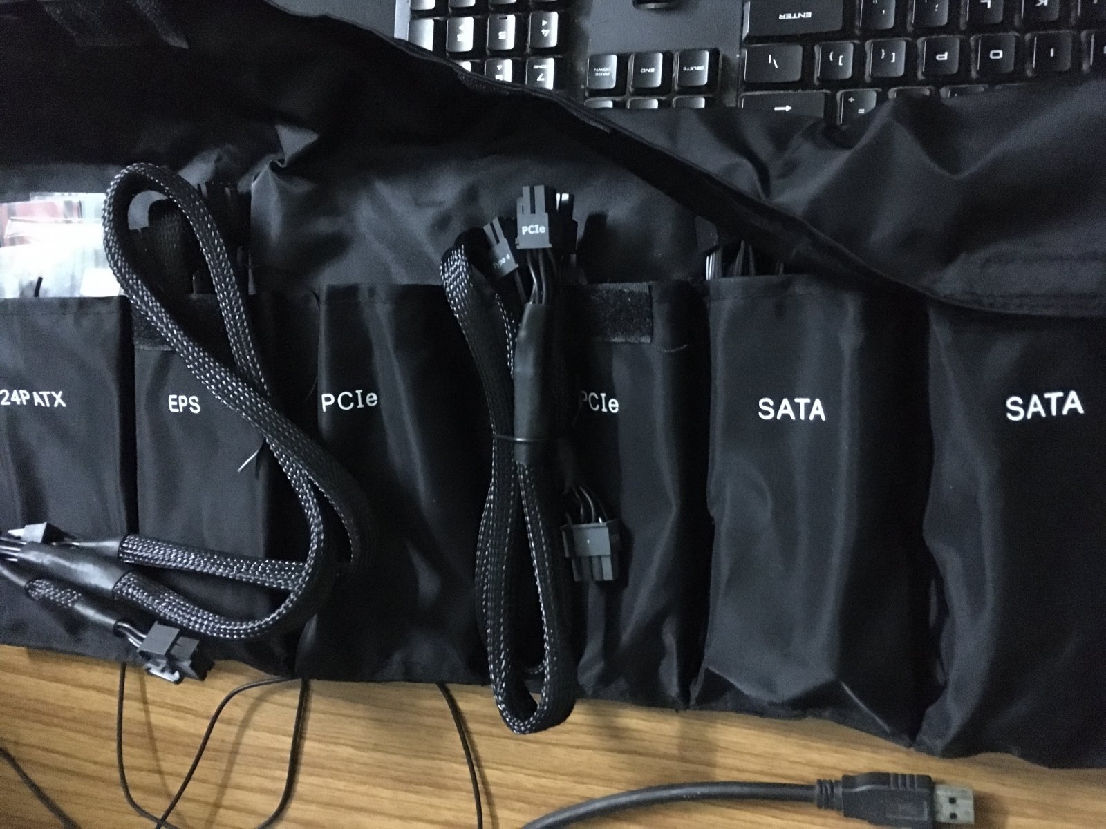

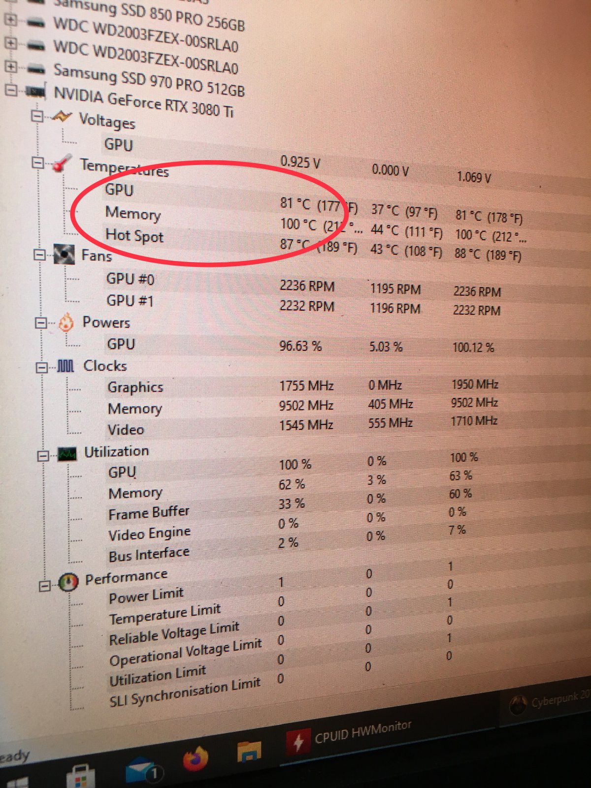

Nah, I prefer stock settings. I did some research and upto 100-110C is under the specs for ddr6. It will only throttle after 110C. GPU is around 83C which is fine. But I don’t like the airflow of new FE card. Throwing hot air towards the(5800x) cpu. It will most probably hit the cpu boost performance during May-July(summer peak). I was also facing random pc shut down during heavy gaming. Then I realise I have to use two separate pcie power cable per 6+2 plug. Don’t use single cable. It won’t be able to handle the power during heavy load.
I’m puzzled as to why you prefer stock settings and why you’re using the thermal threshold of the GDDR6X memory as a guide to whether or not your GPU is doing ‘fine’ with respect to temps. Undervolting should net you **better **performance (by allowing the GPU to boost higher) with **lower **GPU temps and fan noise. Lower GPU temps should also lower overall system (incl. CPU) temps given the flow-through cooler design. At 83 C, your GPU is **definitely **dialing back the core clock to remain within acceptable temperatures. Run a 3D Mark Port Royal benchmark with HWiNFO64 running in the background. HWiNFO will let you know if your GPU is throttling or not (my take is that it definitely is). Also, compare benchmark results pre- and post-undervolting to get a handle of much of a difference it can make.
