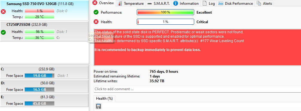

Currently, the setup consists of a 250GB NVME (Crucial P2) in main m.2 slot and a 120GB Sata ssd (Samsung 750Evo) as boot drive and linux hub. Unfortunately, the second drive threw up health error so I wanted to get rid of.

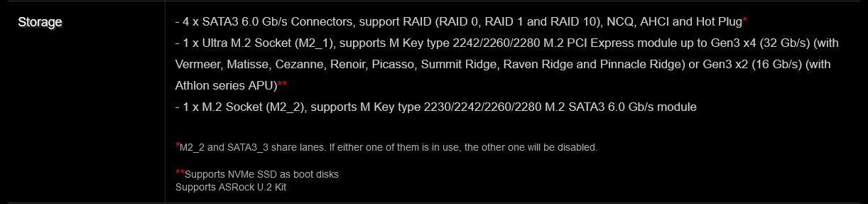

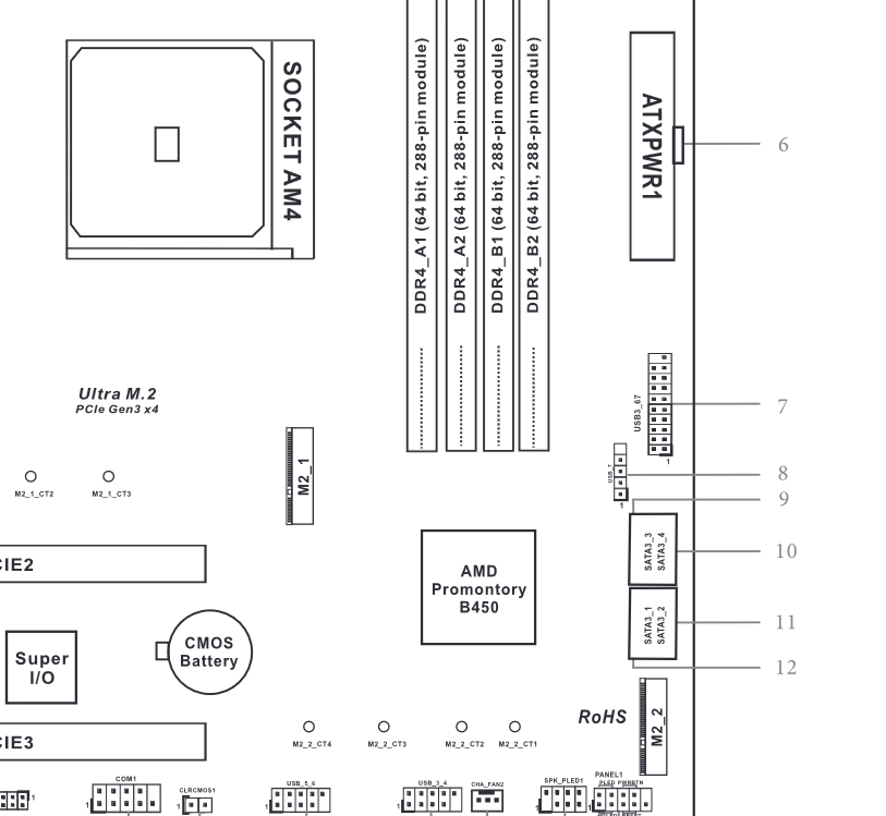

Now, I was planning to ditch the 120Gb and shift to NVME, since my board (ASRock B450M Pro4-F) has 2, m.2 slot, one working as PCIe 3.0 and other in Sata interface. I didn’t mind the drop in speed since I was planning to dump my OS drive on it.

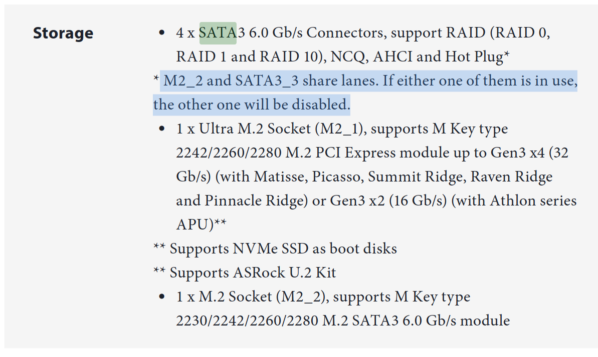

The board has certain condition for second m.2 slot to be used i.e. the #3 SATA port shouldn’t be in use else one drive will not be detected. Thankfully, I only have 1 SATA drive in use and that too in slot #1.
To my despair, none of the m.2 drives are getting detected in the second m.2 slot. I even tried removing the SATA SSD altogether but to no avail.

This board only supports 1xnvme and second is only sata. That sata m.2 won’t work with nvme. You can use the x4 PCI-E 2nd slot (I thinks it’s PCI-E gen2 x4) with an adapter for another nvme. The other alternative is to use external nvme to USB adapter.
Damn, I thought it will work since nvme also has m key. Now, I have to get an adapter. Do you have any recommendation for a pcie adapter ? I’ll be using it in the other PCIE slot.

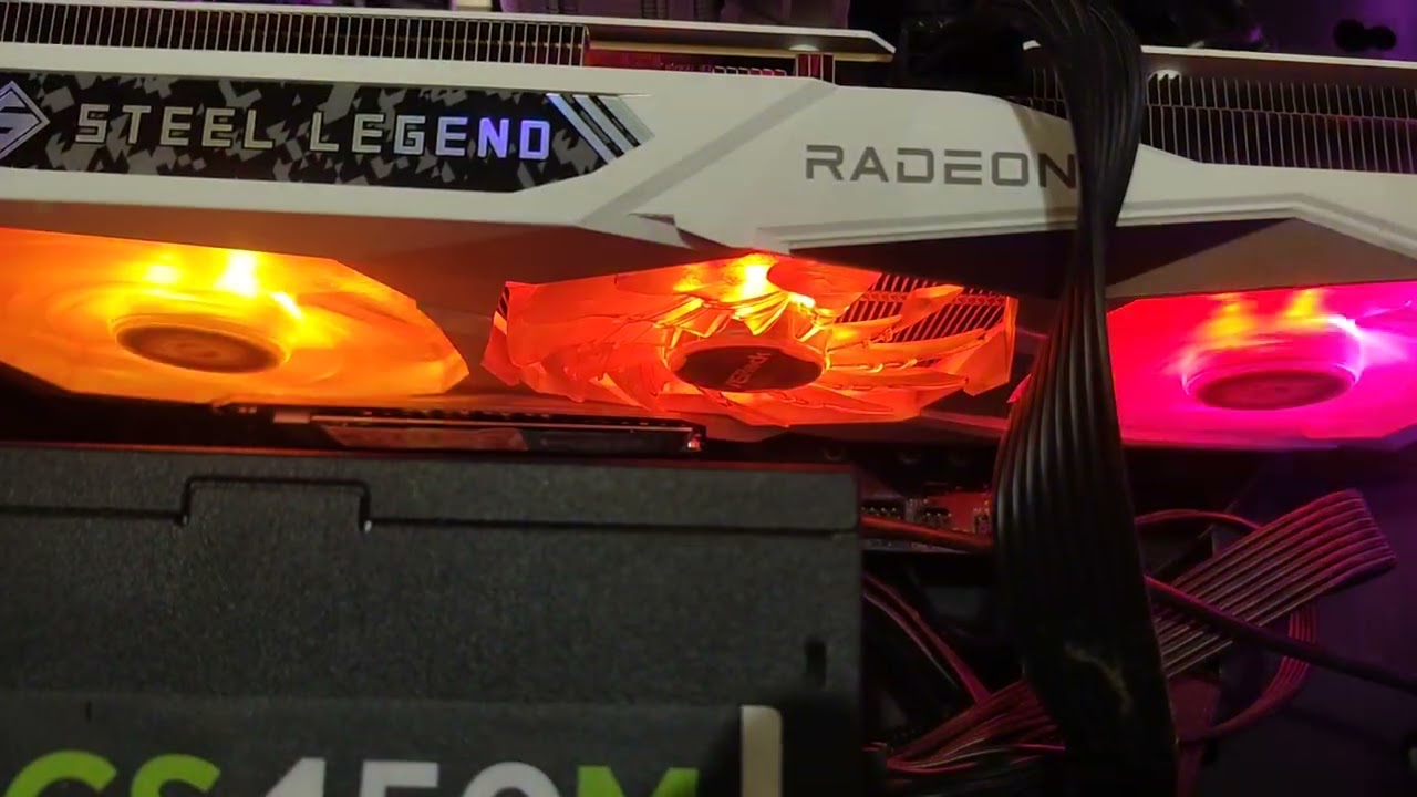

Got the adapter, its working alright and the drives are getting detected. Unfortunately, the adapter is very close the GPU and is restricting the fans. Completely stopping the middle fan and creating screeching noise with the other.
Will order the PCI x4 adapter instead and if that doesn’t work then changing the MB is the only solution.
