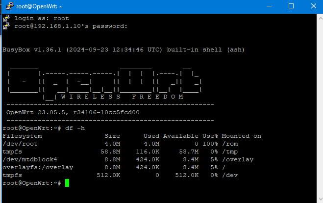

What is the size of flash storage for x23 v1.2 Indian variant? I read in reddit it’s only 8mb?
v1 was 16mb & v2 is not officially supported by openwrt so what’s the point. As the post mentioned above, if planning on installing openwrt then better get a used mini pc/nuc from here (check dealer’s paradise section) which will leave any router far behind in dust.
Yep. It’s 8 mb on the AX23 v1.2.
Still works great for me. Probably because I don’t run any other services on my router. If you have a homelab server, I don’t particularly see the point of having storage on your router.

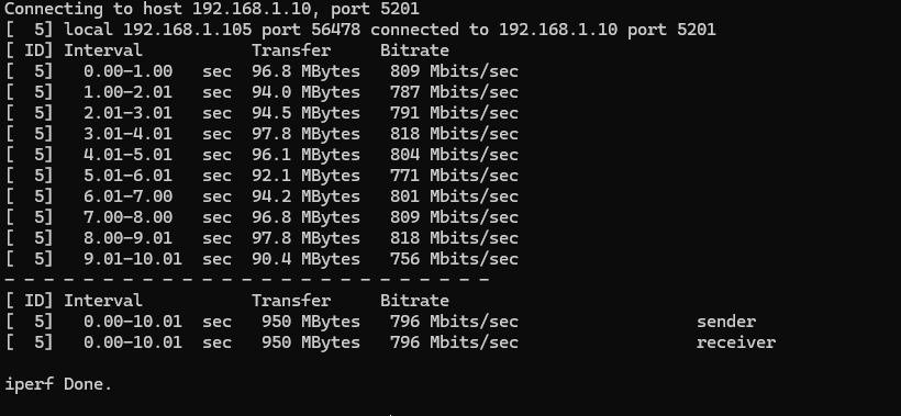

I get around 800 mb/s on lan. Software/Hardware offloading turned on. A bit lower than gigabit but I bet the 10m+ of cat6 in my walls doesn’t help that. My wan maxes out at 200 mb/s so I can’t really test past that. I have my nas connected directly to my pc via a 2.5 gbe card, so the lan speeds don’t matter that much to me either. The 300 mbps limit is likely only if you use SQM.
