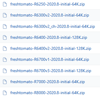

I recently switched to using FreshTomato on my R7000 and I can’t believe how easy it was. It’s so stupid that I was using Netgear’s slow and restrictive firmware for the last few years. Definitely get a router that has support for custom firmwares.

FreshTomato is not available for the Netgear R6850.
