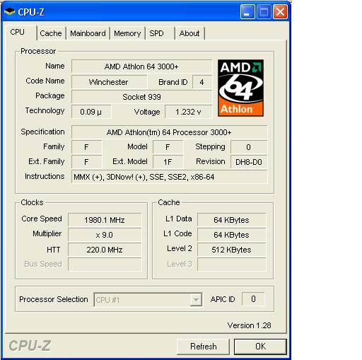

Ok I done everthin I can but I cant get it to boot at anything over 1.9ghz :frowning:
It did 2.2 at first during testing. Now anything more than 210 FSB wont boot.
Set the CPU vol to 1.5 which increased ram vol to 2.7. I Even reduced the ram speed to 266mhz.
What I am I doing wrong? :help2:
This is first overclock in this platform

first see how high your ram can go. reduce your cpu multiplier to 7
set the htt multiplier to 4x or 3x . make sure your hypertransport frequency doesnt go over 1000mhz. your htt * htt multiplier gives you that. eg 250mhz ht * 4 = 1000mhz.
set the timings to 3-4-4-8. set the voltage to 2.8v
now increase the htt from 200Mhz by increments of 3mhz till it gets unstable.
once you know the frequency that you can oc your ram till you can start ocing your cpu
set vcore to 1.6. or 1.55 and htt to 200mhz and increase again by 3mhz till it gets unstable.
once you know the max frequencies for cpu and ram you can set the multiplier to something appropriate.
say ram maxes out at 250 mhz and cpu at 2520mhz , you can use a setting of 250*10 where your ram runs at 250mhz and cpu @ 2500mhz .

Ok first off I didnt reduce HTT speed. I left at 5x thats one reason why I couldnt overclock.
I reduced it to 4x and it really does overclock pretty well. Managed 240 fsb. I need to push it furthur :wink:
And did this on 1.25V :grinning_face_with_smiling_eyes:

I really didnt know that SATA 1 & 2 dont work when you overclock. At 240fsb I used to get BSOD’s. Changed to Sata 3 & 4 will try overclocking some more. Thanks again for link bottle. :wink:

Managed to go a bit above 2.4ghz! :grinning_face_with_smiling_eyes:
