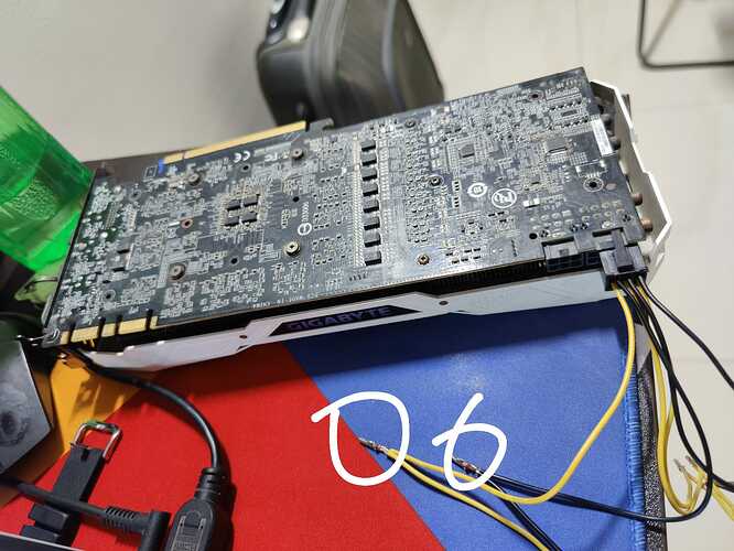

Using a spare 6pin PCIE power cable with open wires, I checked the +12v and ground lead on the card with a multimeter, set to continuity mode, and it shows 100% continuity (it beeped), indicating there is a short. Seems obvious that the yellow and black should **not **show 100% continuity, right? Adding @@rsaeon who is also an expert here on PSUs and can help confirm the previous statement.

Glad that you got something to test and that the gpu seems at fault here per your tests and observations.
