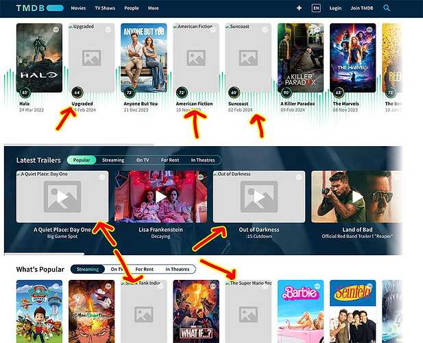

***edit/update ****- 16/02/24 - this issue is with the ISP and has nothing much to do with adblocker. *
media.themoviedb.org from 192.168.1.100
09:12:14: forwarded media.themoviedb.org to 127.0.0.1#5335
09:12:14: reply media.themoviedb.org is <CNAME>
09:12:14: reply tmdb-web-image-prod.b-cdn.net is 103.180.115.15
09:12:14: reply tmdb-web-image-prod.b-cdn.net is NODATA
As of now, now i have tried all possible ways to troubleshoot (some were asked by pihole dev team to test)
a) disabled unbound
b) disabled/alter adblock filter lists.
c) one point of time i have deleted entire Adblock list - that too didn’t made any difference.
d) disable adblock for 10/30 minute from dashboard.

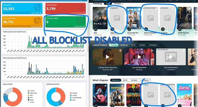

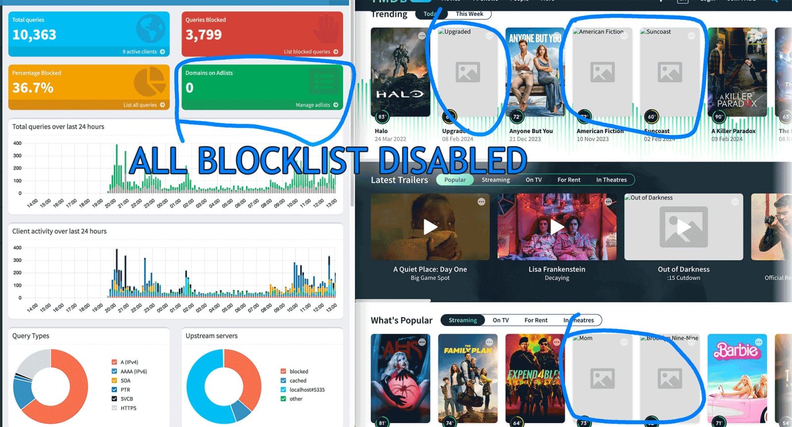

here is the images with all adblocking/regex disabled:
in nutshell, regardless my configuration if im using pihole dns it is breaking TMDB, if i change DNS to any public like 9.9.9.11 or 1.1.1.1, there is no issues with the site.
Today i attempted to downgrade pihole to previous version ( which is confusing and complicated), ended up corrupting the installation.
Hence had to do a complete clean installation - its still breaking this perticular site.
Anyone has any suggestion how to fix this, and if im missing something vital to troubleshoot.
I really want to stay in pihole, i liked the device grouping and i use that extensively. but if its breaking site like this ( plus dont know what else its breaking) - i have to move away from it.
TIA.

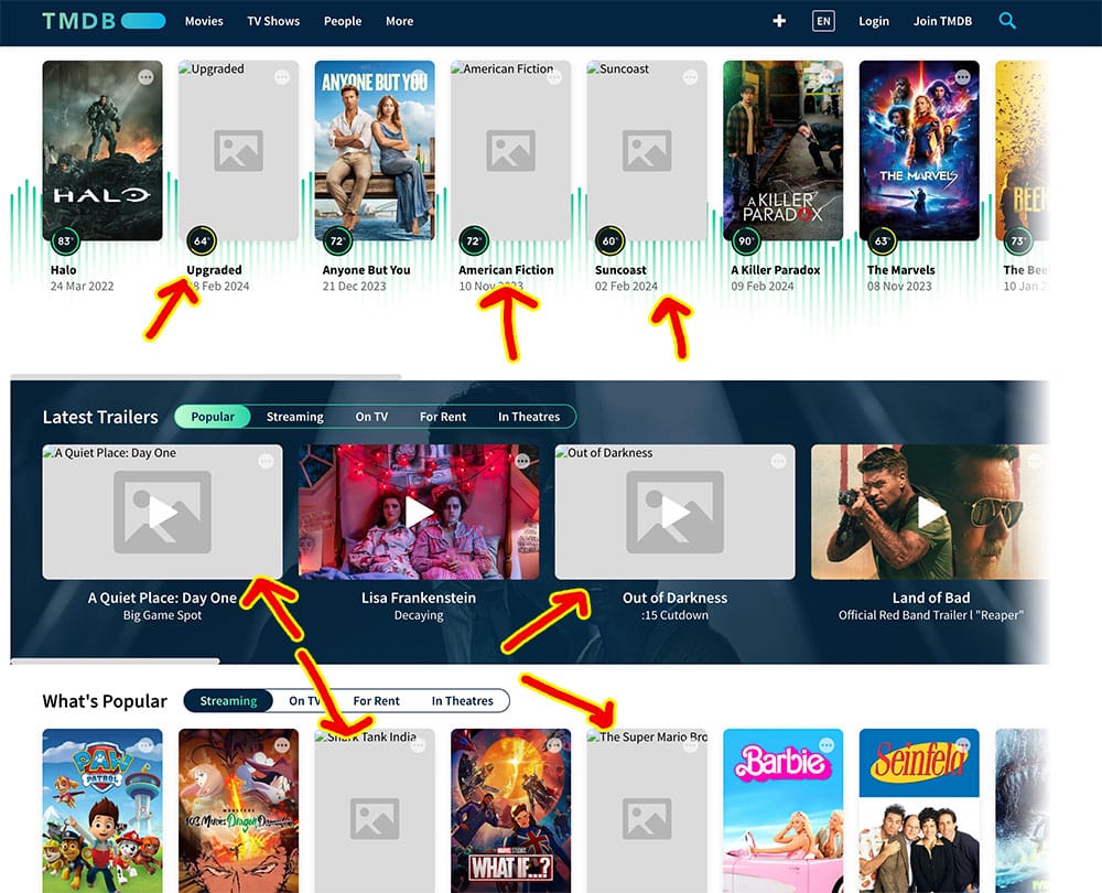

It’s an issue with the website.
Exactly the same images fail to load for me on the website
BUT if you right click and copy image address and open it in another tab then it works.
I use AdguardHome and lists are minimal. If lists were an issue then it wouldn’t load on a new tab too.

i just added new image in my previous post, disabling all adblocks lists.. issues remains the same.

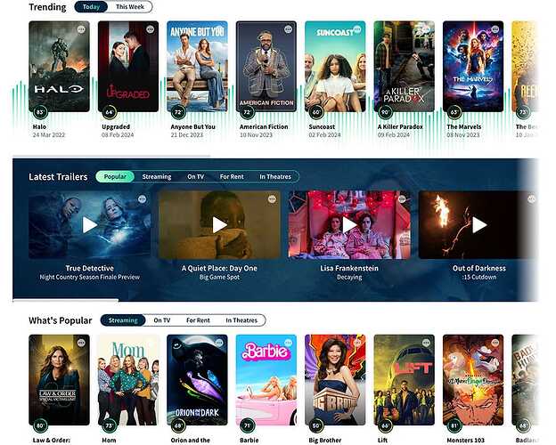

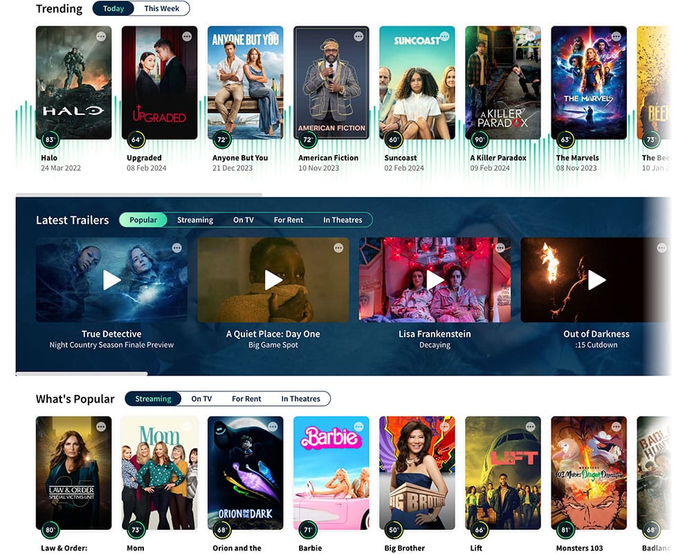

here the website with quad9, 9.9.9.11 DNS
see all images loads fine

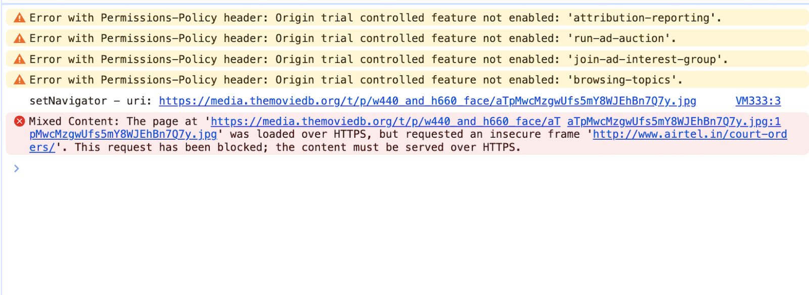

Are you guys using Airtel internet? I didn’t have this issue before and even now, when I tried connecting over 4G, the issue seemed to go away.
I am indeed on airtel fiber @@gourav

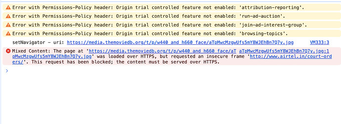

yes. first their API broken and not the website.
I have raised this issue with tmdb admin team. seem lots of people facing issues and the main guy who handles the website is not around.
[Update from tmdb forums](’
The image.tmdb.com can't open page - Talk — The Movie Database (TMDB)
:angry: :angry: :angry:
The website has been blocked as per direction/order of Hon’ble Court.
