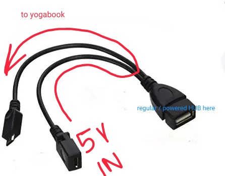

So I have this Lenovo YogaBook which has one micro usb port used for charging it. That is also the only available port which can be used for data transfer so you can attach an external hdd, etc. I was looking for a usb expansion hub with at least 2 usb ports which can connect to the micro usb and do data transfer and charging the YogaBook simultaneously. The closest I could find is this splitter cable but that gives only 1 usb otg port -

What do you think? Will this work?

The splitter cable mentioned by @@john1911 is the one I mentioned in my first post but it gives only one OTG port. I need at least 2-3 ports while able to charge simultaneously. If I couple that with the Transcend hub plugging it into that one OTG pprt, will that work ?
