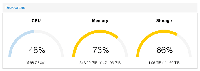

I have a few Proxmox clusters at home, the highlight of Proxmox is in it’s ability to cluster separate boxes for redundancy and high availability.

I have two other clusters, one I cannot share as it’s Chia (XCH) farming cluster that I maintain on behalf of clients.
The other is a passive income cluster that’s basically an extremely overbuilt and overspecc’ed phone farm:
On my todo list, I need to setup a Proxmox Backup Server. Everyone who uses Proxmox highly recommends it. I have no backup system in place, but the VM’s are spread across enough nodes that I’m alright with the resiliency that that brings.
I have 32TB of writes over 150 days with the same drive as yours, but that’s on a node with ~190 VM’s. This ends up being an average of ~200GB per day. I try to keep the SWAP usage below 1GB on this particular node.

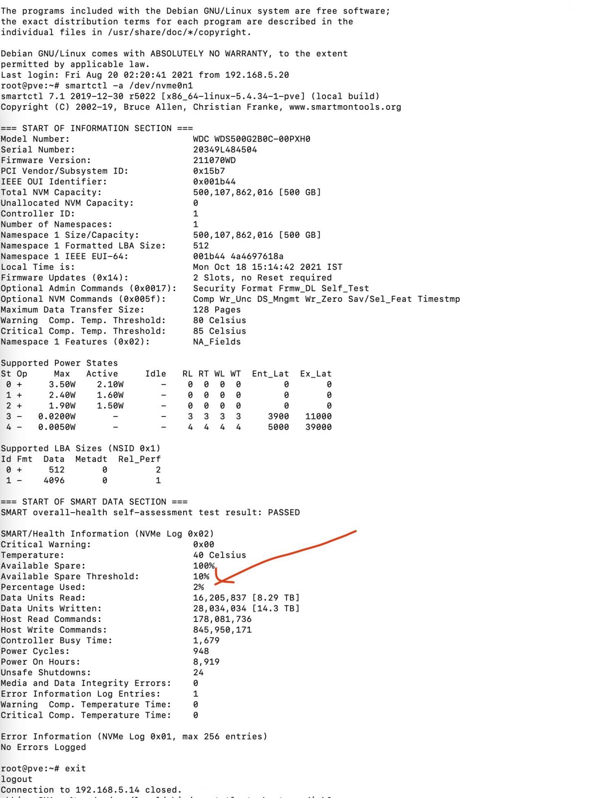

Can you post screenshot of the Smart data ? Cause I’ve read multiple threads that said get enterprise SSD or atleast premium ones like samsung evo plus with dram.

nothing fancy - just a regular WD SSD.
and its a default install.

Your drive has a 300 TB endurance so that makes sense. I guess my writes are also high cause I’m installing a lot of stuff right now?

300TB endurance is the minimum you will see these days I guess..
The SSD on my MBA is at 1% after 25TBW so probably looking at something like 2000-2500TB endurance
AT a minimum, this WD should last 15 years or more which is way more than I can imagine using it for.
