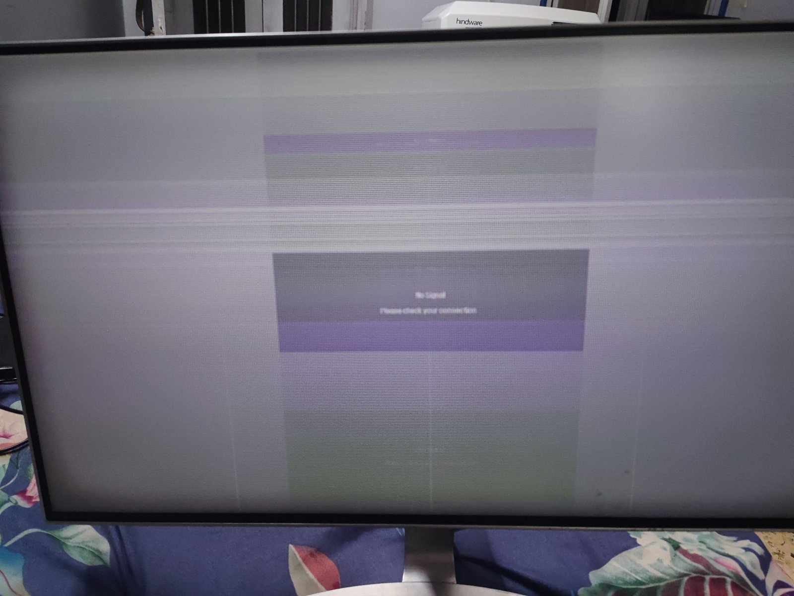

I recently lost my LG 24MP88 24" IPS Monitor!
The monitor was 5 years old but was in a top condition. However suddenly there was some issue in the monitor which I cannot describe, so screenshot attached below.
Kudos to LG for superfast service though, I raised a service request ticket on Friday evening at around 7 and LG engineers came to my home next day before 12.
They tore-down the monitor and came to the conclusion that the display is done with and that it is possible that it is due to voltage fluctuation and it can also be due to static and neutral electric port.

I face a similar issue with an LCD TV a couple months back. Similar sort of banding was seen on the screen and it was fixable since the issue was on the PCB of the LCD panel and not the panel itself.
Try showing it to some TV repair shop perhaps?
As for safeguarding against Voltage fluctuation a UPS may or may not do that always. Depends on model I think, you need to do some research on what model you’re gonna buy but I don’t think this is caused by that as these work on DC and very low voltage, it can be due to just age and dust perhaps as was the case with my LCD TV which completed 12 years.

I’ll get the older one checked anyway! You don’t think that LG engineers diagnosed it correctly?
TBH I just think they did their job as fast as they could to close the ticket. They earn money per closed ticket even if no repair work was done. They could be genuine too though.
Local repair shops will try to do a thorough job and may possibly tell you even before opening if it’s repairable or not and the charges you can expect if it is. Take it to a shop only if you’re interested in getting it fixed else be happy with your new purchase.

I’ll take it to a local shop, maybe if it gets repaired, I’ll have a dual borderless 1080p monitor setup :grinning_face_with_smiling_eyes: :grin:
