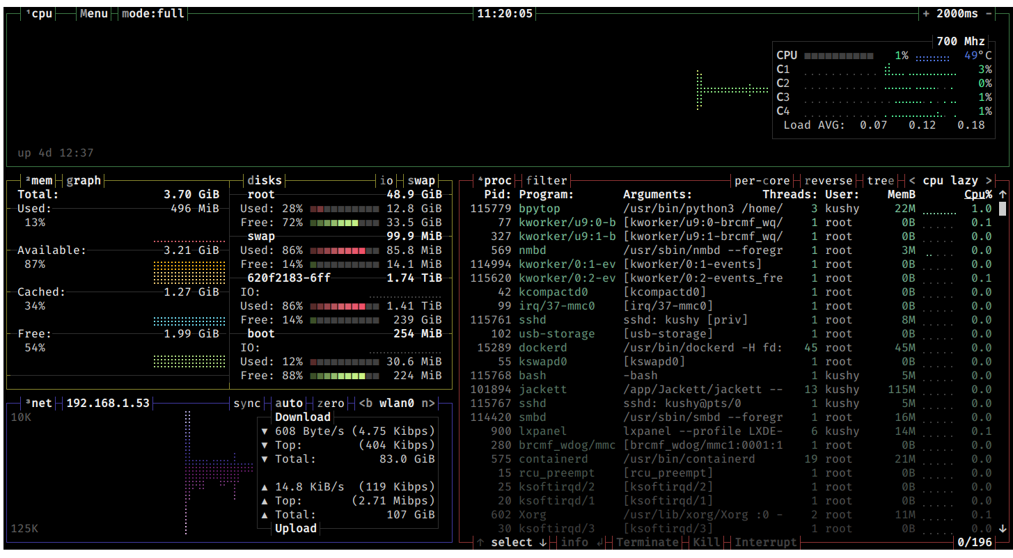

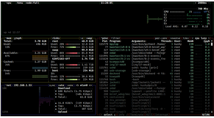

attaching the bpytop screenshot for reference, load average currently is ( 0.04, 0.11, 0.18 ). Any help on how to diagnose the issue ?
So you are running Jellyfin on Pi4, and playing h265 content. The main culprit will be Transcoding, if your playback device does not support h265.
Pis don’t have a powerful GPU, so even 1080p transcoding is too much.
Playing on VLC over the network, could be speed issue, or could be Pi not able to keep up with data transfer (rare)
h.265 is absolutely supported, infact pi4 can transcode 4k h265 as well which ive tested successfully . Also as i mentioned that normally theres no problem in transcoding and everything is buttery smooth, but i get these periods of laggyness once/twice a month and not able to find any culprit for them
Try decreasing the swapiness value to 10 and make sure that you are not running that pytop if media is playing. Other then this, it is expected from Raspberry, as many people experience the same.

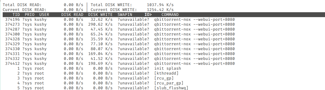

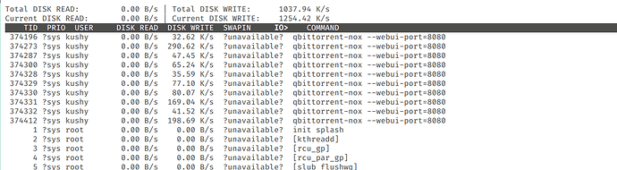

attaching iotop at the moment, which doesnt seem quite high, given that hdd is attached to a 3.0 usb port in pi
qBittorrent is writing multiple small chunks to different sectors of the HDD. A HDD is terrible at small random writes, scoring a few MB/s in that test, as the disk and the write head has to make frequent adjustments to reach the position.
If you check your “top” output you’ll see that your CPU is spending 50% time waiting for io operations to complete (49.0 wa).
To fix this, you can either mess around with qBittorrent write cache (but your choices are limited, as you don’t really have a lot of ram), or use a separate ssd for temporary download location.

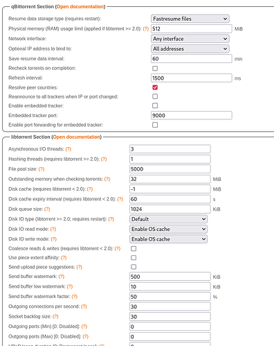

these are the IO section options available in bittorrent setting, which one do you think will help here ?
swithcing to ssd currently is kinda a budget breaker sadly
I’d try increasing the disk queue size, but doubt that would improve a lot. qBittorrent (libtorrent) has deprecated “disk cache” option, so I don’t believe you can set it now. In the earlier days we would increase the disk cache size to a few GBs, depending on the available memory, and disable OS caching policy.
You can also try setting temporary download location to your micro sd, but that would limit your download size to whatever free space you have in your sd card, and also wear it out fast.
