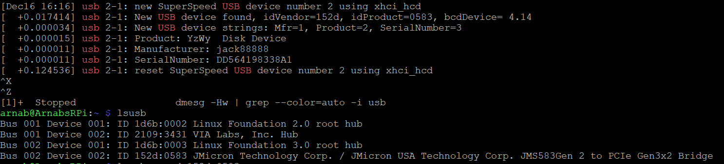

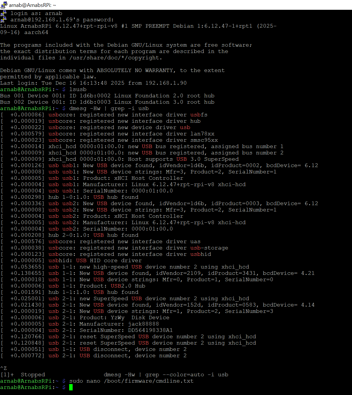

Man I can’t even see the ssd under lsblk or lsusb. Logs showing i/o error.

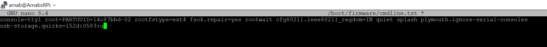

Dang. Get USB VID PID and force a storage quirk to force BOT mode ie Bulk Only Transport.
Share the IO logs whatever you are getting. Will help.

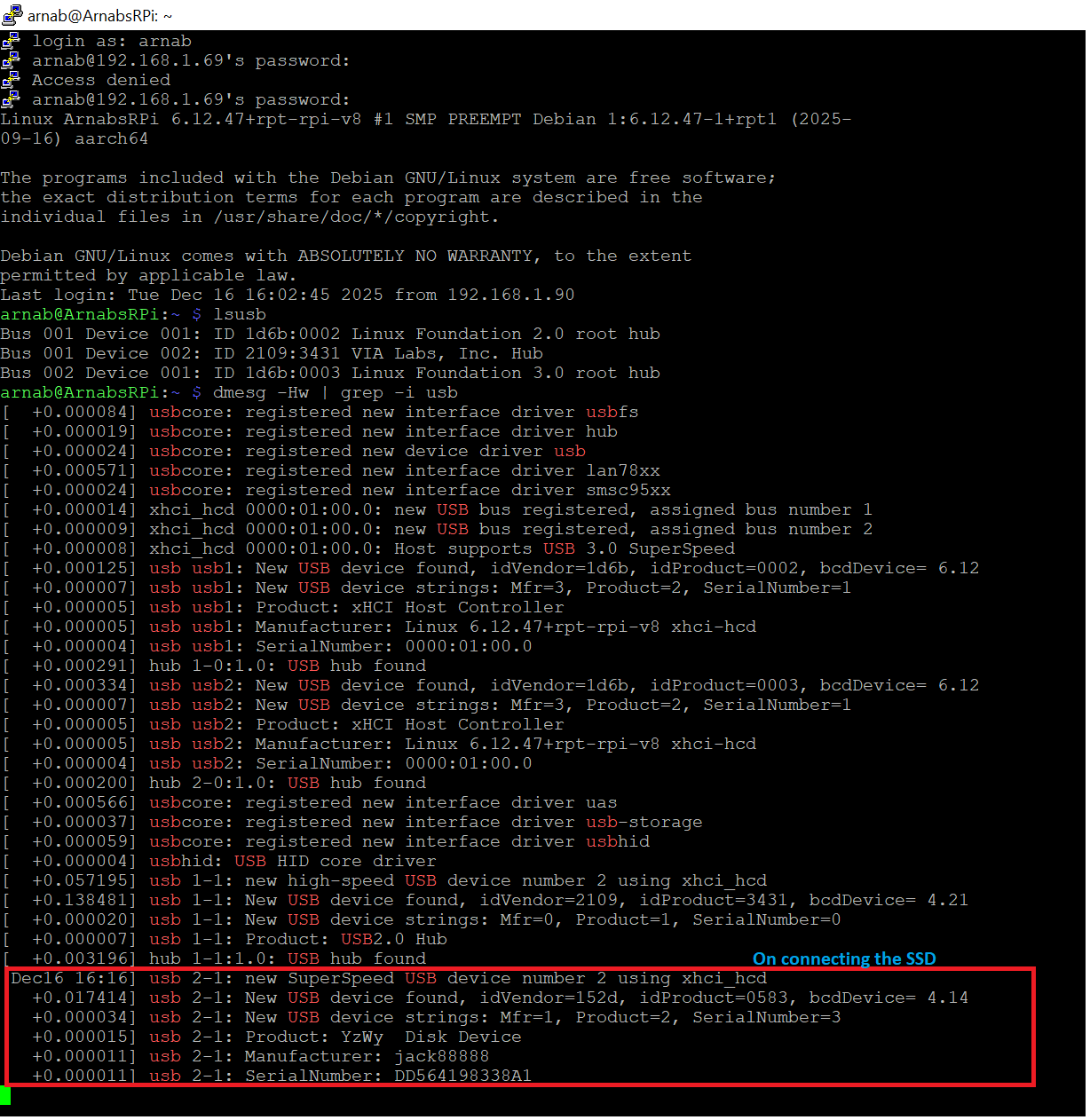

  1. Ok so i shut down the pi, disconnected the SSD from the USB and turned it on again
    Then I connected the SSD and this is what appears.
  1. i could get the USB VID PID and edited the config file to force Bulk Only Transport

  1. rebooted the pi but after it restarts, the usb is again lost (the config file has retained the new edited part)
on reboot, could not find any specific i/o error (or maybe i am not reading it properly?)
journal command output (output was too big to be pasted here)
