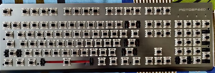

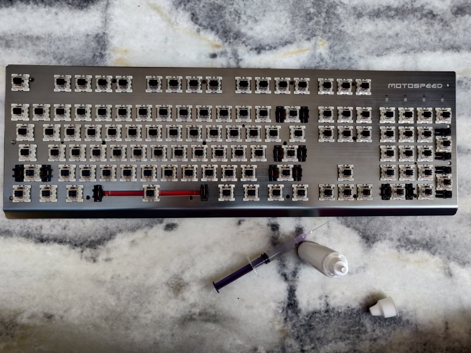

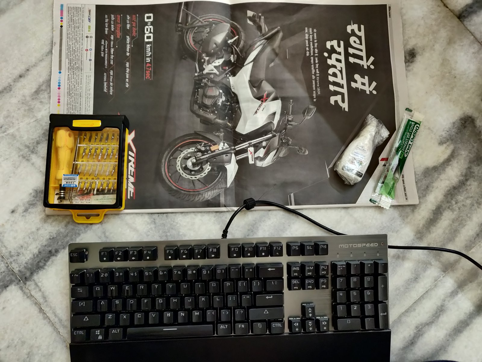

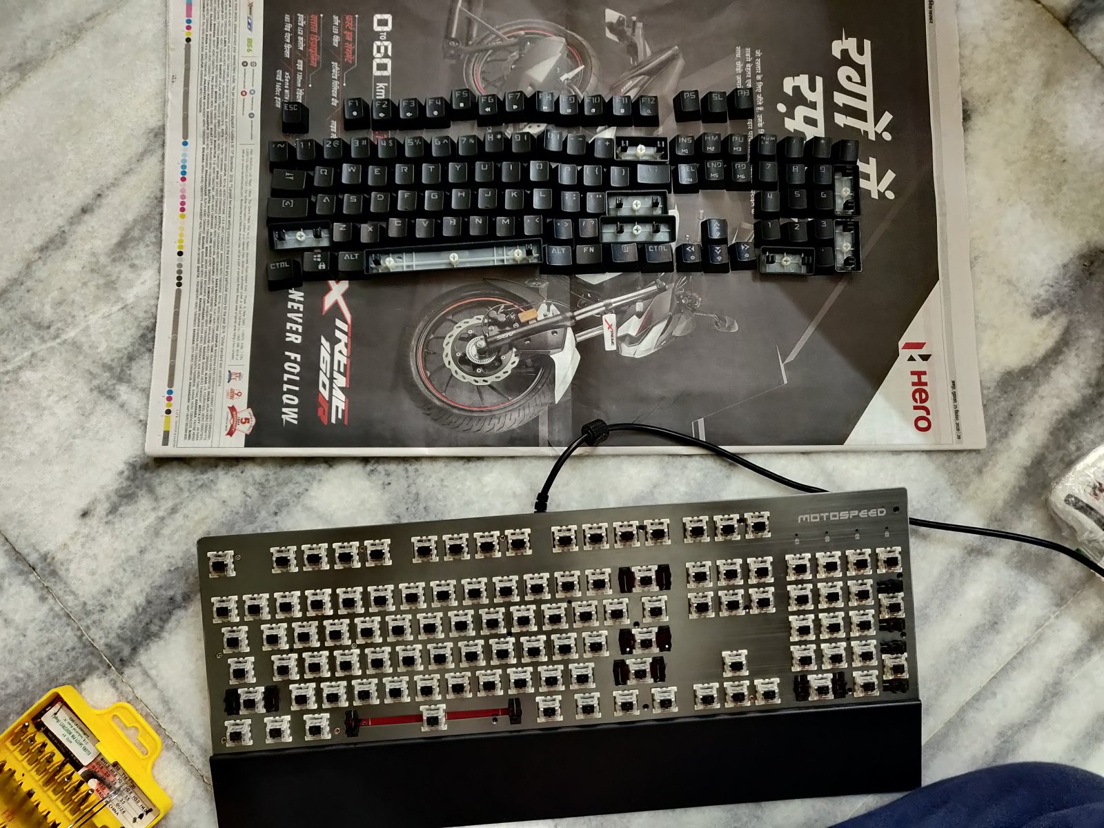

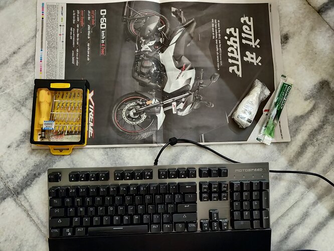

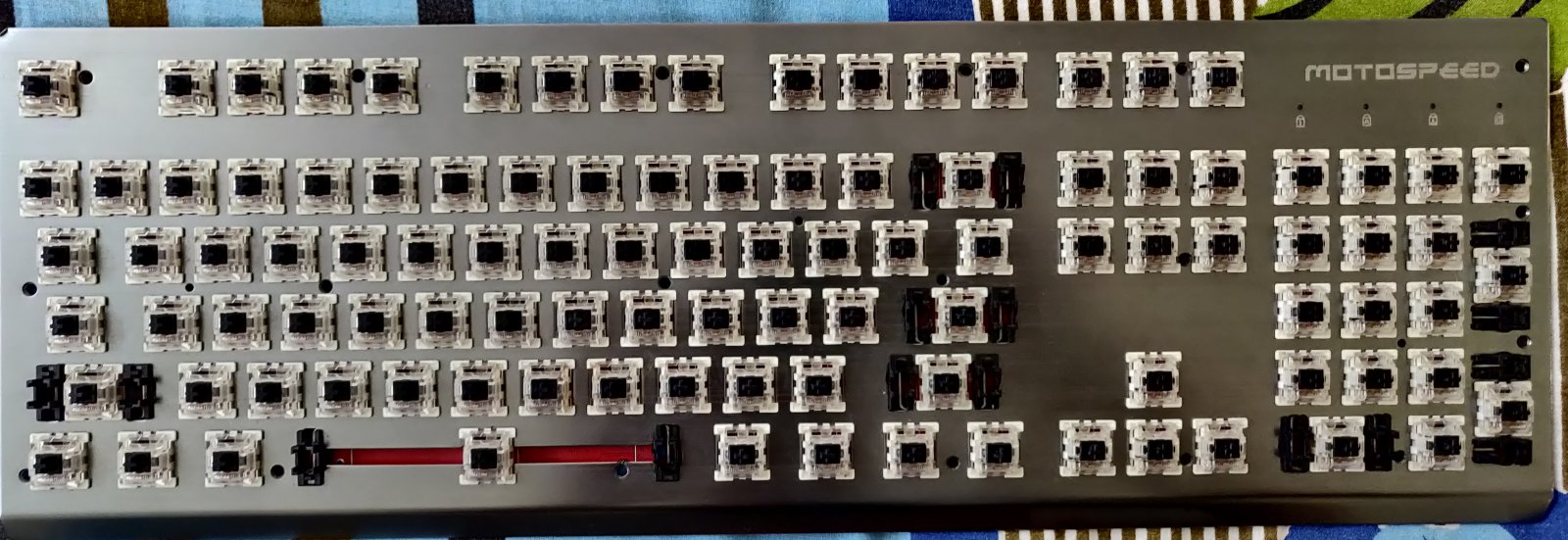

I myself bought a second hand motospeed ck 108. It has outemu black switches. Keeping de-soldering my last resort. I’m also thinking of getting the same lube and applying it as much as I can without de-soldering the keyboard. Will post the results here.
You can get this sheldons lube
https://www.amazon.in/Sheldon-25ml-Silicone-Puzzle-Combo/dp/B01N674ME5
Fill it up in a syringe
Depress the switches and put a very small drop on each side of the slider. This lube is quite thick so it wont be very easy but hey this is the best solution given the situation.
It will not be as effective as fully lubing the switch but wt will work much better if you do not intend on desoldering switches.

If you ever decide on desoldering switches, just replace them with better ones. Watch this space :wink:
I’m sure that you must have the knowledge of this or have figured it out by now. I have some questions/doubts on changing the switches for my keyboard.
  1. My current motospeed ck 108 is an RGB keyboard. Will the new switches function the same way as the current one.
  2. Currently there’re 2 soldering points and both sufficiently surve the purpose of registering the key strokes and led lighting. Will I be able to find switches which work the same way?
  3. The cost and availability factor, I tried searching the switches (searched for cherry mx since they’re the best according to most people) on online platforms but couldn’t find on Indian ecom websites. And on other country ecoms they’re expensive.
  4. Is it worth it? Now the most important question. As you might know that motospeed is Chinese brand and even if I manage to change the switches to better ones, will the circuit board hold for long enough to recover the cost and efforts involved in changing the switches?
Please let me know your thoughts.

I ordered the silicone oil suggested by you 3 days ago and today it arrived. Decided to lube the keyboard using syringe method today itself.
Took me around and hour for the whole process. Pardon my photography skills.
Prepared all the required tools.
Removed the key caps and kept them in the same order so that it becomes easy to put them back.
Finally the keyboard is ready for the lubrication
The end results are very satisfying, the resistance which I felt earlier is gone now and keyboard also has become quieter now. Thanks to you @@SunnyBoi
