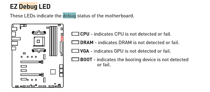

So in my New build i used MSI B450 Gaming Pro Carbon.
Every time when i start it up, the Red Light on the Mobo lights up for about 5 seconds before booting.
The lights are CPU, GPU & Boot in the mentioned order.
My System boots just fine and runs good to. The manual states that the light indicates faulty hardware.

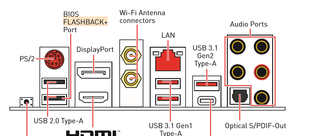

Can you check if any USB peripherals are connected to the BIOS Flashback USB port.
And as for the light I checked the manual and its CPU,RAM,GPU and then boot drive
Connected a USB Mouse & USB Keyboard in the USB 2.0 port. Specifically the mouse is connected in mentioned port
As for the lights, the light is mentioned CPU, GPU & Boot lights up, don’t remember seeing the RAM light blink
Don’t connect any USB device to the Flashback USB port as at every startup it will try to access the device on the port for BIOS files.
Did that. The Red Light still blinks, but i think it is the motherboard posting, now the Lights blink less.

3 blinks of the Red LED near the BIOS FLASHBACK+ button is normal.

My Mouse is also connected to the BIOS FLASHBACK+ USB Port. It does not make any difference even if I leave that Port alone and connect the Mouse to a different Port. This slow POST could be related to earlier BIOS version. Update the BIOS to latest version and check.
Well all BIOS have the options to skip certain tests while booting up. So instead try that.
I first removed the mouse from the flashback port, the blinks reduced to 15 sec.
I reconnected them to the flashback port the blink is still at 15 Secs.

So the Flashback port didn’t seem to have anything to do with it.

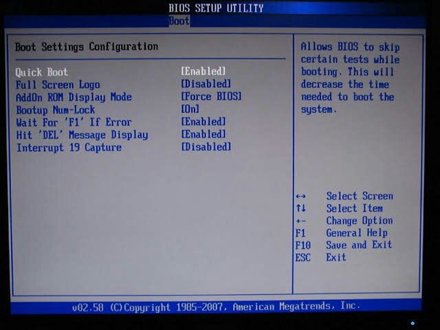

BIOS usually have a fast boot option to reduce boot time checking, is that enabled in your BIOS settings?

Thats what we are talking about reducing boot times. As I said earlier and even vishal, it is better to enable test skipping while booting. These tests are only useful while troubleshooting purpose if anything wrong with your mobo, proccy or ram.
Try that enabling it.

It may not guaranteed work in your case but no harm in trying as well as it is a SAFE setting and your bios settings wont get screwed up.

Yes, the BIOS FLASHBACK+ Port should not make any difference.

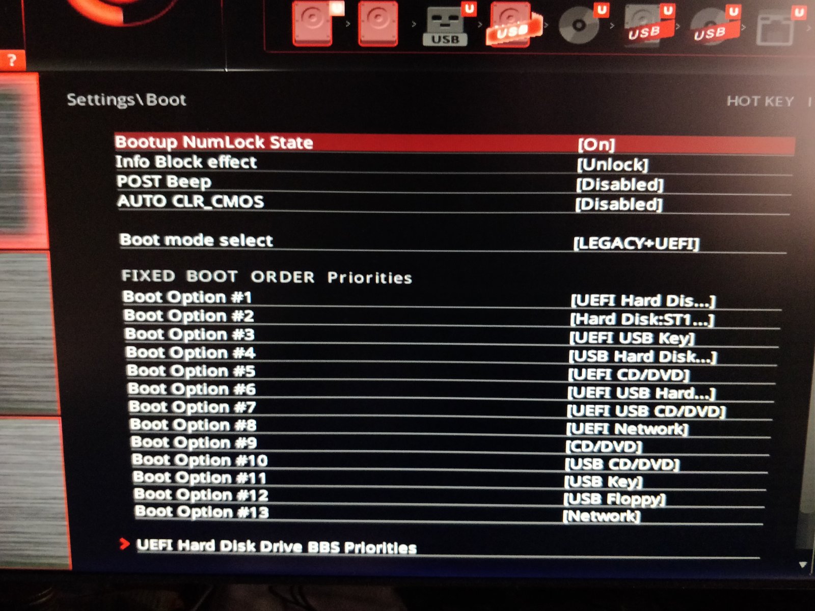

Could not find any such option
It’s the GPU light that stays on the longest.
This. In ufi this will be somewhere but sure it will be there.
Nope, no option
Yes, the VGA light stays on the longest and last to go off and this is normal. The abnormal behavior is if the light stays on and does not go off, in that case it indicates faulty hardware or hardware not connected and the Computer won’t boot.
