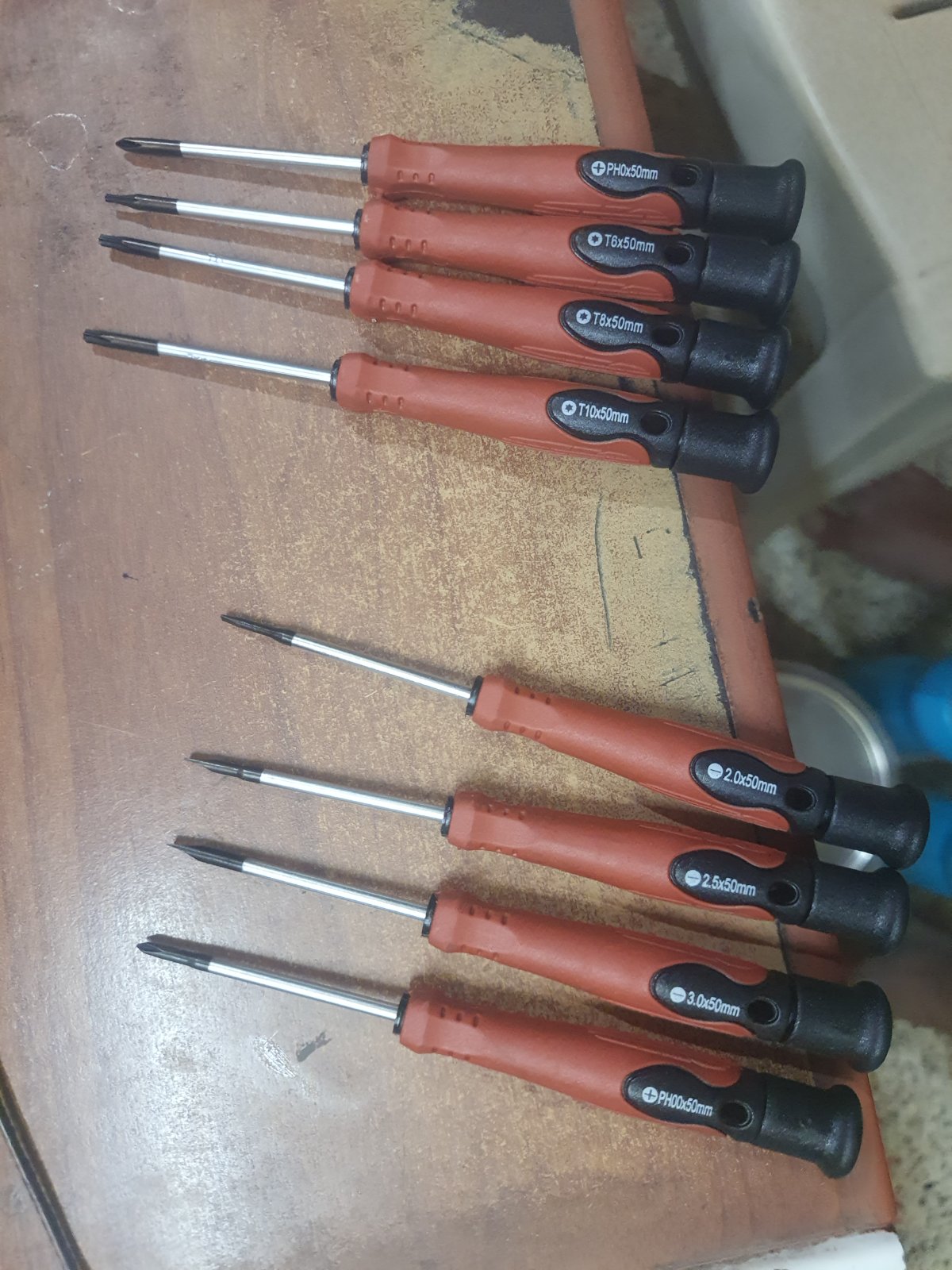

These are the precision screw drivers you get with that set.
Two are stubby which are basically smaller version of bigger ones. So it’s essentially only 6 big screwdrivers.
My One of the reasons to go for it was the screwdriver stand.
I had bought 39 pieces version + precision set for a total of 1340rs something.

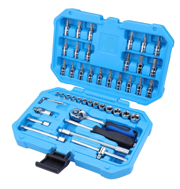

If you are feeling fancy and want to handle some bolts as well this 1/4 inch ratcheting kit is nice, though it is not a precision kit. But it does have common screw bits, and the ratchet can be very helpful in awkward places.
I am a tool pimp, I can never have enough tools.
