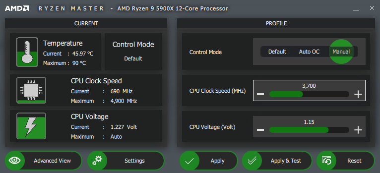

I am using Ryzen master. This is the manual setting I use for stablilty but when I change to default it crashes on Game load.
If you want me to change the CPU volt to 1.1v what should I keep the Clock speed to?
