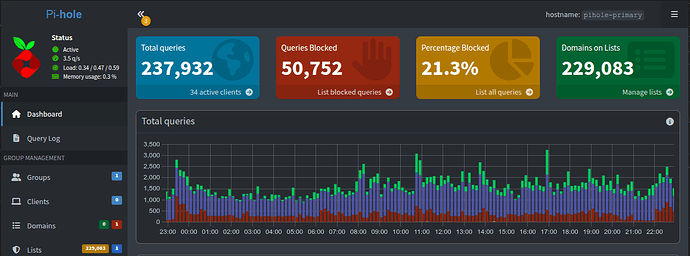

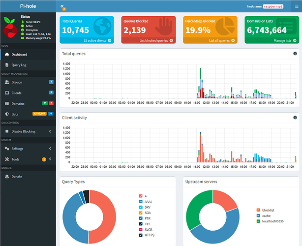

But nine months ago - I have made the decision to setup pi-hole in Raspberry pi which is one of the best decision, I have made.
Raspberry pi is powered through usb connected directly to Airtel router and any ad-hoc restarts will be in sync. There may be a chance of SDcard failure due to low power supply to pi but I am ok with replacing it when that happens.
After the initial setup and tweaking the block list never faced any issue and on the plus side It even blocks ads in hotstar.
DNS = Unbound + Cloudflare
Optional - setup log2Ram - reduces the quantity/frequency of writes to the SD card.
P.S : Suggestions are welcome.

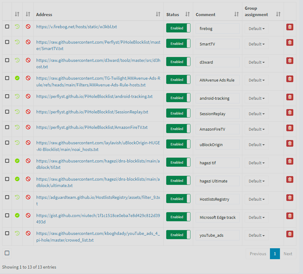

Adblock list

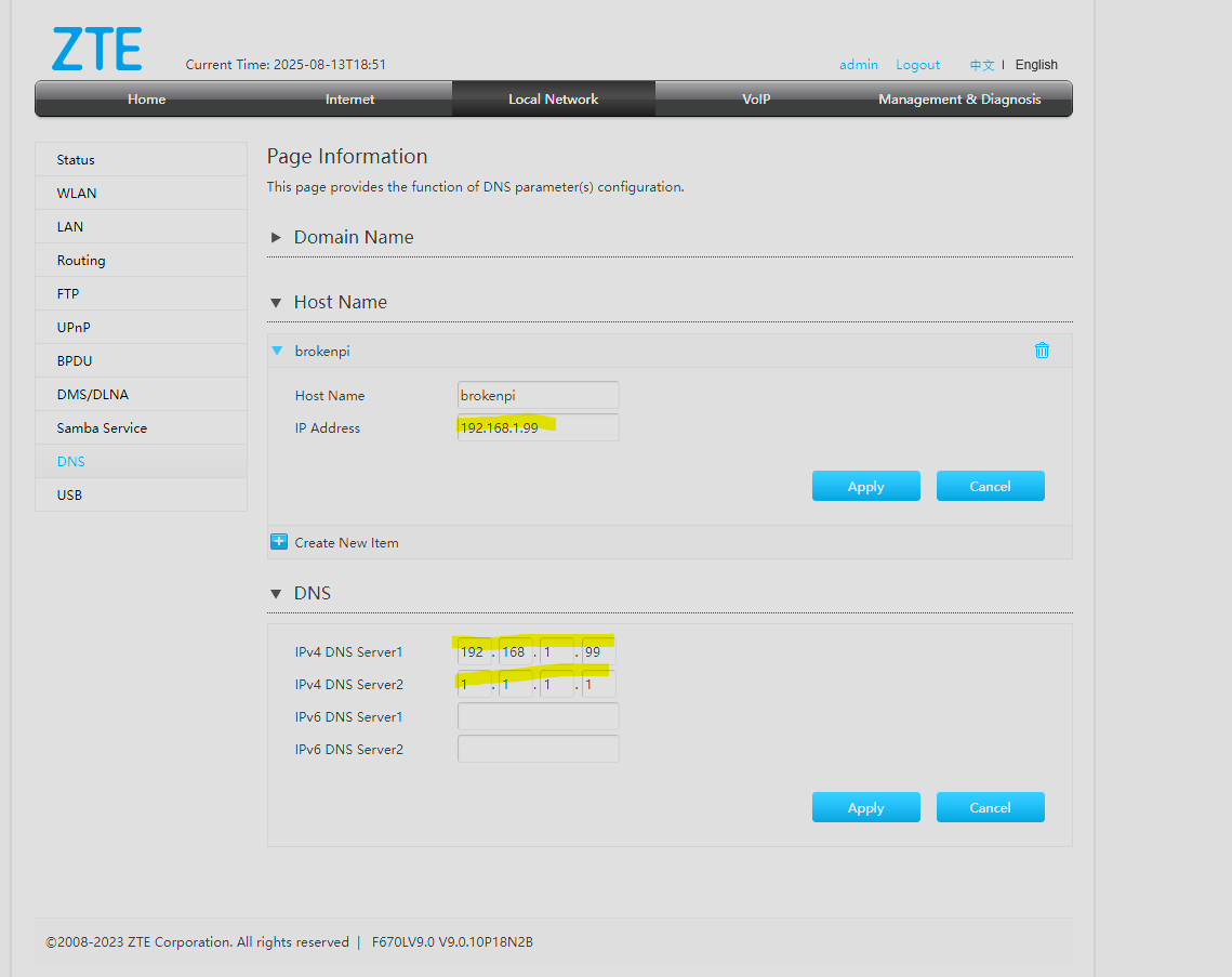

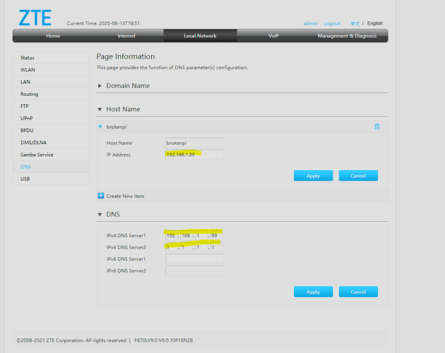

Router side changes once pi-hole setup is completed.
Optional - When i noticed some of the devices traffic uses IPV6 . i have also disabled IPV6 in router as I am not sure of the instructions to set it up and forcing all my traffic through IPV4 which is easier to setup . So far no issues faced.

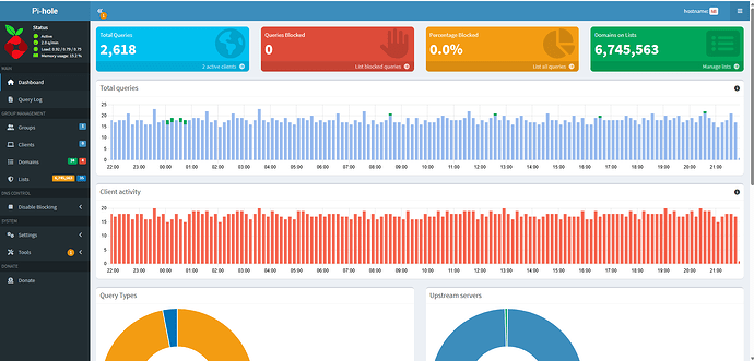

I have pihole running on raspberry pi zeroW for 5 years now. It has been my best investment yet.
I have adguard running on another machine as docker container for 1 year now.

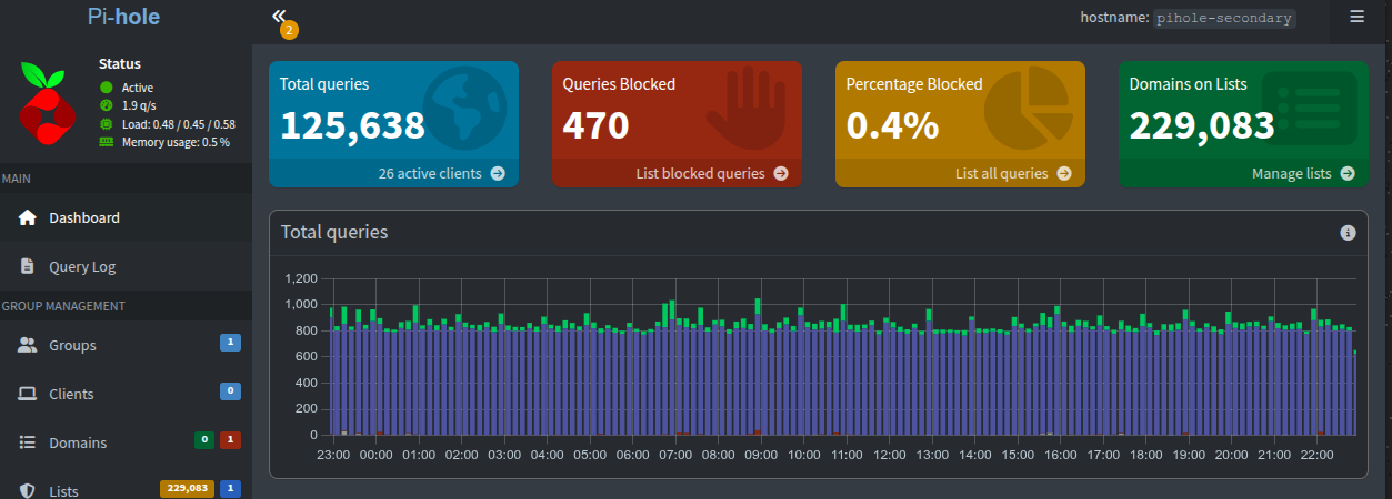

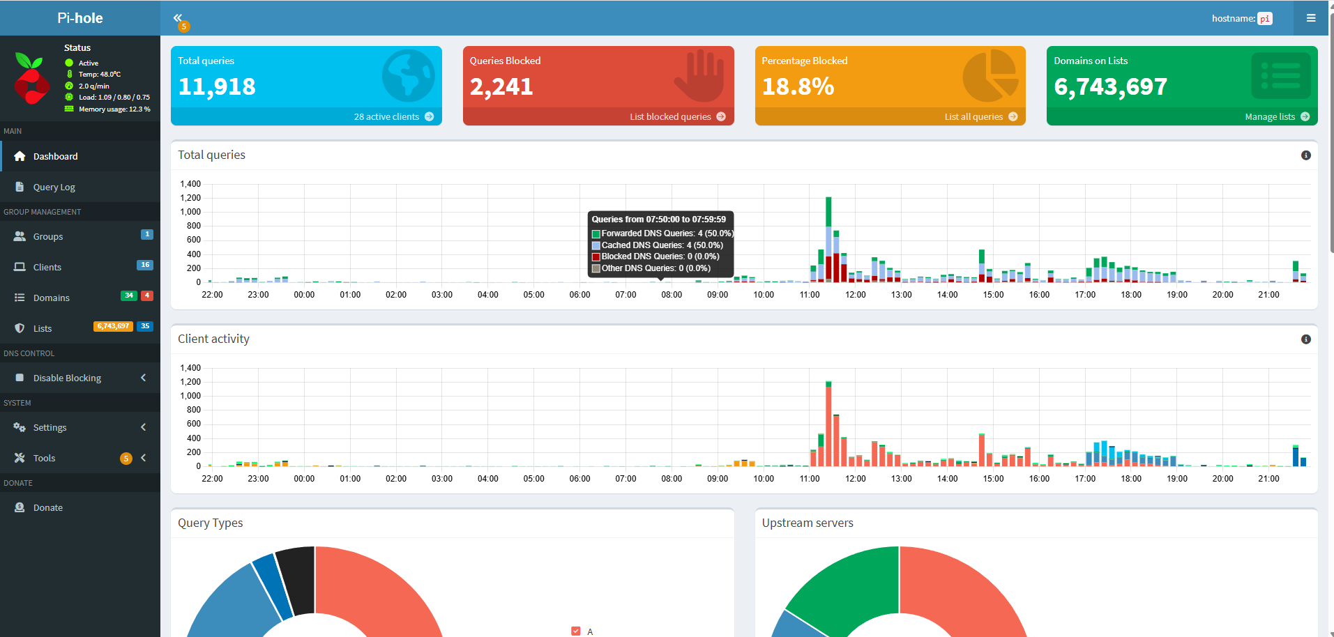

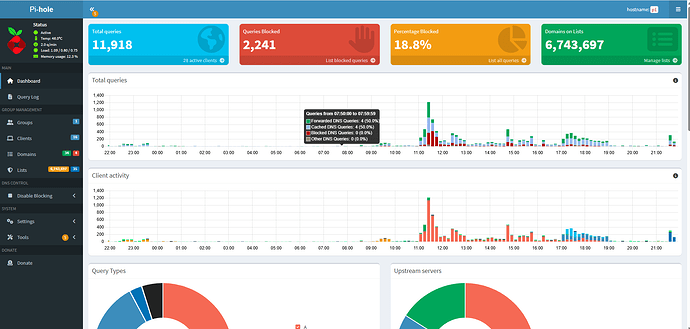

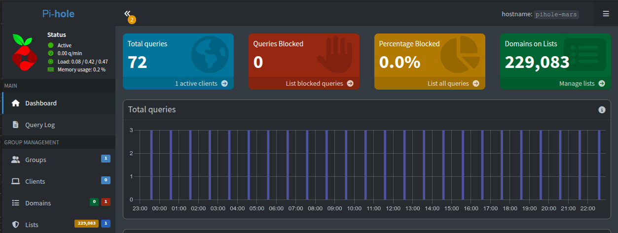

thought i’ll check what mine has been cooking
running NebulaSync to sync all the instances

On Raspberry pi 3B+ utilisation was in single digit until when I moved to log2Ram to reduces reads/writes frequencies to sdcard which now utilisation sits at ~25%

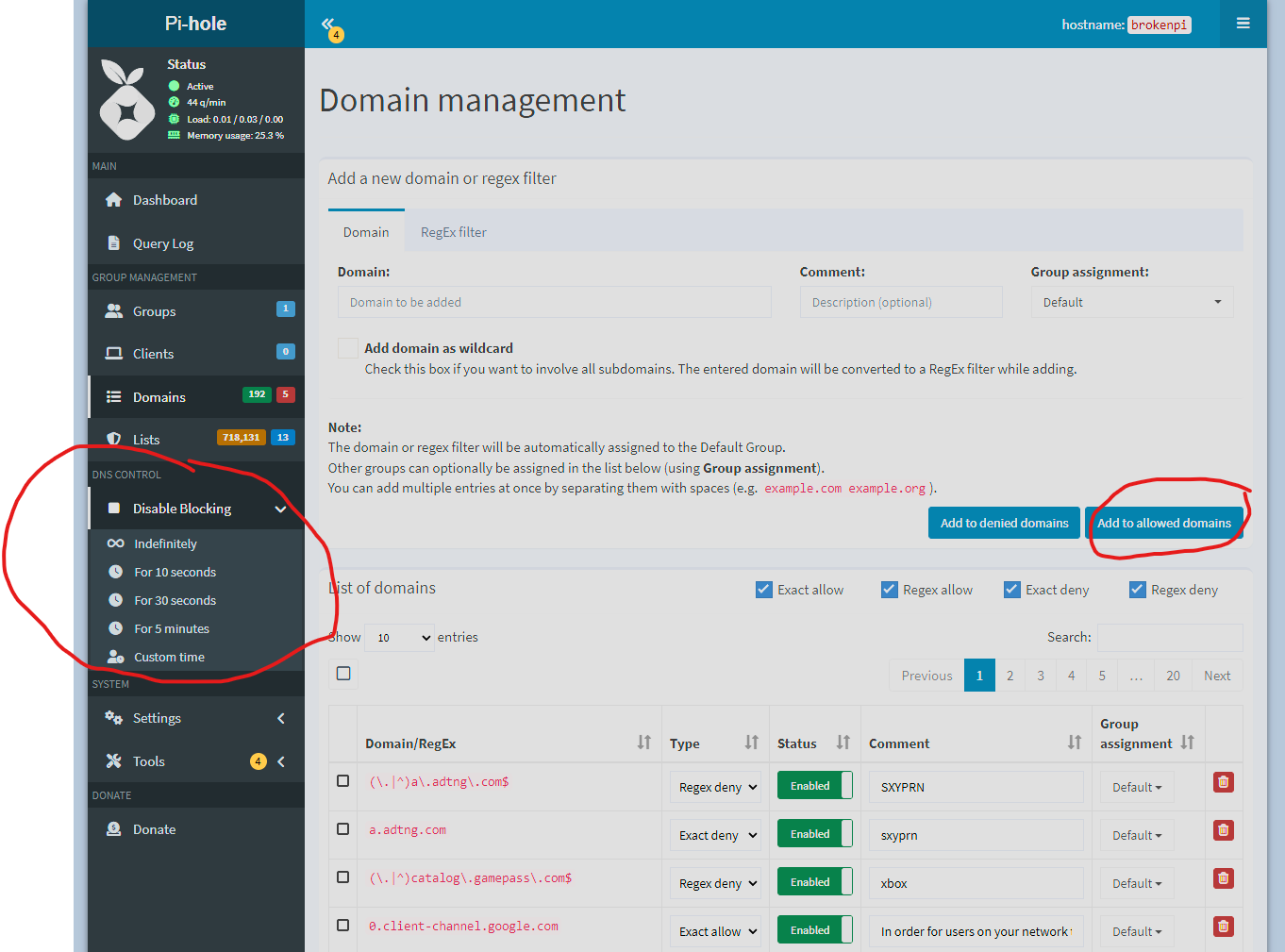

This concept is good, but what do you do when few websites don’t work as expected bcz of this blocking?

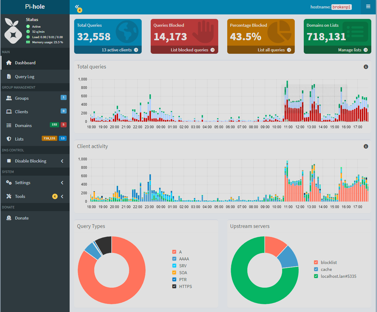

I use a similar setup, wit h 3 pihole + nebula sync, and use keepalived to provide 2 VIPs for primary and secondary DNS. The 3rd one is mostly inactive except for healthchecks.

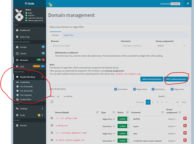

  1. add to allowed domains
  2. disable blocking - which disables pihole based on your selection
