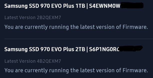

I have two 970 Evo+ drives at the moment. The newer one (Manufactured in 2023) still uses the original Phoenix controller and the other (Manufactured in 2021) has an Elpis controller from the 980 Pro.
It seems that during COVID, they swapped some components (might be limited to some batches as the recently manufactured drive still uses the original controller). You can refer to this [Reddit thread](’
https://www.reddit.com/r/pcmasterrace/comments/pmvc9k/samsung_970_evo_plus_ssd_hardware_revisions_does/
) for more details.
Some personal observations:
  • The firmware of both drives are up to date in Samsung Magician but displayed versions are different (Ref attached pic).
  • The Phoenix based 970 Evo+ runs hotter. The observed temps are similar to a PM981a (OEM equivalent of 970 Evo+ and also Phoenix based).
  • Some are reporting that the Elpis based 970 Evo+ runs hotter but that’s not true in my case (Both at idle as a boot drive and under sustained write).
  • The Elpis based 970 Evo+ benchmarks are practically identical to a 980 Pro installed in a PCIe Gen3 slot. It has a nearly 3x larger write cache but after it fills, the write speed is like 40% slower compared to Phoenix based drive.
  • The Elpis based drive was bought used and had a small number of media integrity errors. After I updated the firmware, the error count did not increase and it has been rock solid for about 10 months now.
I am suspecting that the Elpis based 970 Evo+ units which shared components and firmware code with the 980 Pro might have also been affected.
