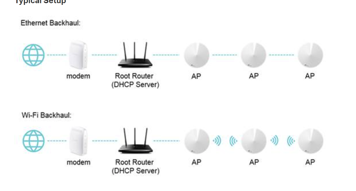

Illustration from TP-LINK
This is exactly how I have my Decos setup at home with Wi-Fi Backhaul. I have disabled the WiFi at the router and setup the 3 Decos as AP.

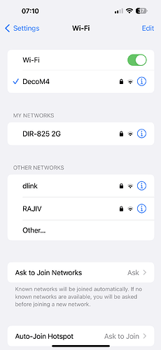

Great. Thanks. It did work. But after configuring. The dlink just shows 2ghz and not 5. Any help ?
I think there is a dedicated wireless band for wireless backhaul. I don’t remember where I read it though. I might be wrong though.
How did you connect the devices? MODEM - Deco - DLink (in repeater mode)?
no. modem - dlink - deco ( deco also in router mode)
You shouldn’t have two routers on the same network. Your setup has 2 DHCP servers and it is DoubleNATted. It might not matter much though.
To put the devices in current configuration, I’m assuming that you didn’t have to change anything in DLink. So how come 5GHz stopped working in DLink. Did you change some settings in DLink?
No didn’t change anything. Dir is the dlink router
