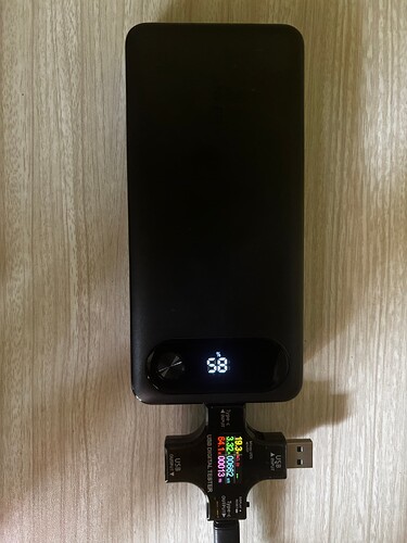

I had picked it up for 4.5k during the recent sale to primarily use with the ROG Ally after deciding to not go ahead with a battery upgrade kit. Usually test things after purchase, so thought I will click some pics to share the same.

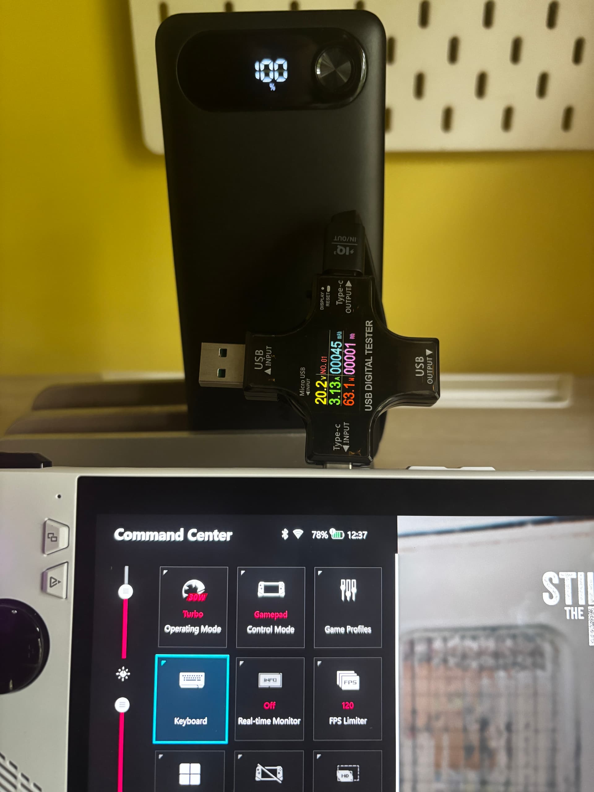

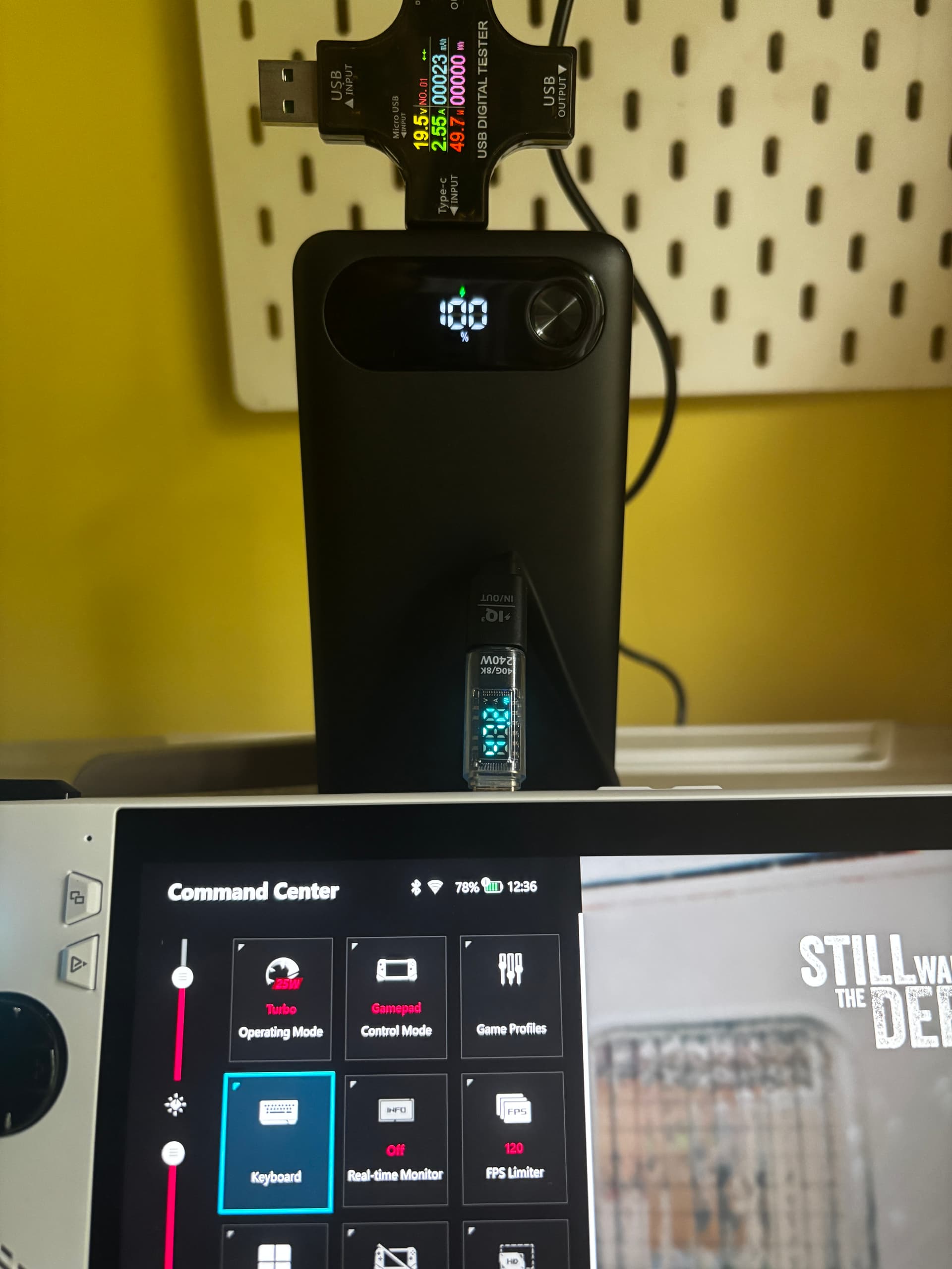

As a power source, it is able to output at 65W, so the Ally can work in 30W Turbo mode.
It supports passthrough with not much loss, but the power difference is enough to drop the Ally to the 25W mode. Don’t really have a use for this mode as I would either use it from the power supply directly or the power bank, not both.

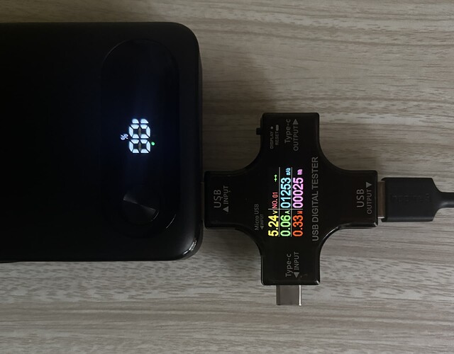

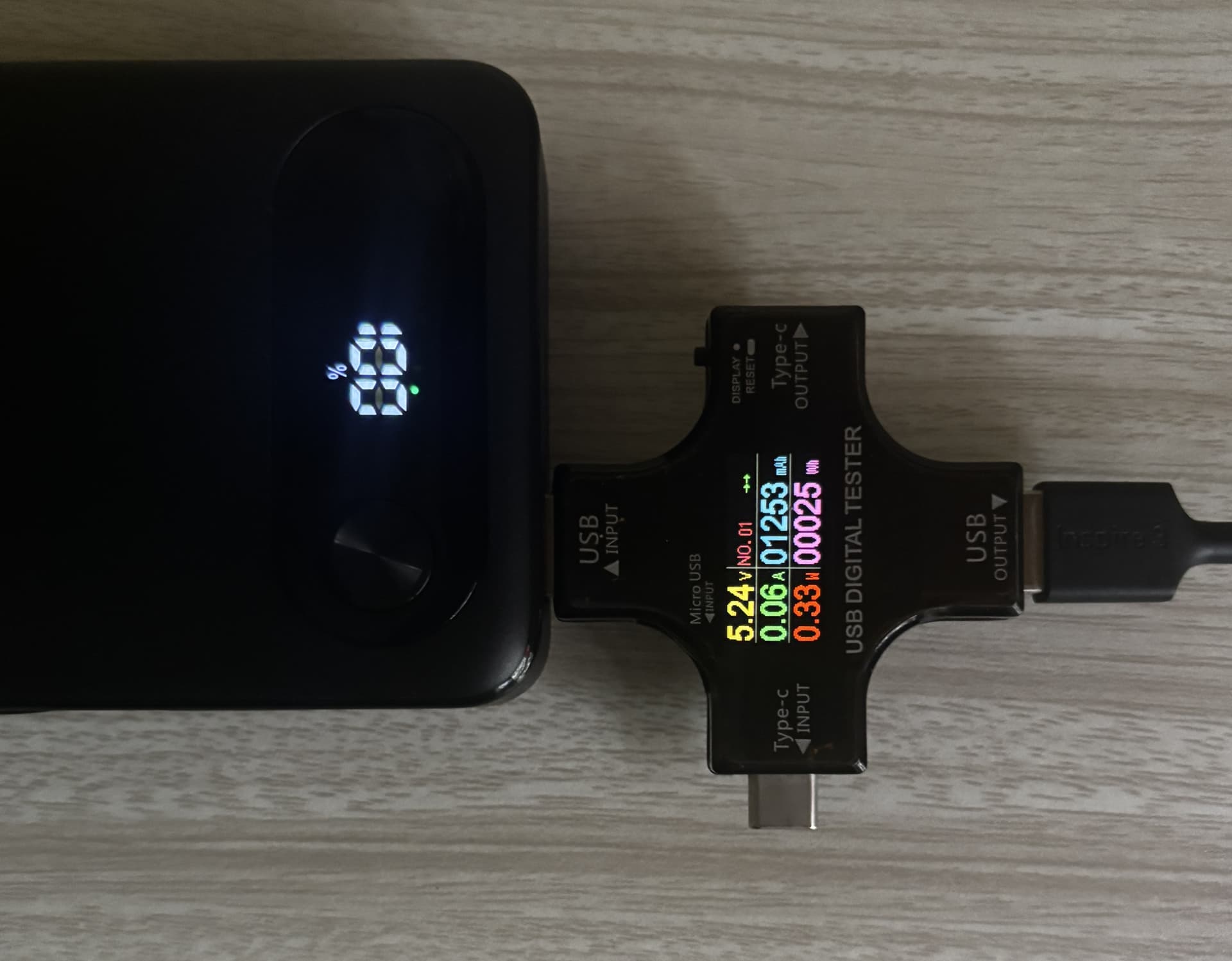

It starts charging low power devices when connected, but shuts off after about a minute. So the power button has to be double-pressed which activates the low power mode which then works fine.
Didn’t specifically record the full charging time yet, but it pulls in 65W when charging even to a high percentage, before levelling off to a lower wattage.

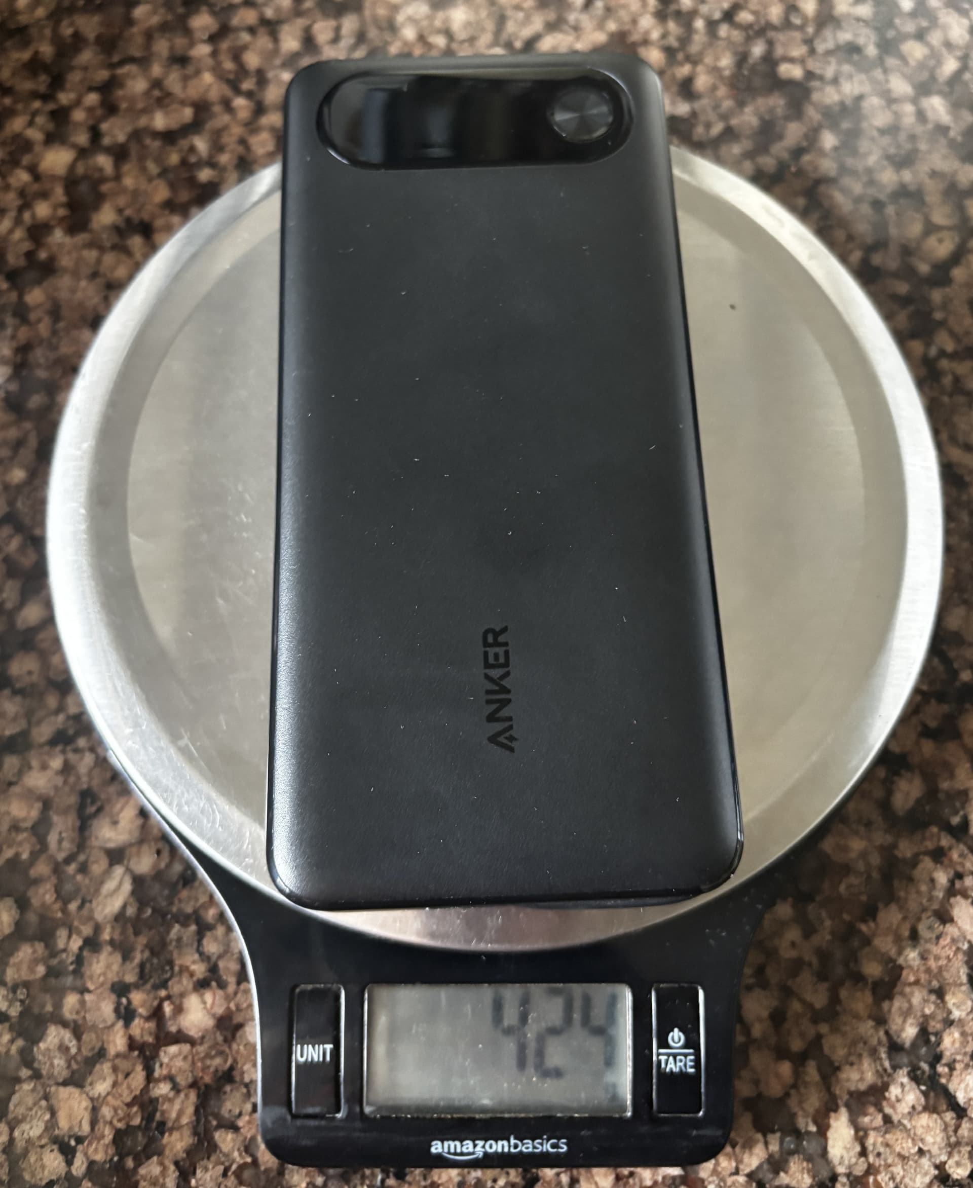

If you consider the weight alone, it is substantial, but then the Anker products are much better built when compared to something coming from the likes of Xiaomi.

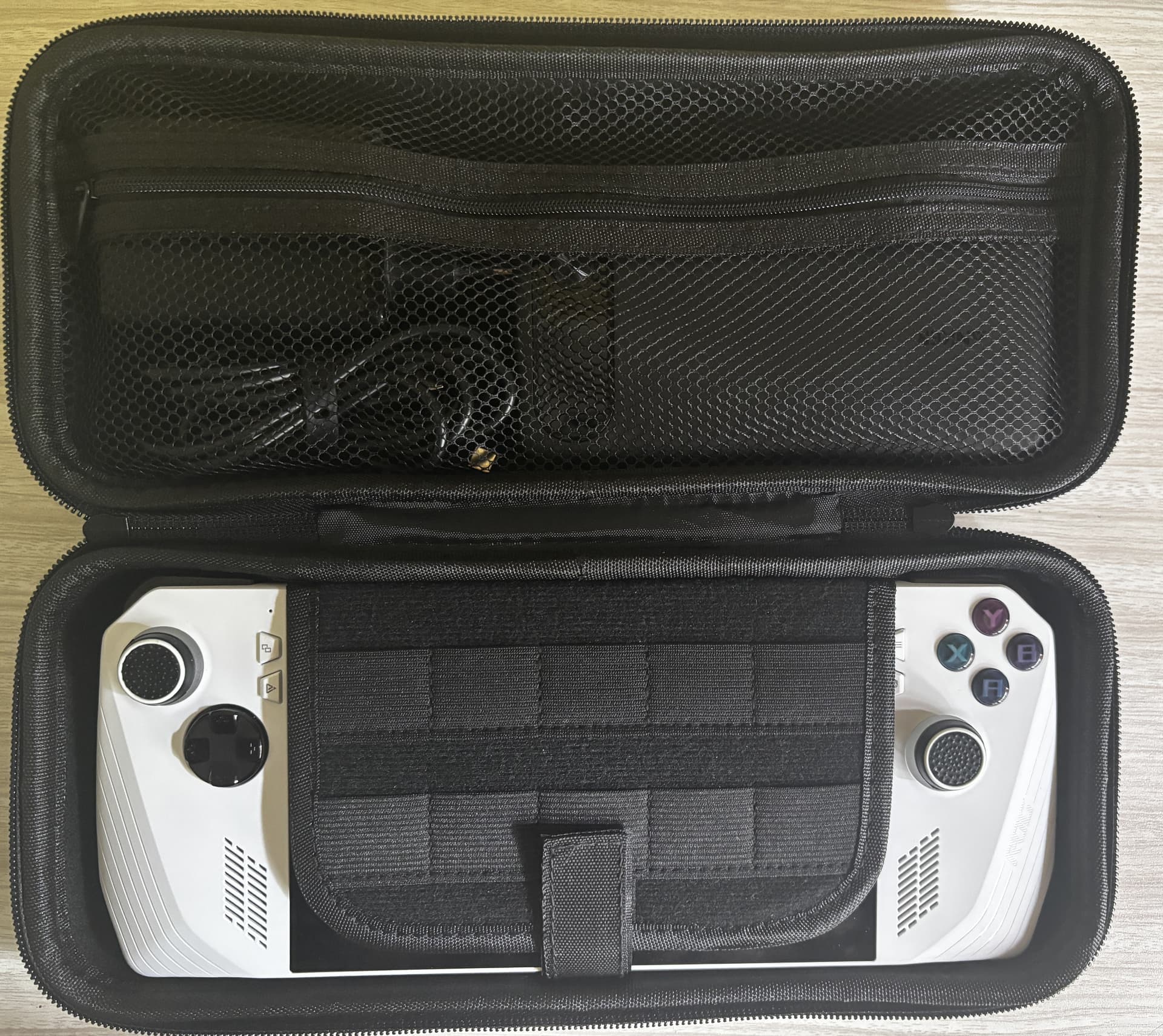

However, it fits fine within a generic case Ally along with a USB-C charger.
Overall, I would recommend it for the sale price considering its versatility.

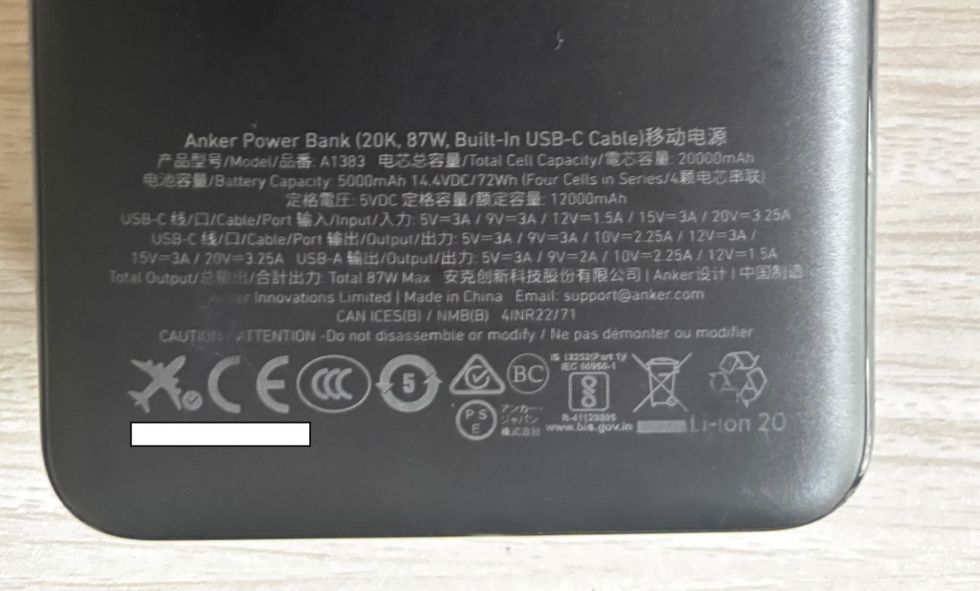

The USB-C port also supports 65W output. Here are the specs for reference.

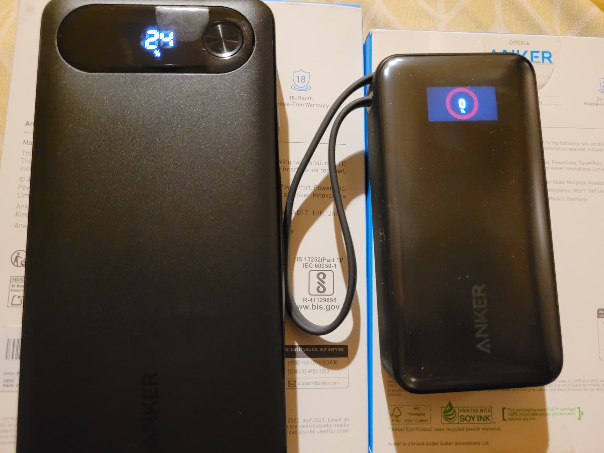

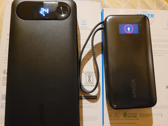

Parcel arrived :grinning_face:
Curious Anker ships powerbanks at such a low power level.
25% presumably
Is that the ideal level they should be stored at long term if not used :thinking:
The smaller one showed 25% then suddenly dropped to 0%. The import date is Aug 2024
The bigger one was imported May 2025 so held on to its charge.
Off to the charger they go. Let’s see how quickly they too up
Mine was exactly at 20%. I had seen some reviews where it was again at 20%. I think the normal recommendation is to keep it at 40% for short term storage, probably a bit lesser for longer term storage.
When I hooked the A1259 up, it jumped back to 25% and started charging from there.

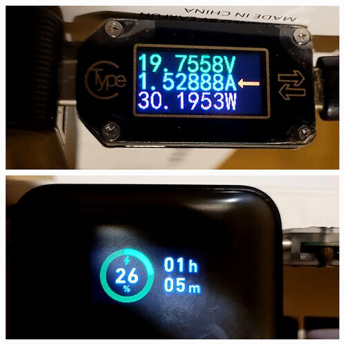

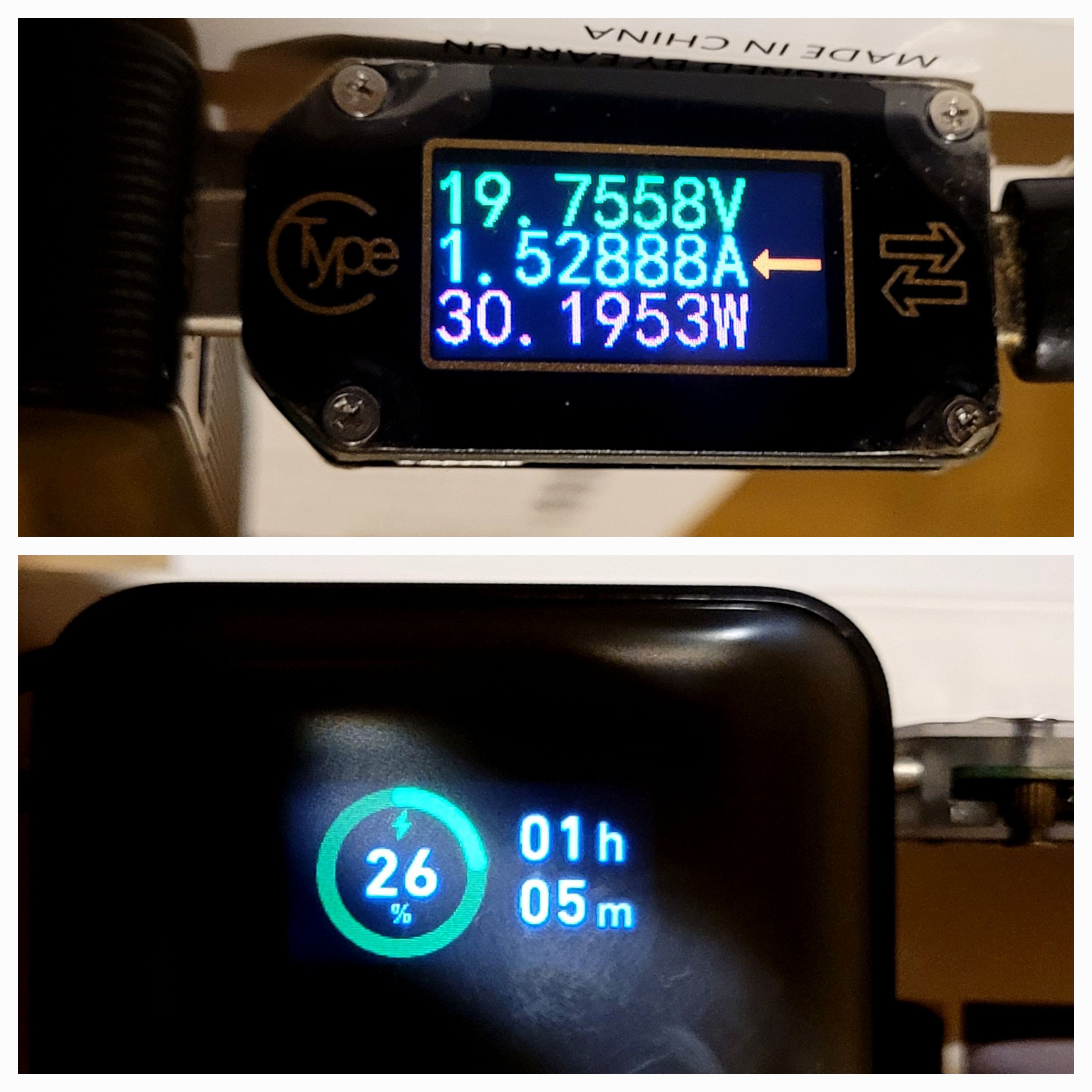

Glad to see it taking in a full 30W. Took a couple of minutes to negotiate that rate
Just over an hour to charge up :slightly_smiling_face:
This from a 100W laptop charger.
The real surprise will be to see similar charge time with the A1383.
Normally for a 20,000 mah powerbank that’s a 5h+ wait with 20W going in
