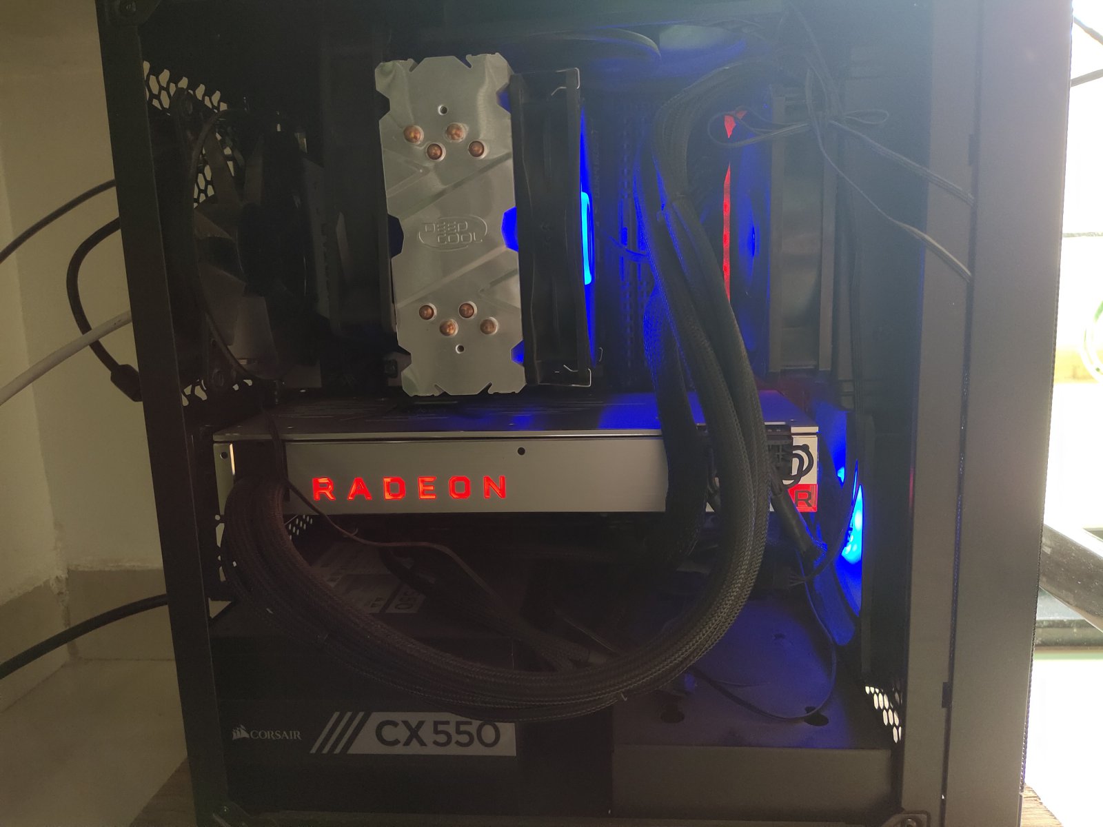

I have this cabinet, using this since March. Not sure how portable it is, but I bought it for its compactness since I had space restrictions, plus this seemed to be one of the best MATX cases. Houses a 3600XT, Vega 64 Liquid, MSI B450M Mortar and Deepcool Gammaxx V2.
Also houses 1x Arctic 140mm on top as intake, 1x pre installed fan as intake on front bottom, Vega AIO configured as exhaust up front on top with the other pre installed fan as exhaust on the radiator, and another 1x120 exhaust on the rear side. Can probably mount another 90mm fan on top if I was using an AIO for the CPU as well, but then would have to settle for a 120mm aio installed in the rear.
Temps and airflow are quite good, GPU maxes out at 65c and CPU at 70C under gaming (RDR2), although pre installed dust filters are a bit flimsy.
And though it feels well built overall, I don’t think it can handle much abuse since the metal sheet used is quite thin and bends quite easily. Also good to see a fellow member from Navi Mumbai!

Sharing pics is not an issue, but my (non existent) cable management is haha. Take a look at attached pic. System is currently running rn so this is best I can do presently (just took off the side panel and clicked pic), and things are pretty crammed in here. Building was a bit of a pain die to the huge GPU, but otherwise it was fine.
Is the HDD caddy removeable ?
Not intended to be removed, but it can be if you have appropriate power tools. I had originally planned to remove it but kept it after all since I have non modular psu, and tucked the excess cables in it.
You can check reddit to see examples where people have removed the hdd bay.

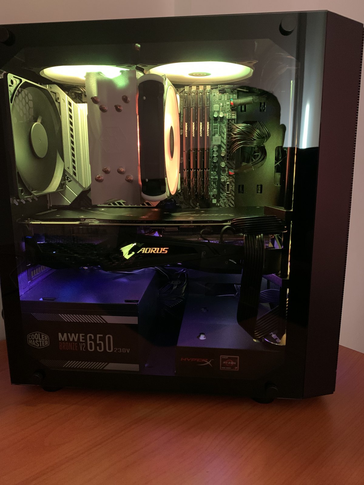

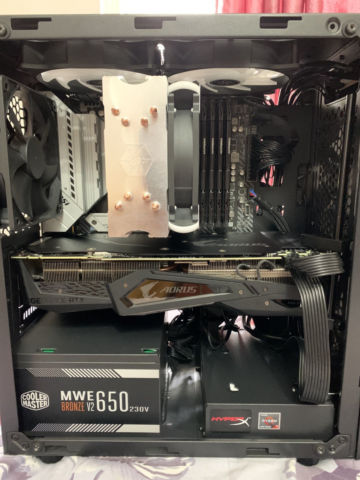

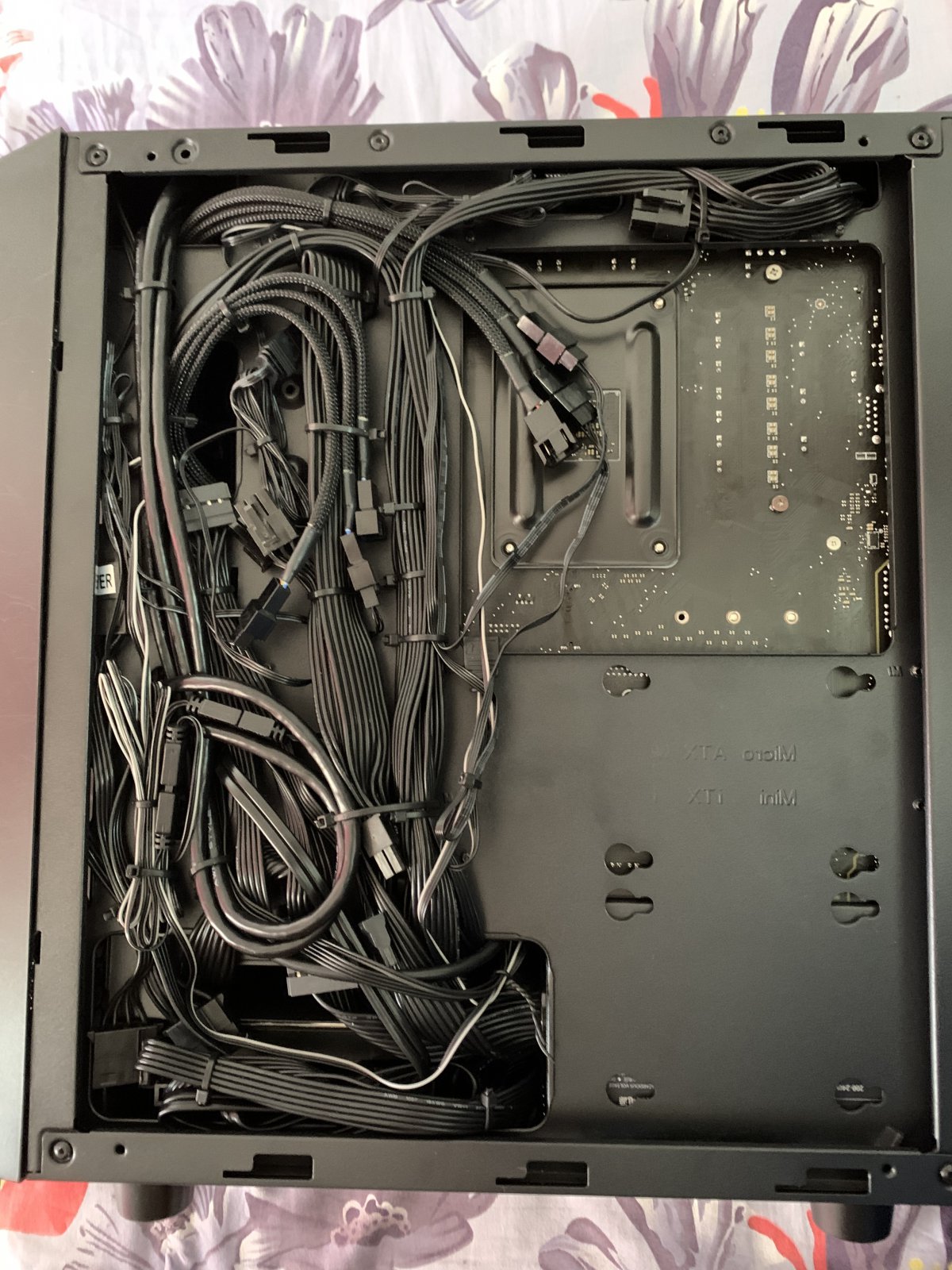

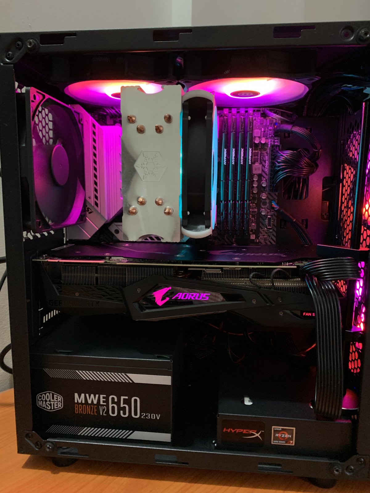

I made a build using this case recently, the quality is pretty decent and the included fans are fairly quiet. The glass on the side seems sturdy but definitely use a lot of padding for travel. I got a vertical GPU brace and clamped both both top and bottom of my GPU to avoid damage when moving my chassis to and from a friends place on weekends.
A few things to watch out for is the minimal space on the rear for cable management especially if you aren’t using a modular psu and don’t want to have too many visible cables in the front like me. The other thing is the CPU Cooler clearance of 154mm. If you’re using an AM4 board you’ll get a couple of mm extra whereas on an intel board it’s best to stick to the official clearance which unfortunately removes a lot of good 120mm air coolers from the options. I’m currently using a SilverStone AR12 Argon Cooler(154mm height) which is doing a good job of cooling my 5800x. Temps are low 70s while gaming and 85 max on synthetic loads when boosting to 4.6 all core on stock and 4.85 single core.
Motherboard is an MSI MAG B550M Mortar WiFi and the VRM Heatsinks touch the 120mm exhaust fans I added at the top.
GPU is a 290mm long and 2.5 slot Aorus RTX 2070 Super. When I first built it, the GPU didn’t fit. I mounted the included front fans in the space between the front cover and the rest of the chassis and then inserting the GPU diagonally, it managed to get inside. If the GPU is any longer you might have to fit it before mounting the CPU heatsink. GPU temps are 70 while gaming and 76 in Kombustor.
I’ve added a few pics

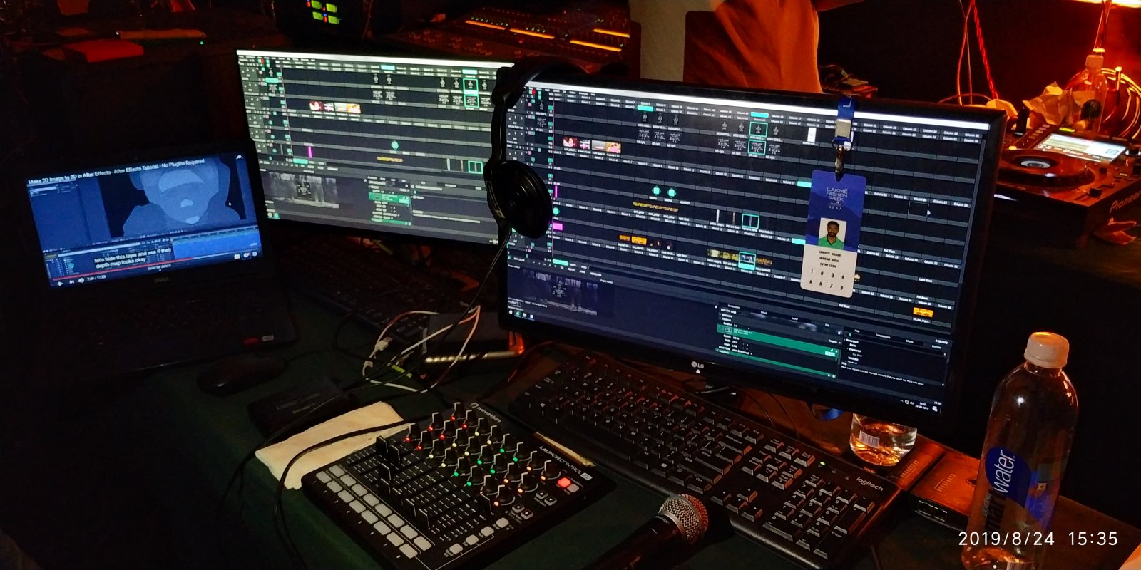

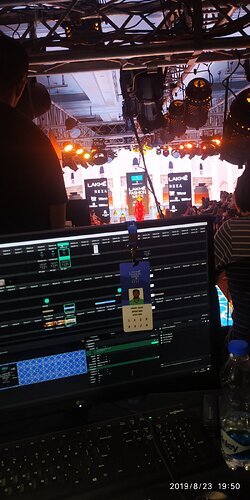

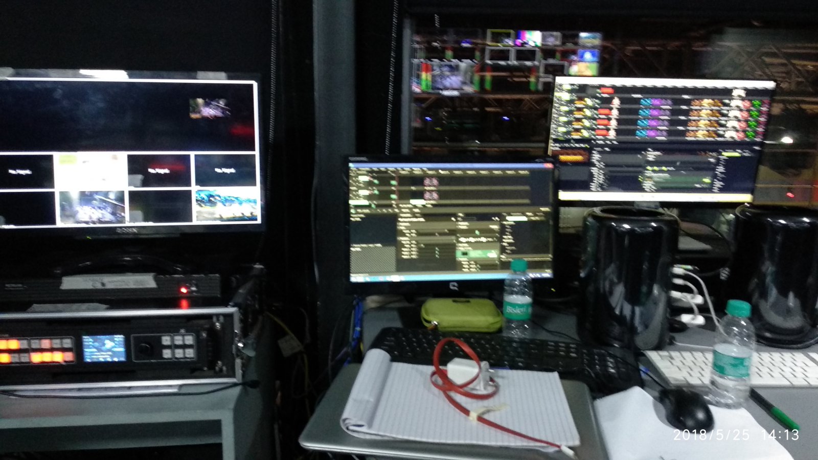

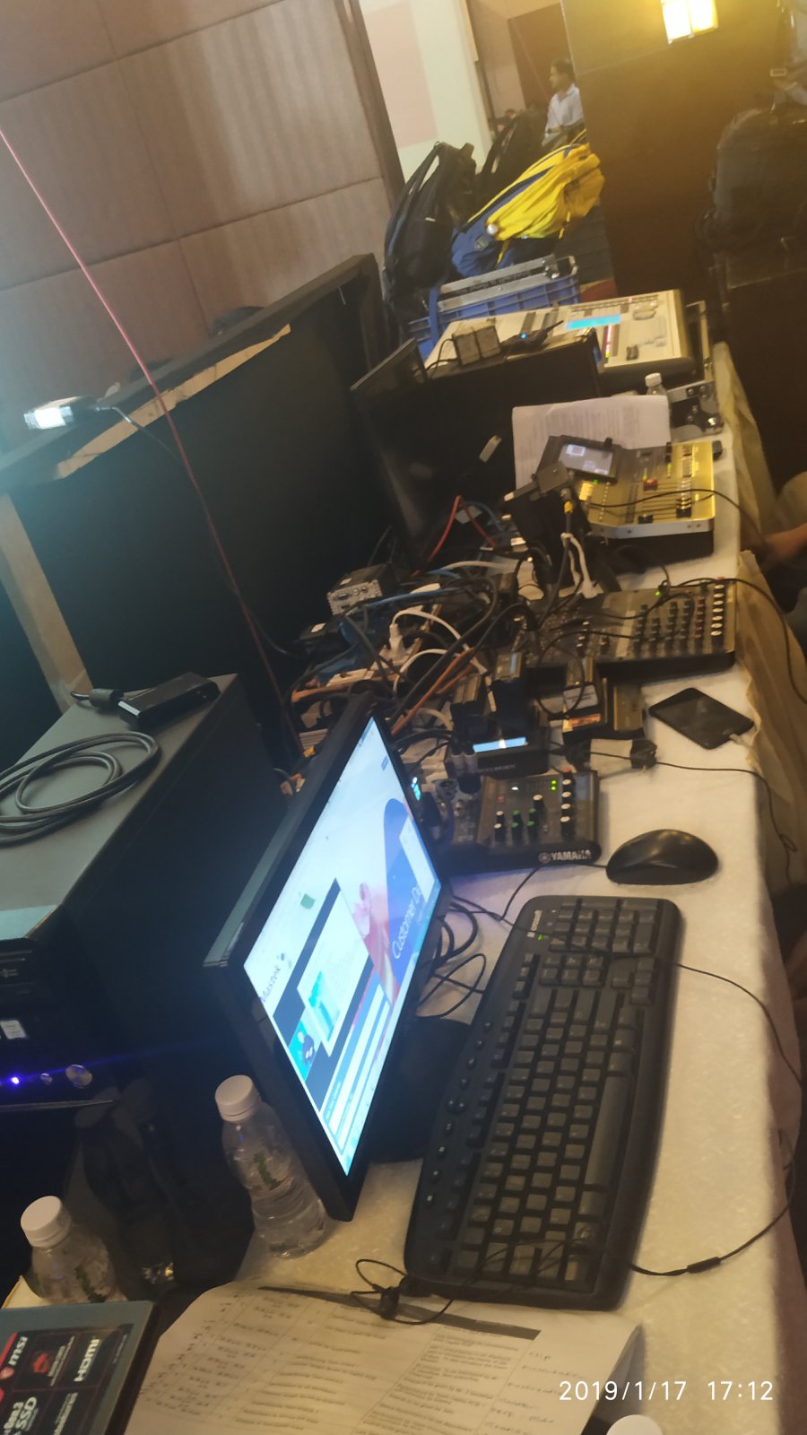

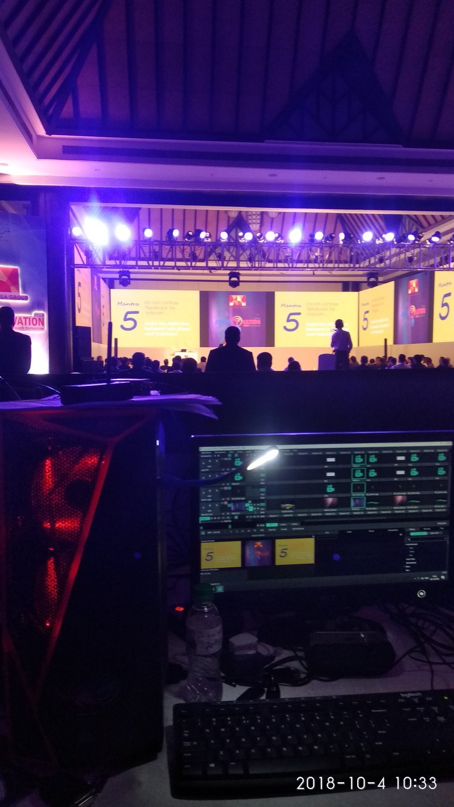

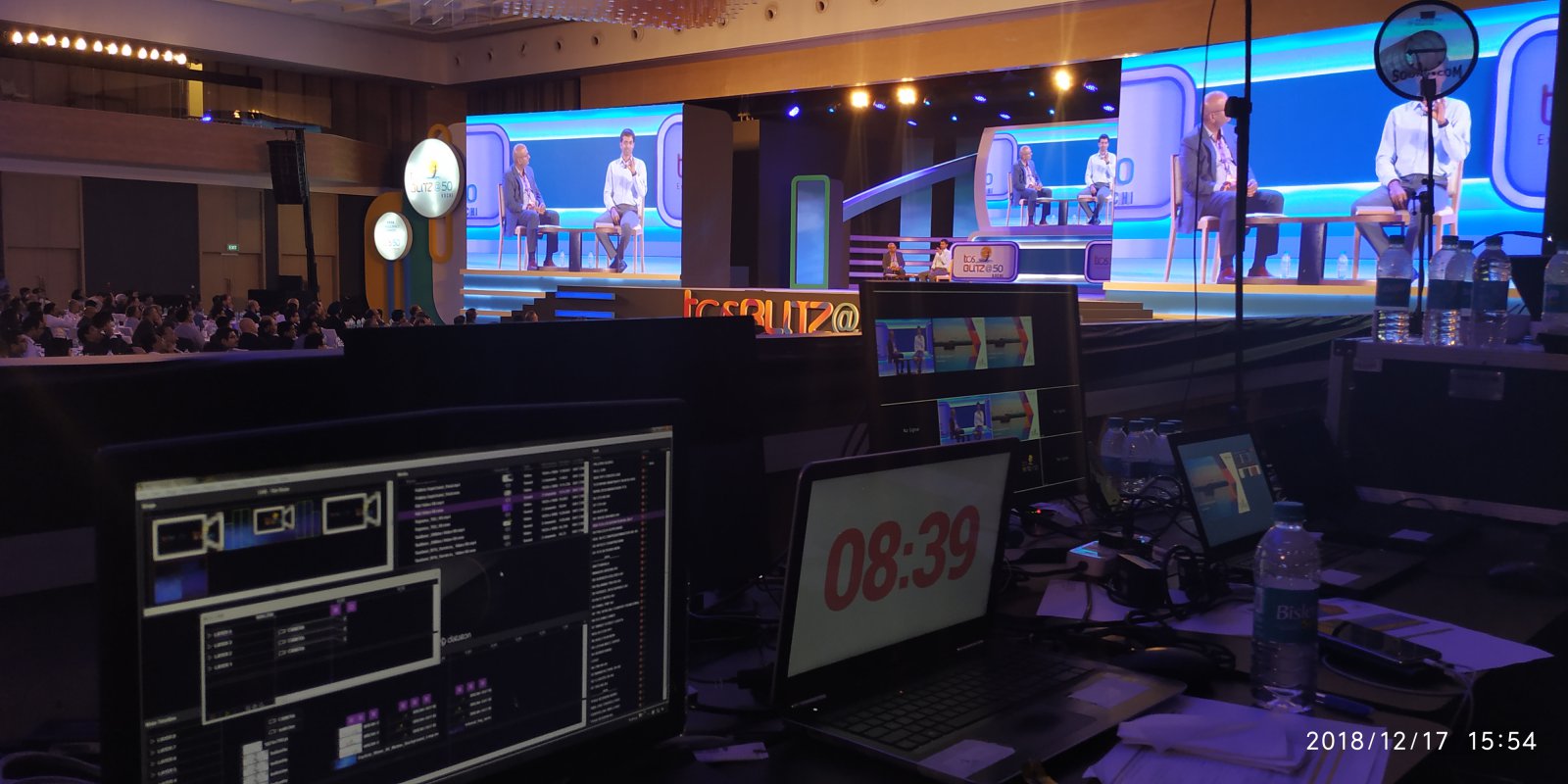

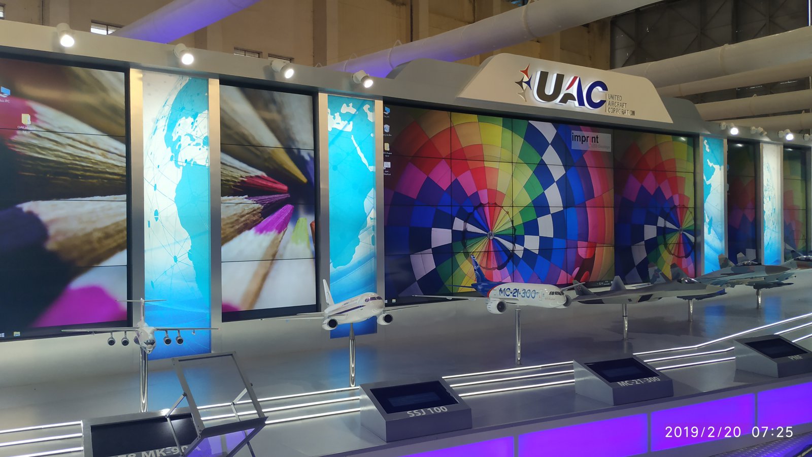

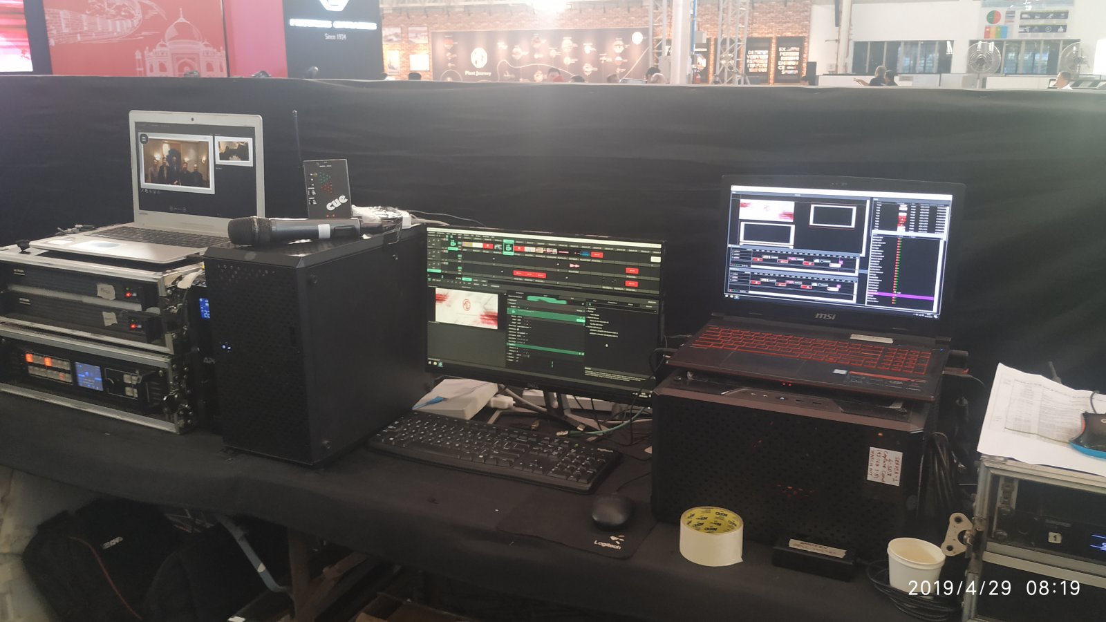

I run virtual shows and conferences and broadcast it over the internet.
Once outdoor events start, I will handle software’s such as Dataton Watchout and Resolume Arena which are essentially LED Mapping software’s.
Have attached pics as to what i do.
As you can see, there is often very less space to work with, and mostly we do shows back to back often in two different cities.

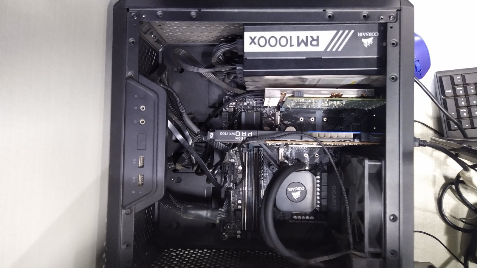

Have also added a pic of one of the systems on a CM Q300l which is not at all sturdy.
