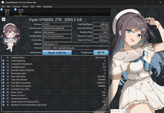

Update: I was able to make the drive work through an external enclosure, a quick chat with gpt and an old reply from @TechnologyHell helped me make my mind to buy an external enclosure as a last ditch effort. Plugged the drive using the enclosure today and the device didnt show up in explorer but showed up in windows diskpart functionality, then used windows partition manager to format the drive and reallocate all space on the drive as the device was unaccessible otherwise. After allocating space the drive showed up in crystaldisk with full health but with some media and data integrity error counts populated which werent there before. Just to clarify I had checked both diskpart and windows partition manager earlier too when the device was connected through nvme slot and was not working and it wasnt showing up in both of those. Unfortunately I couldnt salvage any data.
Good to know but I wouldn’t suggest to use this drive for anything important as of now. Use it as external drive/internal drive for non-important data & get another ssd in Prime day sale(amazon)/Goat sale(flipkart) starting tomorrow (for plus/prime members).
