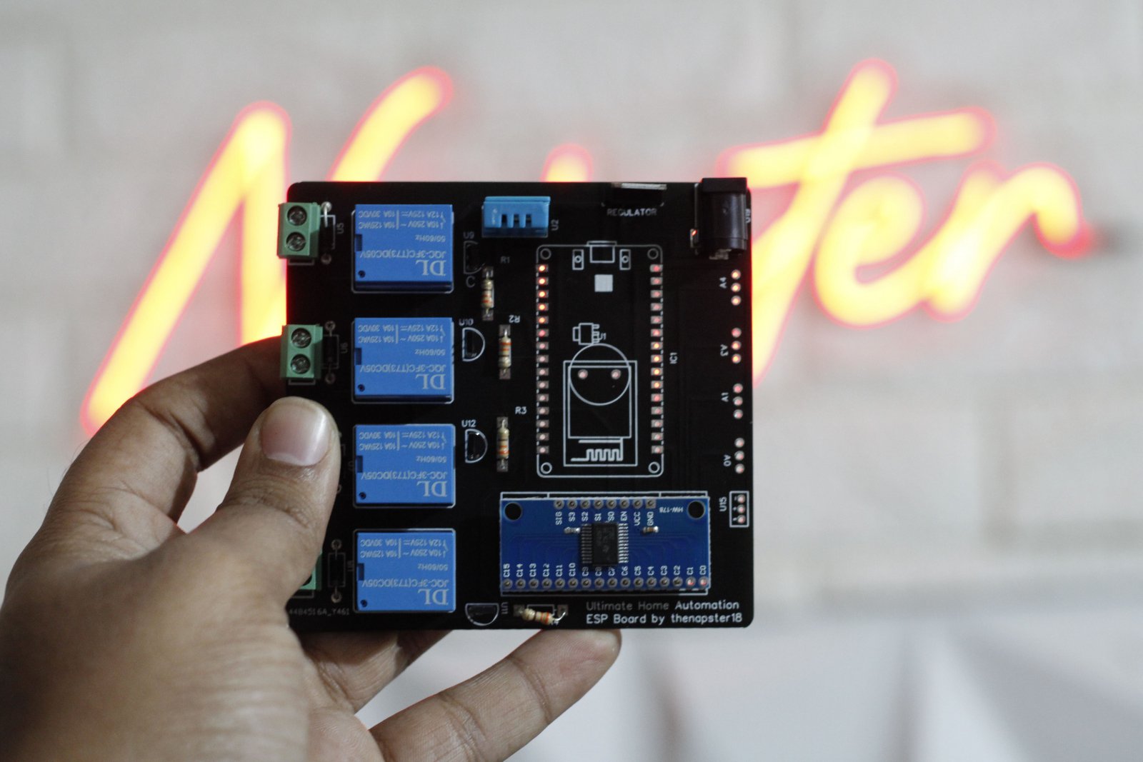

I just went ahead and ordered custom PCBs and components for 10 quantities of 4-channel modules which I am planning to retrofit. These will have NodeMCU ESP8266 with multiplexer boards for 4 switches each, temp-humidity sensor, motion sensor and two more sensors should I need them. All of that for around ₹8000 (total 40 switches and up to 40 digital / analog sensors).
Yeah it’s a lot of work, would take more than a month to deploy, but I am willing to learn along the way.

Almost there! Waiting for the ESP8266 NodeMCU 12e to arrive today.
PS: Hopefully I won’t start a fire!
do you think this will fit inside an electrical box? I don’t think it will be on any standard-size boxes other than those that are larger in size like an 8 x 8 modular box, a standard 4 modular box is only 6-inch x 3 inch
It does.
Barely. (it’s my new favorite word in the English vocabulary)

It went well. However, the PCB I designed, I forgot to account for switch state. (It does not consider physical switch state, just OR-s or AND-s the physical and PCB switch). So Either I can keep physical switches ON and turn on/off using app, or keep them in parallel and turn on using any, turn off using exact same.
Could not find any open-source PCB design with these considerations, and my house purchase had stalled (SBI loan process). I finally got possession last week, and plan to move in 2 months

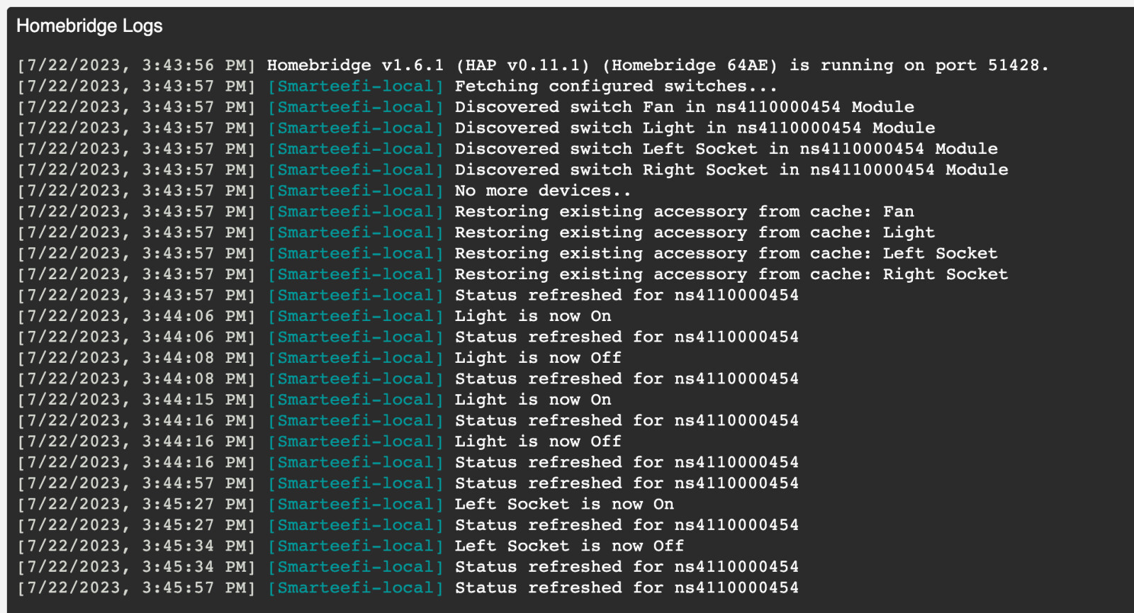

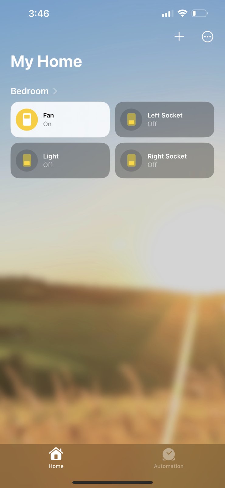

Update: Smarteefi devices do work with Homebridge. I am a happy man today!
Do all Smarteefi devices work out of the box? Thanks in advance!
Only tried with their 4 node retrofit switch. I am exclusively setting up my house with retrofit switches (of different node sizes) so should be good for me!
