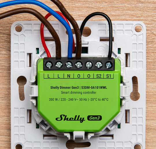

Guys I need a retrofit smart dimmer (wifi or matter) for a bunch of ceiling mounted leds that are way to bright.
Any recommendations of something that can be flashed with tasmota or something that plugs into home assistant?

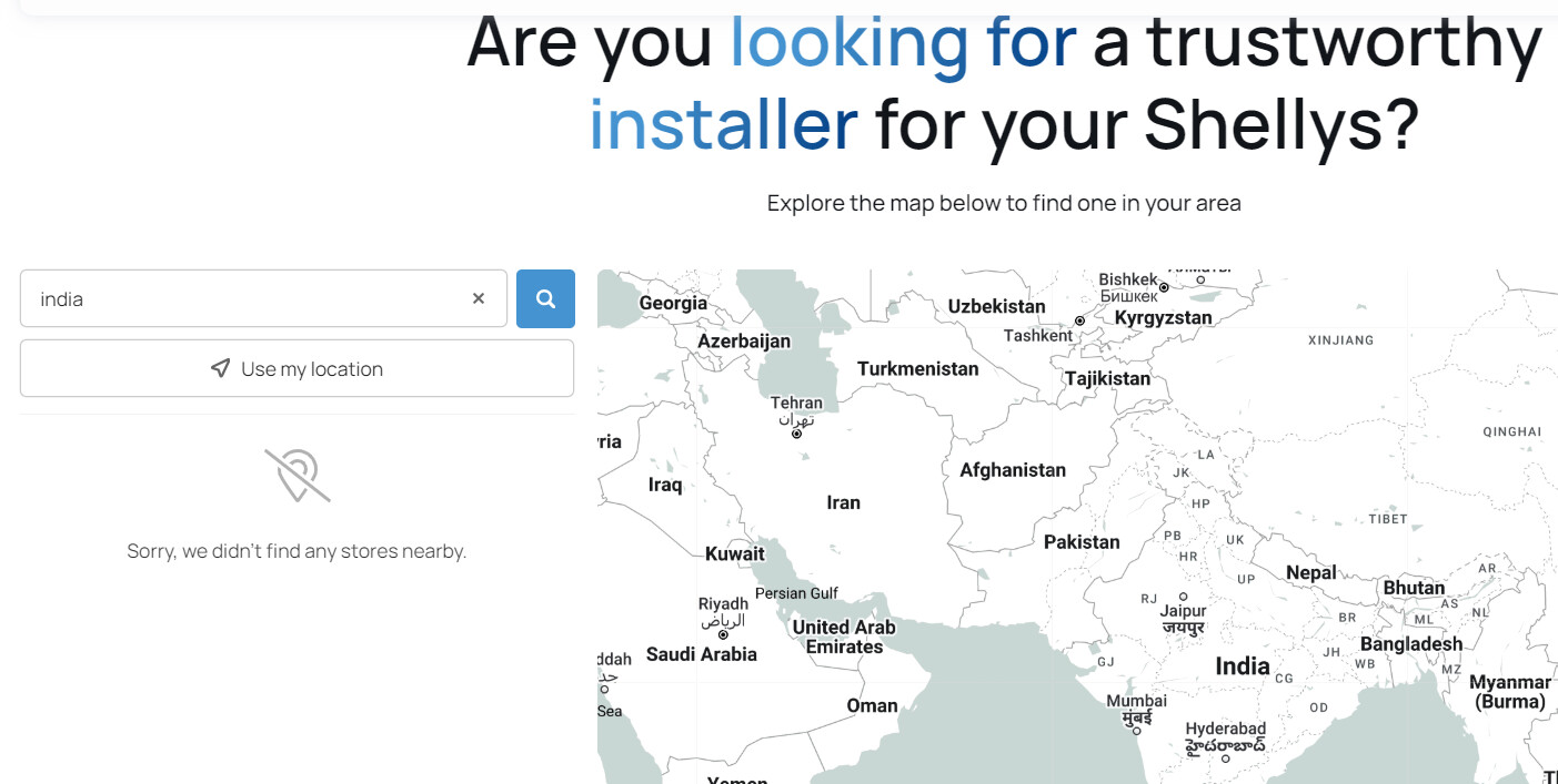

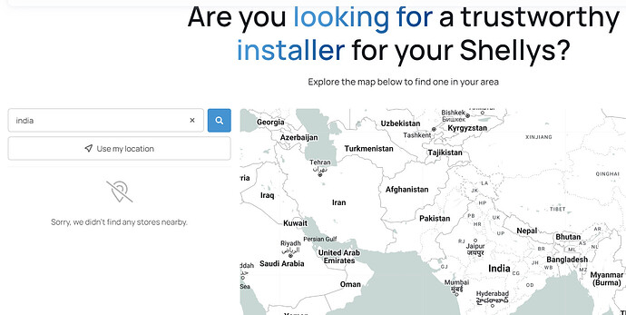

Shelly is also a good option to consider. Has smart relays, plug-n-play Wi-Fi switches
Any trusted seller to buy Shelly switches from (in India)?
Also can anyone please recommend good and cheap Sonoff seller in India?

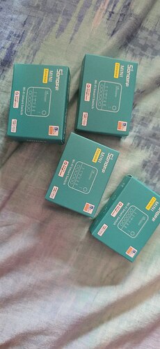

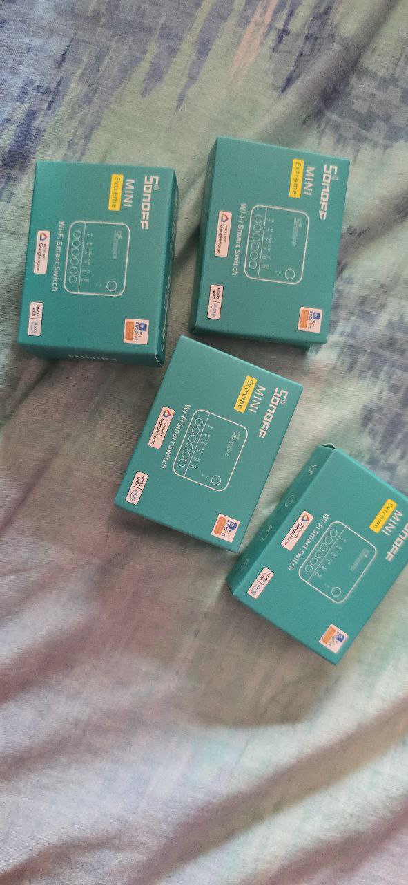

if you need sonoff switches contact sonoff directly on alibaba and ship to china sns address very cheap
each minir4 I got from there costed me about 900 .
