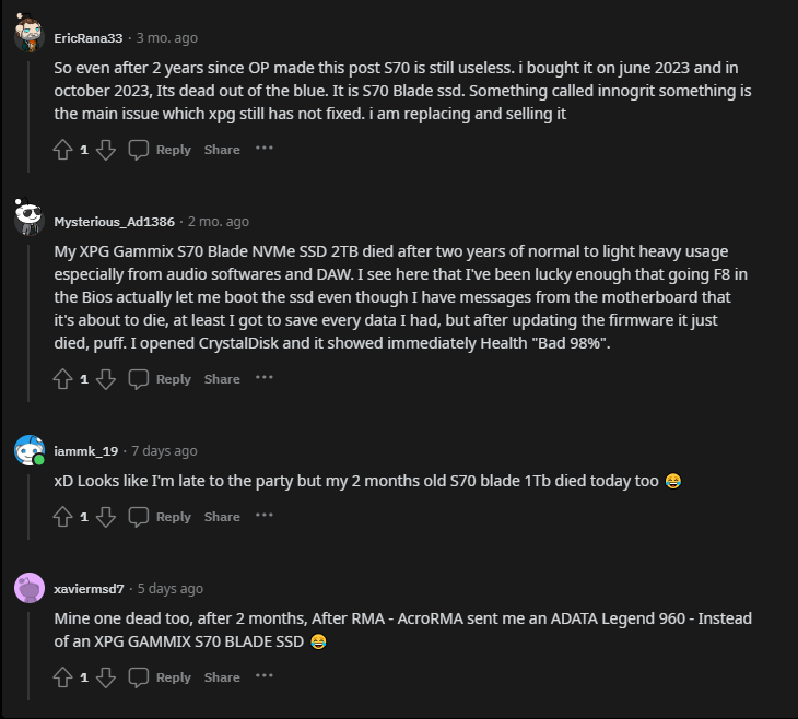

I haven’t bought any SSD yet - was still contemplating, but the Blade issues have been popping up recently as well. Refer the below latest ones on the [same page](’
https://www.reddit.com/r/buildapc/comments/rbgjm7/xpg_gammix_s70_blade_nvme_ssd_issue/
) I share above.

I have 2 of my known who are using an S70 blade without any issues for quite sometime now & one of them told me the firmware fixed the issue. So, i was under the impression that the issue was resolved. But it seems like it hasn’t and it’s still common.
Anyways I don’t see a reason to buy it and it’s always better to be safe. While SN770 is old, it’s still one of the best. WD black series have always been a very durable storage solution.
