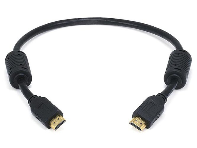

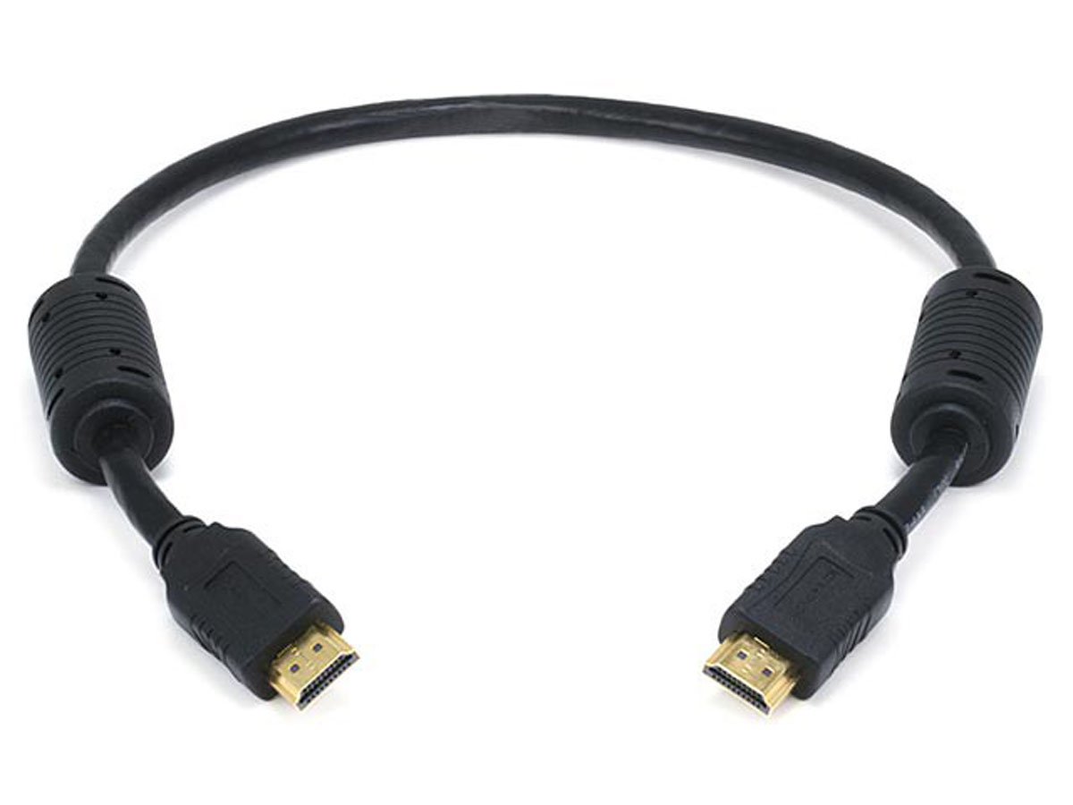

If you have an electrically noisy environment, the best HDMI cables for you are:
  1. as short as possible for your application
  2. not flat but round (twisted cables pick up less noise)
  3. shielded as per the manufacturers description
  4. with ferrite cores at one or both ends
Thanks @@salian .
Can you provide amazon link to purchase same.
HDMI called can be required anywhere, will go with good quality
Something like this, short, round and with ferrite cores, should be most noise-resistant.
Couldn’t find that exactly on amazon, but perhaps this or this?
