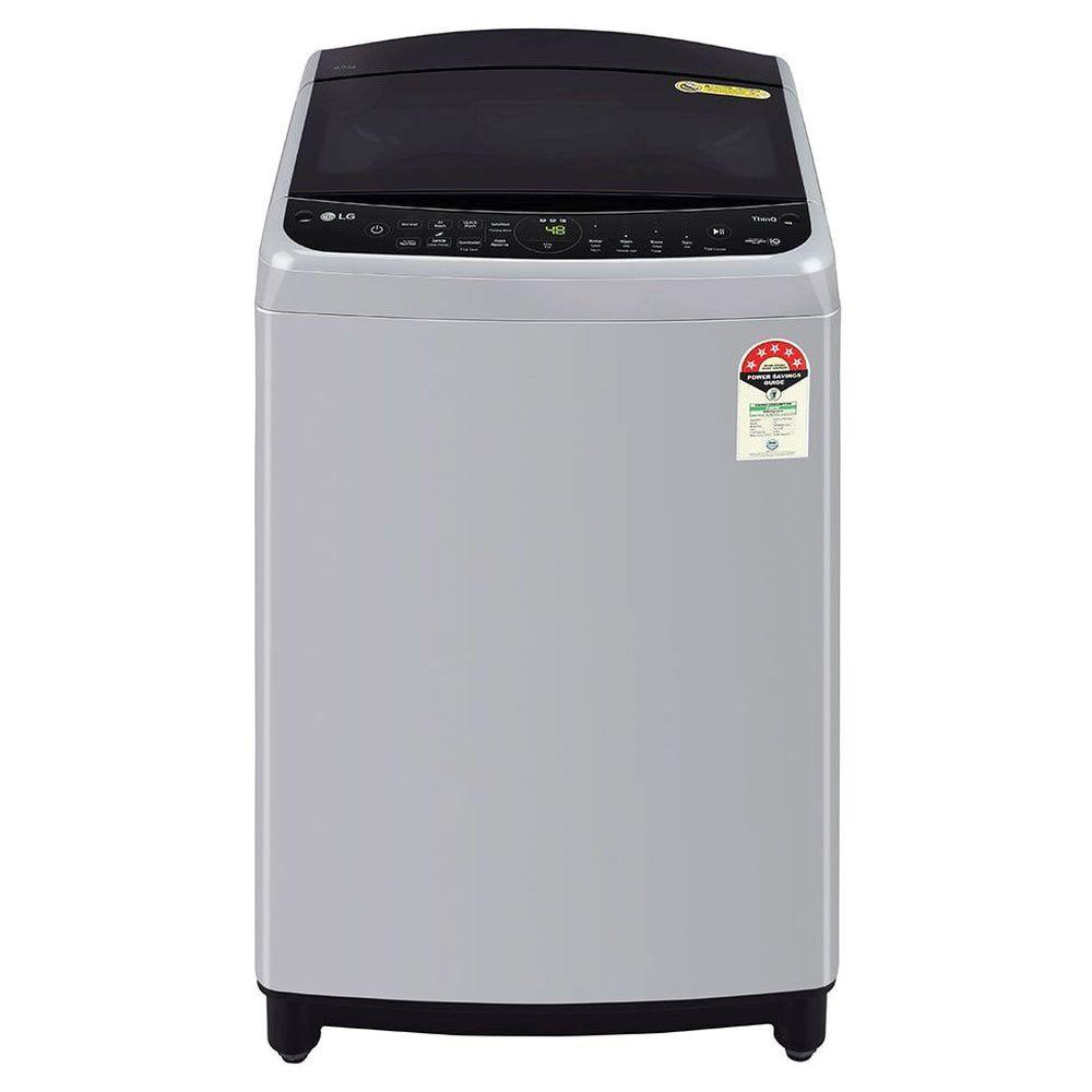

So another update. The Reliance guy who came to install the machine was very pushy about a particular model of stand for the machine ( similar to the one @@terence_fdes had linked to earlier) and he was adamant that only his way was the right way of doing things like attaching the inlet pipe to the tap like this
He’s screwed the screws tightly on the o ring of that connector. I told him the bottom part attached properly directly but this is way he did it. Plus he didn’t like the stand i already had and so he kept the machine directly on the ground and told me I’m on my own if i want to keep the machine on my stand. Pissed me off to no end.
Anyway, tried running the machine and it threw low water pressure error 1E. Had to go and get a circulation pump of Vguard and install it with the help of a plumber with the tank full. Smart guy closed the outlet pipe with a kitchen sponge from inside the tank and did his job very well in about 40 minutes. Took his help to put the washing machine on top of the old stand i had and the machine works properly now. Water pressure is about 3-4 bars probably.
Ran a tub clean program first to clean the machine off any factory oil etc. The guy who came to install was saying no need to clean the machine because it’s already clean and new.
Inside of the machine.
What I didn’t like is the controls on this thing. Don’t know how to operate it. It’s not user friendly.
Second thing - the drum is almost the same size of my previous 6.2kg samsung washing machine.
Old samsung 6.2kg machine
Diameter 43cm
Height 34cm
New LG 7.5kg machine
Diameter 44
Height 35
So almost same amount of water is used by the machine.
